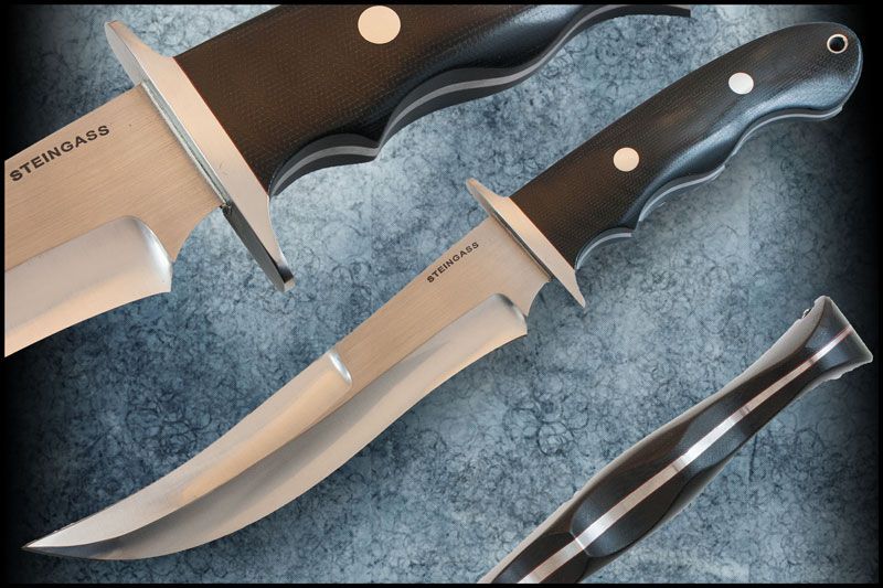

This is my prototype Persian Fighter in 1095/Micarta. I designed the blade from my Harpoon Fighter while the handle came from my Silent Hunter but with a more rounded butt to show the Persian influence. The clip is hollow ground to near zero then sharpened while the lower edge is hollow ground to .040" then 25 degree bevels. The upper part of the tip is slightly thicker for a robust tip. The hollow grinds are near mirror while the flats are 400 grit satin. Grinding this baby was a lot of fun for sure! This is a full tang construction fighter rather than a frame handle - in order to get the guard over the handle I used Bruce Bump's file guide to shape the ricasso while leaving extra metal to fill the oversize slot flush with the face of the guard.....it ends up being a hybrid bolster affair but with a solid guard. Future versions will be only offered in 3/16" CPM 3V for Field Grade and CPM 154 with pretty wood and mirror grinds. Thank you for viewing my work and comments are appreciated.
1095 Stock
HT to Rc 59-60 - double tempered
12 1/4" OAL
7 1/4" Double hollow ground blade
Reinforced upper tip
Black canvas micarta scales
Full tang construction
Pinned/soldered double guard
Red liners on tapered tang
416 Stainless furniture

I like everything about it but the 'harpoon'style notch in the spine of the blade.
Its beautiful.
Glad you like it - excellent feedback - I'm at a loss as what you have in mind as an alternative - any pictures or links? It's still a working design.

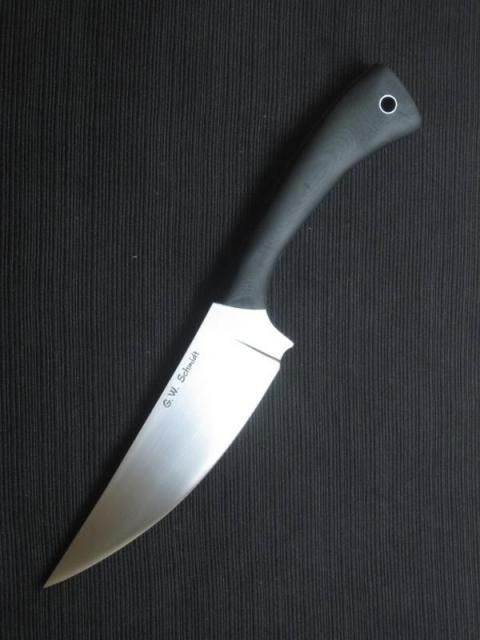

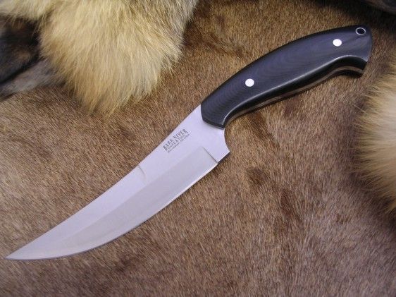

Its just when I hear Persian, I think of an austere design like those below - the spine a simple curving line, which for me is the essence of the Persian design.
I never would have thought 'harpoon' on a Persian prior to seeing your knife.
BUT
Thats purely a personal observation. The Harpoon style notch on a Persian took me by surprise. Its not what I usually would expect to see on a Persian styled knife.
But good knifemakers push the envelope and I can certainly see, that the design of your knife lends itself to the harpoon style.

It is interesting how people have different notions of what a word can describe. I've spent years in the middle east and frequented many of the largest outdoor bazaars in Egypt, Jordan, Saudi Arabia, Kuait, and Iraq. When I hear "Persian", I think the opposite of BladeScout. I picture knives that have so much curve as to be almost useless, adorned with intricate carved wood, flashy gems, and dangling charms and trinkets. Regardless of what the mind conjures up, I completely agree that you are making some very nice knives and I suspect, though I'm not a collector, I will probably come to own one.
