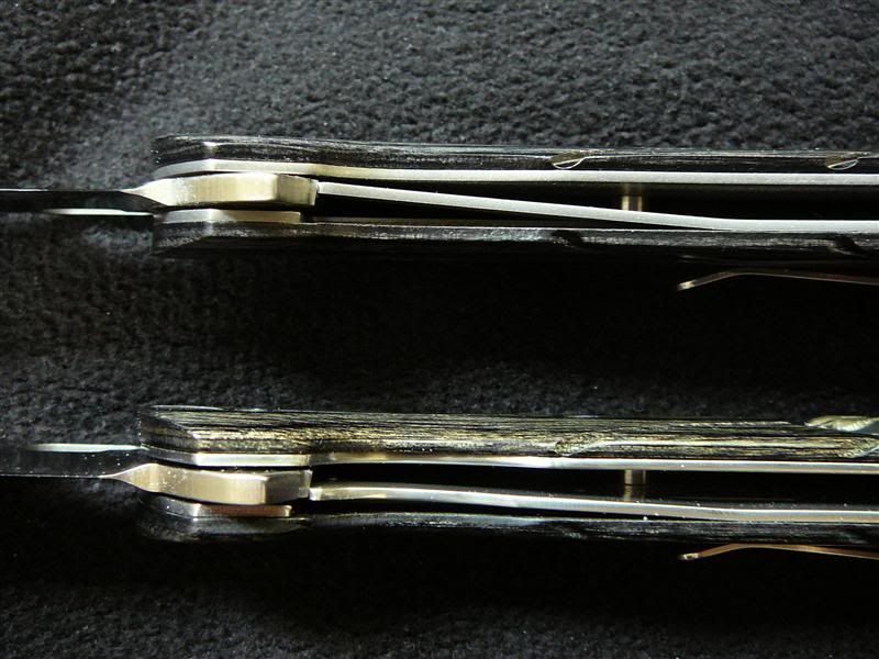

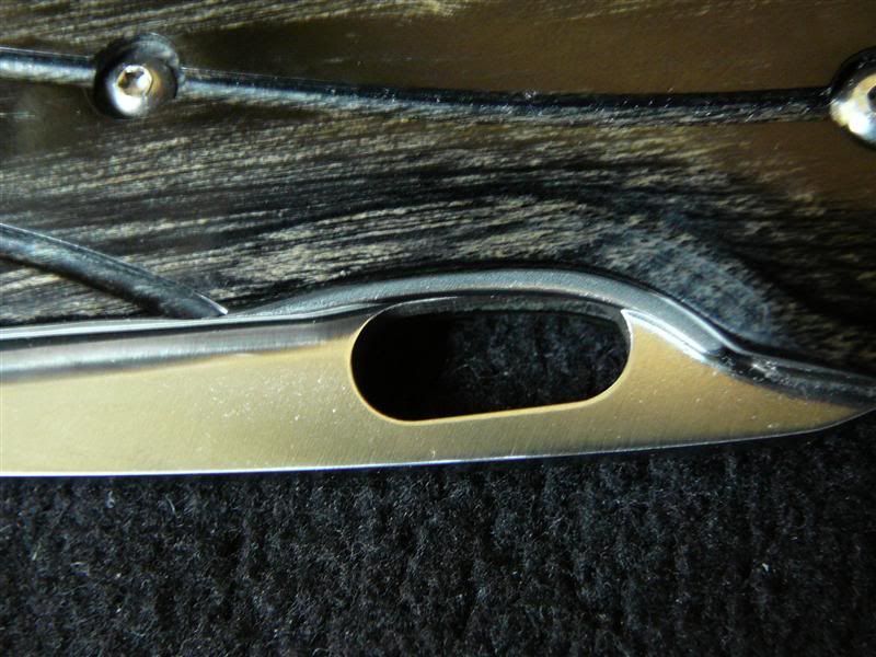

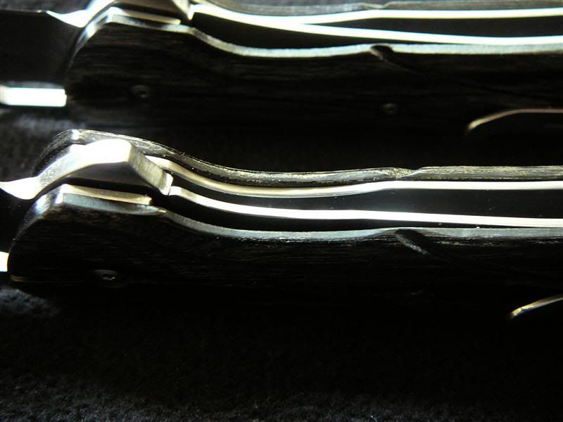

As far as the liner goes, I was afraid of the difficulty in disengaging the liner after grinding it down. So, I didn't grind the liner flush with the Dymondwood. Instead, I left just a little bit sticking out past the Dymondwood. To offset the fact that less of the linerlock is now available for the thumb to push on, I also ground down the opposite liner a bit so I could get more of my thumb into the gap between the liners. That little bit of grinding on the opposite non-locking liner made all the difference in ease of closure with the contoured ground linerlock. I will admit that the linerlock on my knife is not as easy to access as a stock Vantage, but it is not bad (I have small asian hands). It's actually more comfortable for me to close now, since the contoured linerlock matches the contour of my thumb perfectly and distributes pressure evenly all along my thumbpad.
Anyway, enough talk! Here's pictures comparing the stock liners to my liners:
You can see the recessed non-locking liner better in this picture:
This picture shows what I mean when I said I left a little of the liner sticking out past the Dymondwood scales:
Again, this mod was to customize my knife for me and is not necessarily for everyone. I myself am able to close the knife as easily as before, but by making less of the linerlock accessible I also made the knife harder to close for those with larger thumbs than mine. I will also admit that is also not aesthetically perfect (ie, both liners totally flush with the Dymondwood) nor is it functionally perfect (ie, ease of access for the liner lock) but it is a set of compromises that are the most appropriate for my tastes.

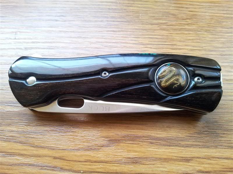

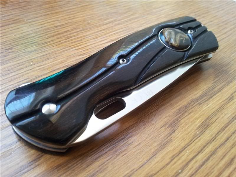

New update! I actually performed this modification about two months ago, but never bothered taking pictures until just now. The stock Dymondwood scales are supposed to be colored Charcoal Silverwood. However, the silver parts on the front scale of my EDC Vantage started to look kind of yellow-y, and sanding the top layer off didn't remove the yellowing. The back scale retained its original Charcoal Silverwood coloring, resulting in what looked like two mismatched scales. I always wondered about whether I could dye the Dymondwood, since it's resin impregnated wood. So I disassembled my Vantage, picked up a pack of black Rit dye, and soaked the scales for about an hour. The scales came out pure black, but some of the fibers in the wood expanded, resulting in a very uneven surface finish. I sanded down and polished the scales to smooth them out again, removing the top layer of pure black to reveal some of the grain again.
Here are the results:
I like black, so the new darkened Dymondwood scales suit me fine. I will admit that the Charcoal Silverwood had some charm in its high contrast black-and-silver scheme though.
I know some Vantage owners have mentioned dyeing or otherwise customizing their scales, so hopefully this share will encourage you to go out and mess with your knives!
Standard22, my knife has Dymondwood scales, which is what the Avid uses. Technically my scales came from a Dymondwood Select model, but they are the same material. So my knife is essentially an example of what dyed Avid scales would look like.

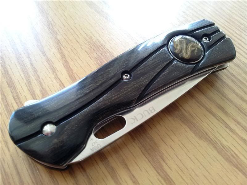

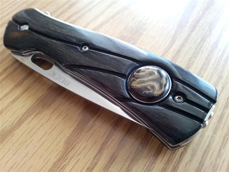

I actually recently discovered, while polishing my knife handles, that the dye does not penetrate far into the Dymondwood. Light sanding will remove the dyed layer and expose the original coloring underneath. So I ended up redyeing my scales black, then looking into methods to coat Dymondwood so I could polish the scales without removing the dyed layer. I ended up using superglue, since it can apparently be used for filling in cracks in Dymondwood and as a wood finish. Pics of my current scales (black-dyed Dymondwood with a superglue topcoat):
The superglue layer took some effort, but I think it was worth it. I'm really liking the deep glossy finish (which, btw, was hard to photograph). Sure, it isn't super-grippy, but it isn't super slippery either. It's still about as grippy as the stock Avid Dymondwood scales.

As to the superglue finish, I found this thread and followed the tutorial. I squirted a line of superglue onto the wood scales, then brushed it out with my finger, making sure to keep my finger moving so I didn't glue myself to the scale (admittedly, I was nervous the first time I tried this, but the guy who posted the tutorial used his fingers so what the hey). The hard part was not letting the scales anywhere near moisture, ie not blowing on them to try to get the glue to dry faster and not touching the surface again until I was sure it was fully dried, otherwise the superglue would form a white haze that could only be removed by fully sanding off the last superglue layer. I put on 2 layers of superglue, hit it lightly with some 120 grit sandpaper to smooth it out a little, then cleaned the scales and put on another 2 layers of superglue. There is no real way to apply the glue smoothly, so after the last layer was applied it was time to go to sandpaper. I progressed up to 2000 grit sandpaper then buffed the superglue finish with some Blue Magic polish on some old denim.

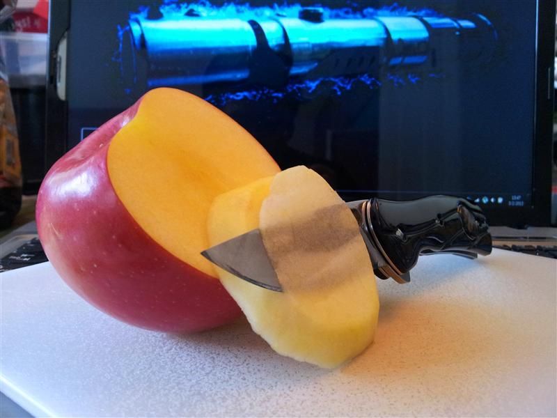

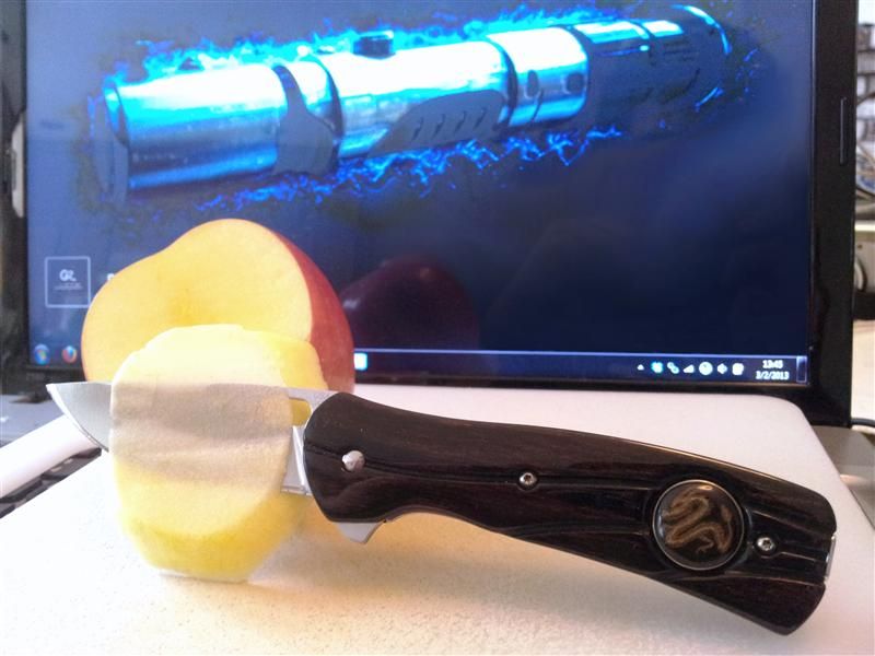

Just for kicks, while I was eating an apple recently I tried slicing it as thin as I could. I got a slice thin enough to read through, which is probably nothing new to knife knuts but was a first for me and incredibly fun to do. I tried taking a picture mid-slice, but each time I tried setting up the pose I wanted, the weight of the knife would finish the cut. I ended up keeping the pose and using a thicker slice so the knife wouldn't just fall right through for the pictures:
