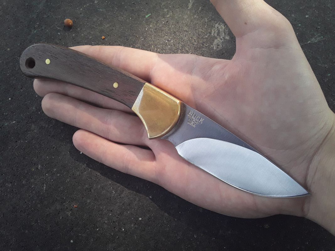

I thought it would be fun/interesting to see some personally customized Bucks...I'm certainly not an expert but I enjoy fiddling around...post some pics of your work.
Very nice job AJR! I especially like the textured bolsters. You just inspired me to work on my new Jumbo trapper when it gets here. I was going for bone handles to have a better grip but ended up with smooth Colobolo..
Thank you. The finger groove was made with a drum sander chucked in a drill press, the jimping with a hand checkering file.

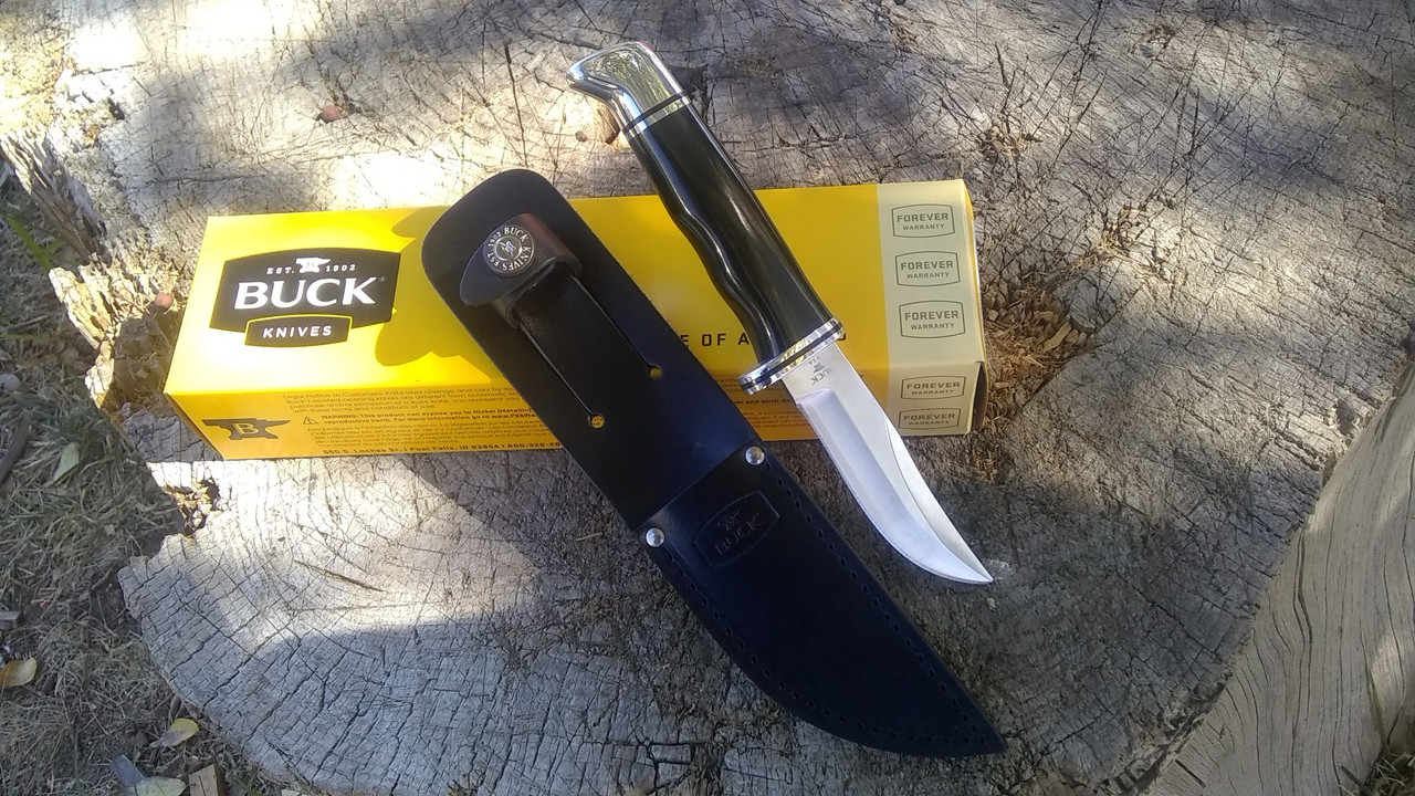

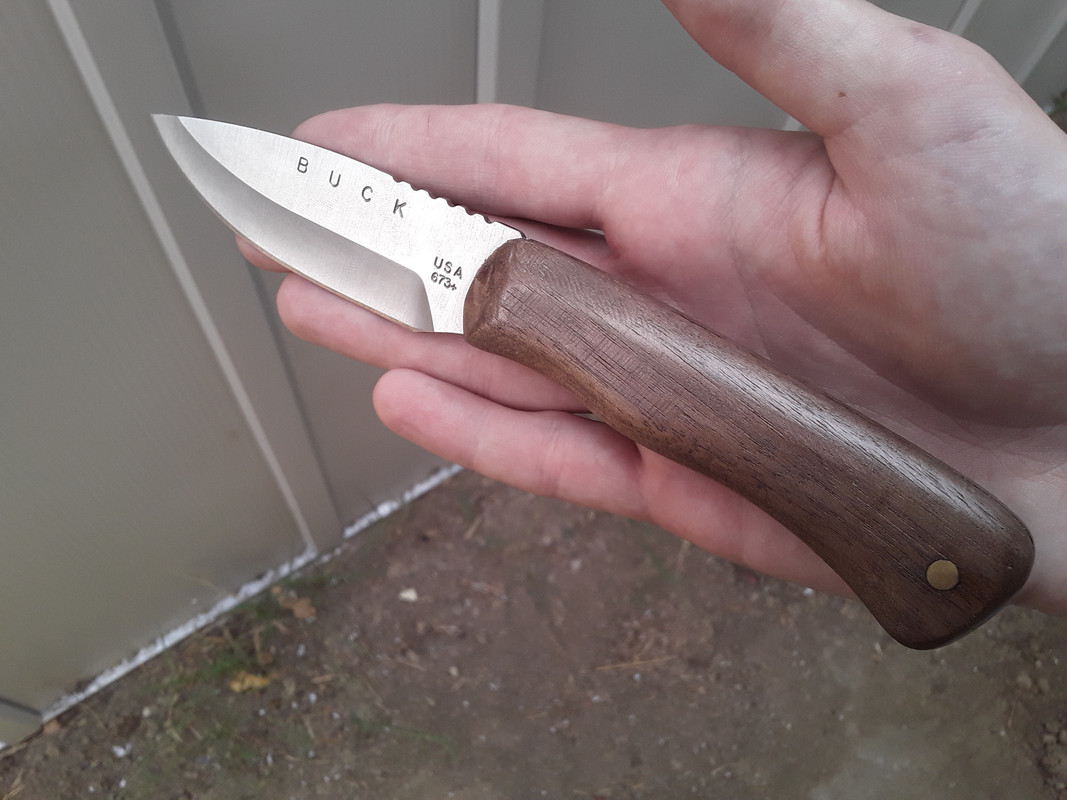

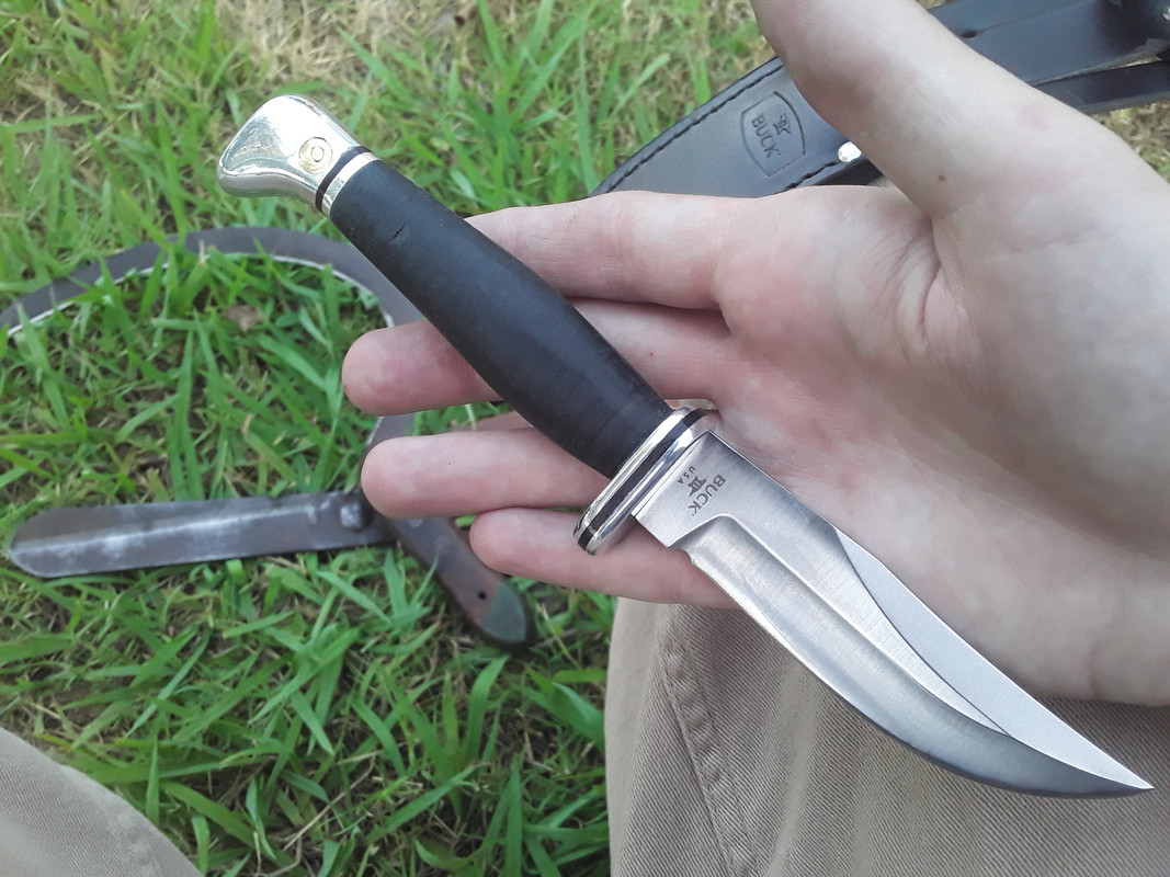

I have a lot of time invested in this one. It was as rough as a corduroy road when I got it, so I got rid of the coarse vertical lines, now it has fine horizontal lines. Lol. I stopped short of full polish, but at least it’s smooth.
It also had a wicked recurve. Which I can’t tolerate.
I chamfered the thong hole so I could have a lanyard but not have the knot digging into my palm. Then a small single finger groove.
I mirror polished the blade of this B&C knife.
