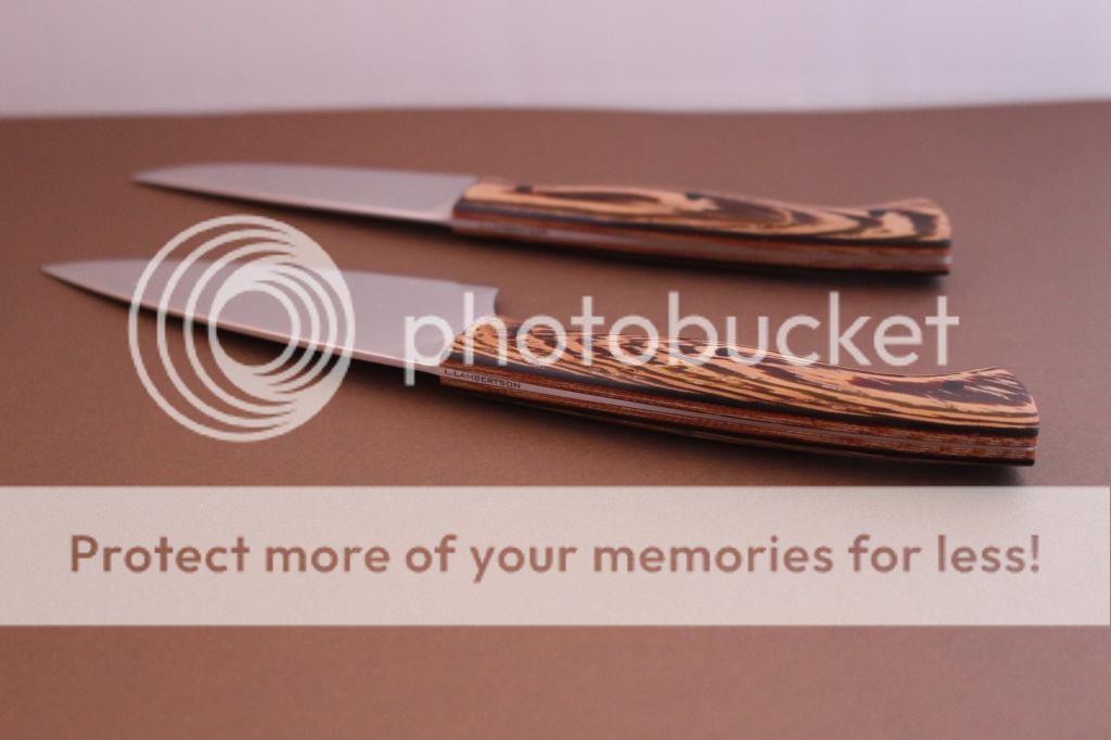

I made a few of these sets for Christmas presents and made one extra set to put up for sale on BF.
So here they are, hope you enjoy them!
Specs:
Both double cryo'ed and triple tempered to a tested 62 hrc.
Stabilized African Wenge scales over black G10 and dark brown canvas Micarta with carbon fiber pins.
Satin scotch brite work finish.
Paring knife is full tang 1/16" AEB-L, and is 7.2" tip to butt with 3.1" of usable cutting edge. Ground to a very thin tip for all the fine work that parers are good for.
Petty is .09" AEB-L with a tang that's been tapered down to .025" leaving the neutral balance point at the front finger. 8.3" over all length with 4" usable cutting edge.
I'm selling these as a set for SOLD$ shipped and insured.
Thanks for looking!
