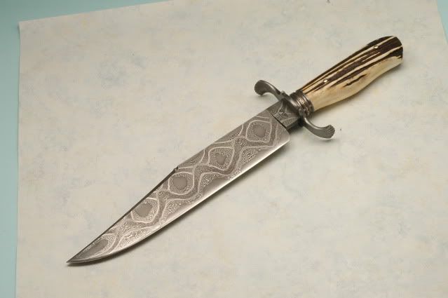

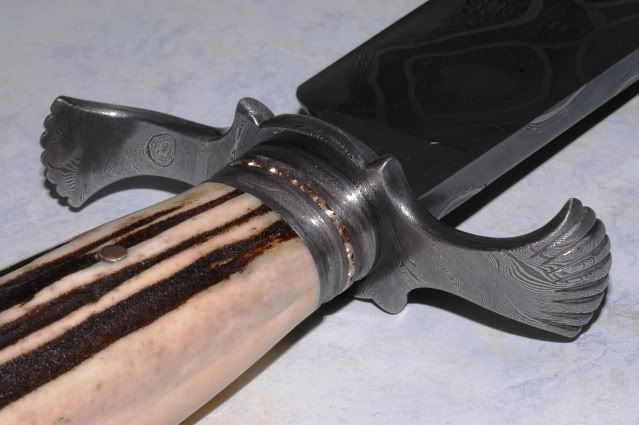

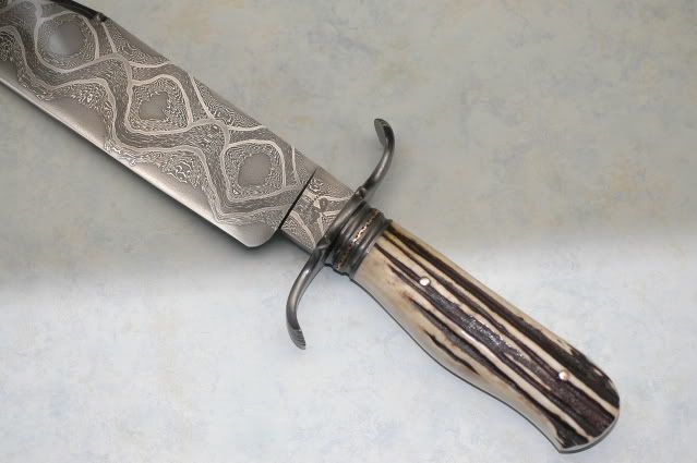

This years piece is damascus, silicon bronze and sambar stag. The blade is 10 inches and the OAL is 15 inches.
The damascus is supposed to depict the winding Mississippi bordered by sand bars (15n20). The cut-offs represent oxbow lakes which form islands. Couldn't get an alligator in there but one of those sand bars might be the Vidalia Sandbar. You be the judge.
It's a fairly simple Turkish Ribbon damascus. I'm not a chess player or a fighter pilot. And rightly so. Those guys have to think many moves and many miles ahead. Same goes for damascus. Guys like Tom Ferry are truly "Top Guns" when it comes to predicting the outcome of the patterns a good ways down the road. I never possessed that ability.....

That's one worthy of the Big River. The ribbon look great, and not so simple at all. Love the "san mai' effect. How'd he do that?

That's a very nice Bowie to say the least. Love the guard and damascus a lot.

There is something to admire on every square inch of this bowie Terry. Beautiful knife Terry.
Really a beautiful Bowie Terry. Don't know what I like the most, that beautiful damascus or the outstanding guard/spacer treatment.

John, the "san mai" effect comes from (I hate this term) "dead areas" in the damascus. Areas that were not boldly patterned. In this case, it's 1084 and 1095 W patterns. If you look closely you can see the design. It's just that they are not very contrasting when used side by side. It gave me the "islands."

Terry, you can call it whatever you like, but to me it's always going to be "The Massasaugua". The pattern on that damascus just reminds me of that snake. Beautiful knife and the guard is just beautiful.
