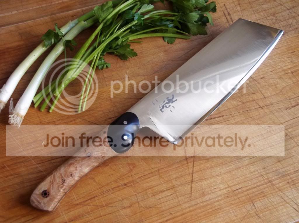

I've attached a few photos of my third knife so you'll have some idea of my skill level.

Love those handles!!

Im thinking of the Pheer myself as ive also heard good things about this grinder. I just wanted to say that is one fine looking blade youve made there !
