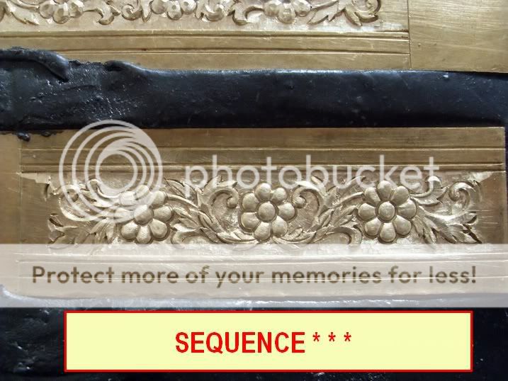

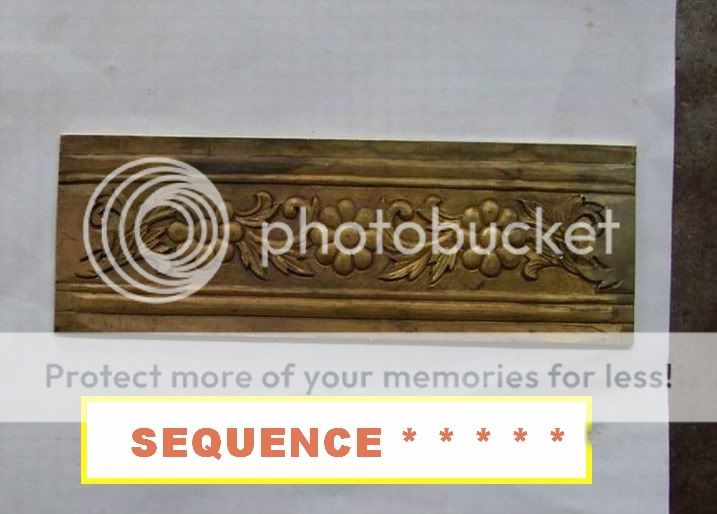

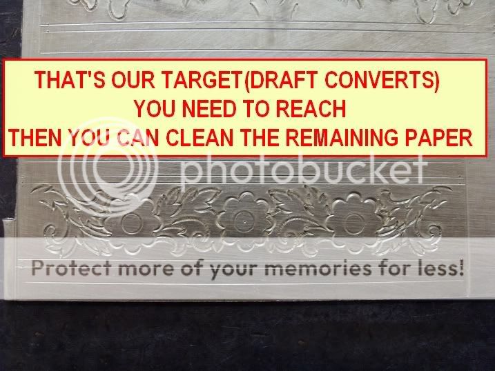

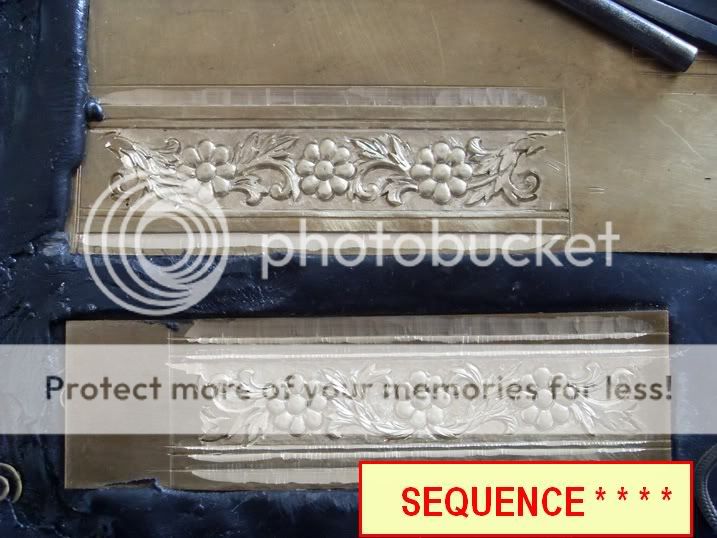

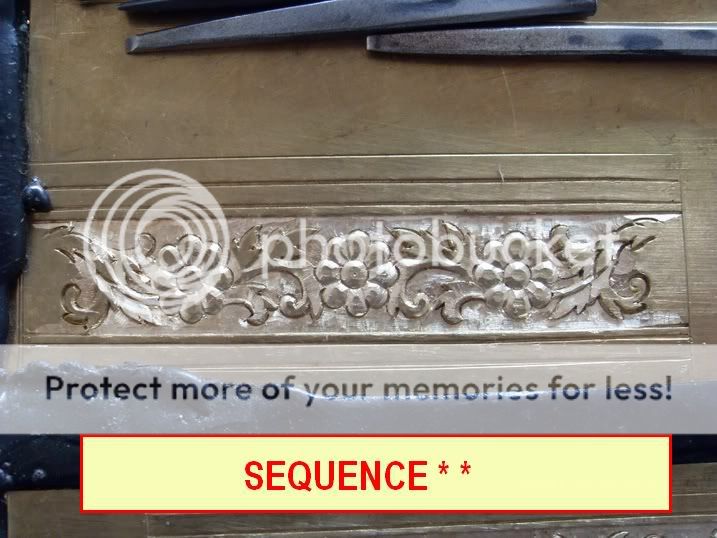

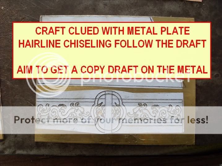

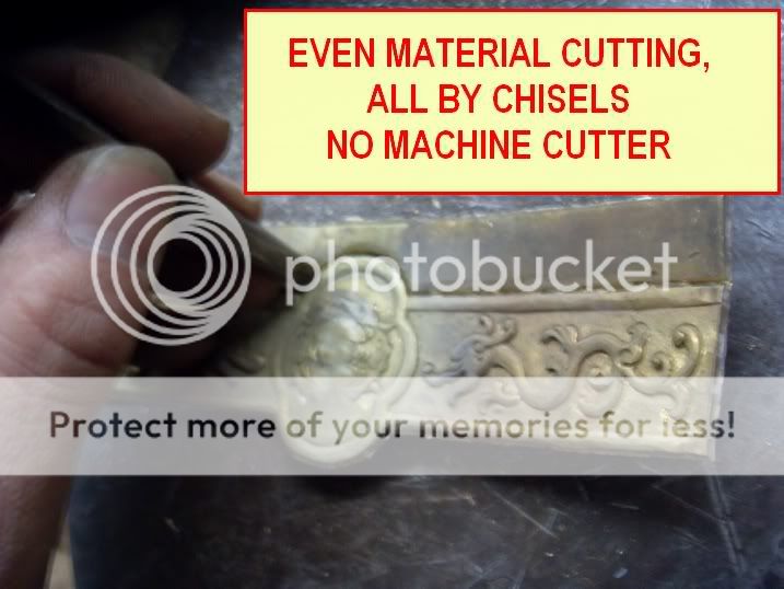

Here is a typical sequence of the traditional metal carving, or we say metal chasing & repousse.
I think this is more easy for some lover, learner to follow the simple pattern.

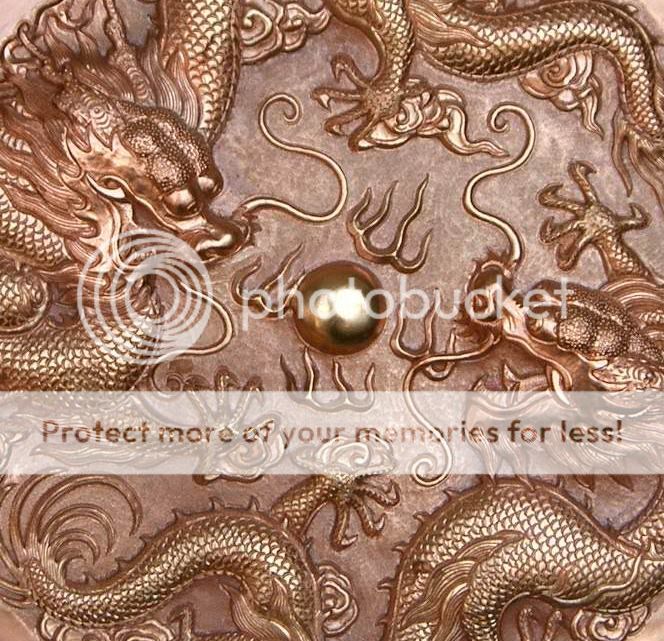

Your carving looks very good, but I was wondering what do you mean by "chinese traditional metal carving method"? What is the difference between "western", if there is something like that, and Chinese methods?
As I can see from the photos, you are also using hammer and chisel. But so does Phil for all of his carving/sculpting work...

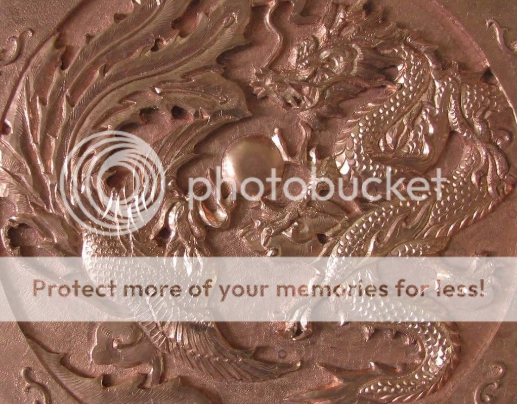

one more chasing and repousse work
Repoussé means you are hamering the metal out from the back to gain more depth. if this is what you are doing a picture of the back side would help people to understand.
i have not seen chasing and Repoussé combined with metal carving, very interesting.
your work is beautiful thank you for sharing.:thumbup:
great work engraveing is a beautifull form of art I tryed for three years and ended up giveing up no talent.
Thanks Mark,
I got it, here is another link, you can see the chasing and repousse combined with metal carving.
http://www.bladeforums.com/forums/showthread.php?t=694883&page=2
That's usual way for us.
