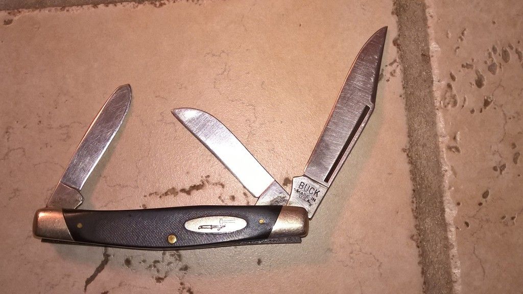

I have a box of knives I'm going to send in for a Spa treatment and before I do, I'm hoping to see some before/after photos of some old Camillus and Shade 303s that you might have sent in. I'm sending a couple of old Camillus made 303s, a 2-dot 112, no-dot 110, a 619, and perhaps some others.
The 303s I'm sending have full blades and haven't been oversharpened. They have light use marks on the blades and bolsters as well as some light rust on the liners. I'm hoping to make them new(ish) again. Here's one, for example.
If you have any 303 before/after, or just after photos I'd love to see them.

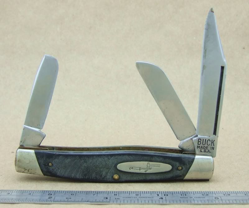

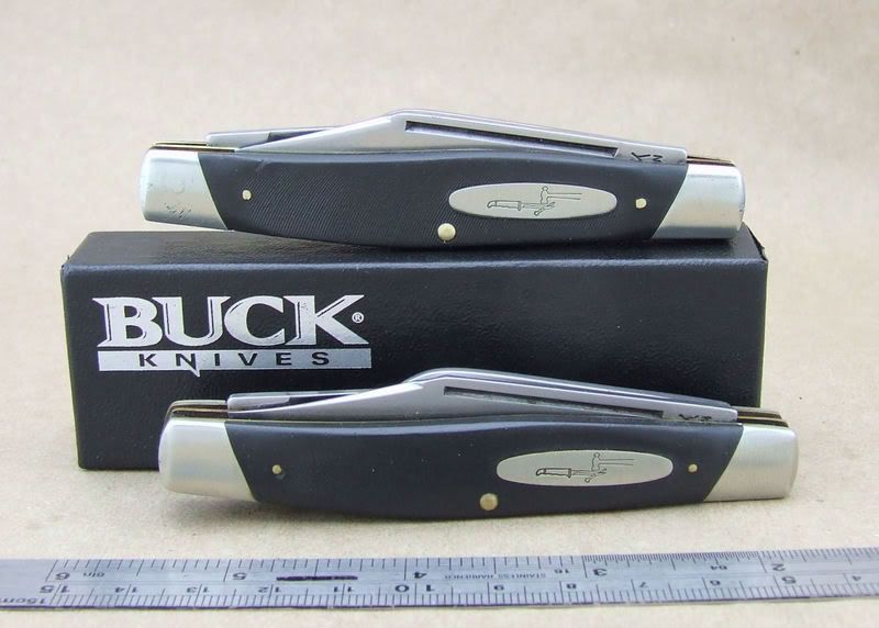

Desoto, may have the best idea. I will add I think you send Joe Houser a email about what could be expected for 300 workover. JHouser@buckknives.com , reply will be slow. I scratched my head and could not think of any particular photo of a before and after me working on one. My process is just a clean and polish process. I dig in blade well with broken toothpick for lint and then I wash with hot water and dish soap with old toothbrush getting in grooves of sawcuts and then hairdryer blow dry, then WD-40 or Mineral oil soak. Then overnight drip dry. Then carefully polish blade with Flitz or Mother's wheel polish, very light polish following grinding marks. Then work on bolsters, ends and back with a Worksharp extra fine polishing belt or even a dremel loose cloth wheel and polishing paste. Be careful to not work on sawcuts. Polish up bolsters, clean up any grit and couple of drops of oil. Don' t polish the late 80's shields that say BUCK in ink.

I remember a couple of photos
Here is old one in the raw.
Here it is after mineral oil soak and work over.
I am pretty sure I did a forum post on this process a long while ago. From your photo I would question Joe on how well the factory could restore a blade back to factory polish.

The one you worked over in your photos looks terrific 300. That's about what I would expect. My concern doing them myself would be that unnatural look you describe which is what I hope to avoid. I'll collect my thoughts and email Joe. I'm in no hurry as I've had some of these for years anyway.
