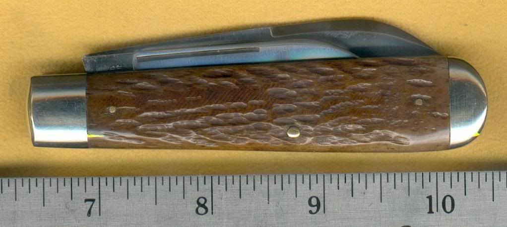

Case produced a lot of jack patterns with the pen blade on the pile side. The 6220 peanut and the 6232 Texas Jack being a couple more common ones. Ease of manufacture is certainly one reason - with the pen on the mark side, you have to make sure that you can properly access the main blade nick (and indeed, most old jacks have a cut swedge on the back side of the pen to give just that bit of extra room to access the main blade nick). Also, for many jack patterns, it's still just plain awkward to access the main blade nick over the pen, regardless of long pulls and swedging -- so Case may have been balancing ease of access (and freedom of nail nick size and placement) of the main blade against a bit more awkward access to the pen (plus, lefties had to love them). Case often dropped the pen down low and used a nail ease notch on many of their patterns with a pile side pen (like both of the above patterns) -- so they saved work in one way but added it in another. (I love patterns with nail ease notches - the notch actually works as an index so I don't have to look or feel around when accessing the pen nick. It's also nice for pen blades since it means the pen is lower in the liners (or can be made so), so it's much less likely to have the point come up over the liners as the pen is sharpened down over time.)
To me, the ultimate combination for a jack is to have both nicks on the mark side and to have the pen dropped down to be accessed by a nail ease notch - getting it out of the way of the main blade nick and making it "disappear" into the handle when using the main blade (plus it's a great detail). Here are a few very nice patterns that do this:

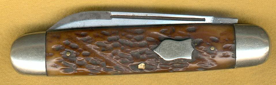

One of my favorite patterns - an equal end jack with both an EZOpen notch and a nail ease notch - first is a Schrade Cut Co, second is a Shapleigh Diamond Edge (made by Schrade Cut Co no doubt):

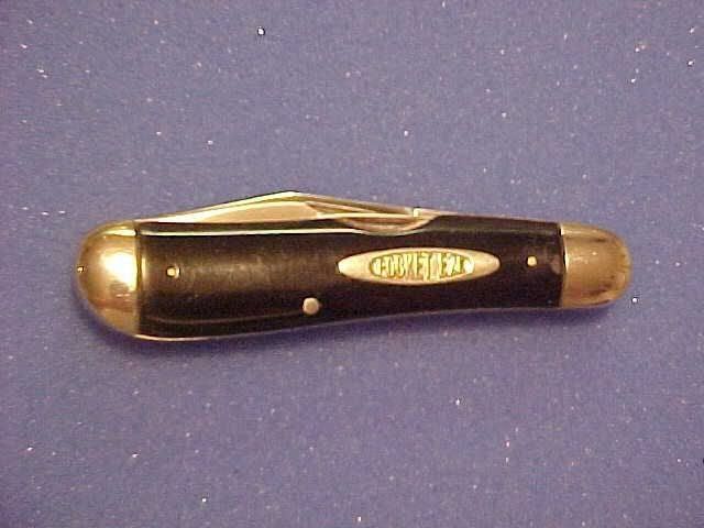

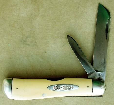

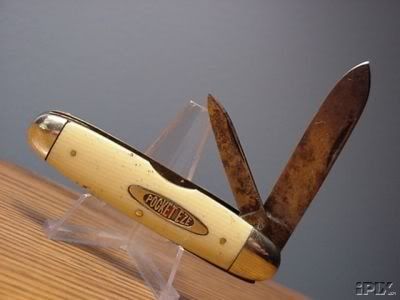

Now a couple of old Robeson script ShurEdge PocketEze patterns (note that one of the primary design characteristics of the old PocketEze patterns was fully sunk joints). First a couple of reverse doglegs, then an equal end jack:

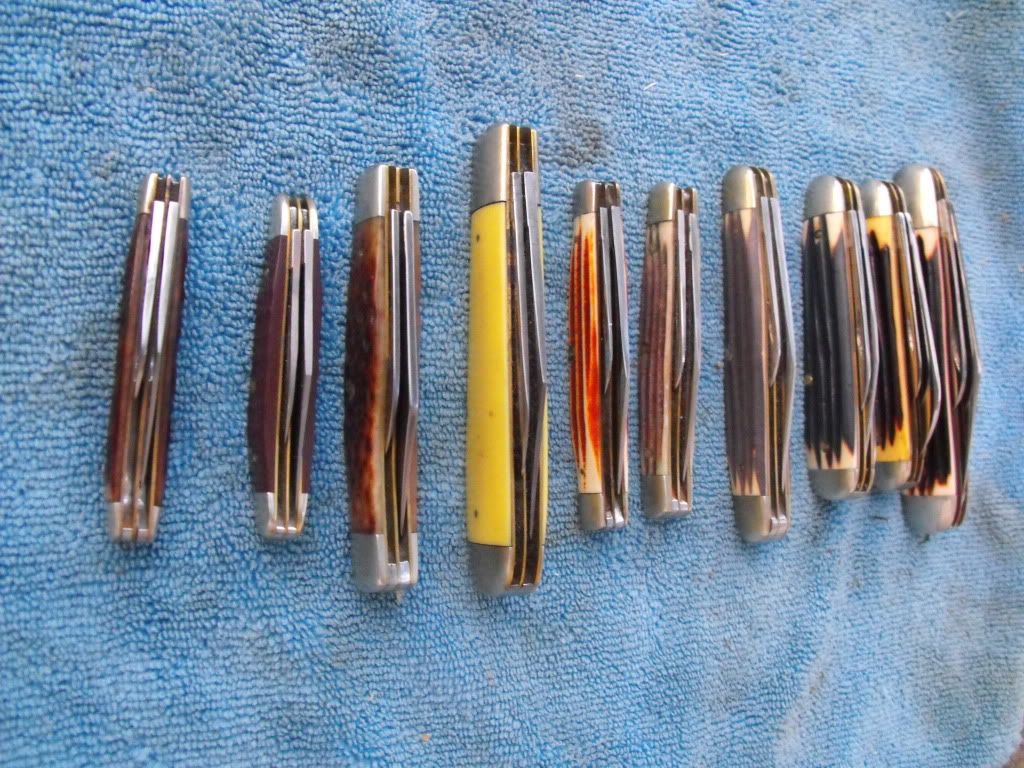

You picked a great day for this discussion. The sky clouded over and we've had intermittant rain showers since about the time I got off work. I only managed to snap one poor picture of the pile side pen family.
Three Case and seven Queens. I've got twice that many with the pen on the mark side, but generally when I carry a two-blade jack (which is most of the time) I carry one of these. I tend to use the large blade for rough work, so I like to have it easy to get to. When I want the pen blade for detail work, I want to slow down and be more deliberate, and for me having to turn the knife over and think about getting to the small blade is part of that process.

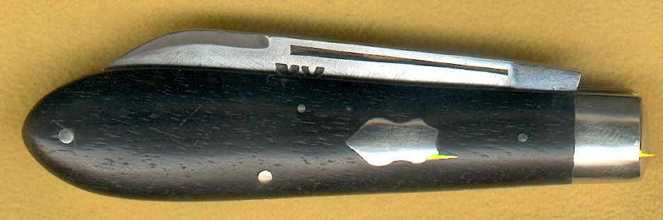

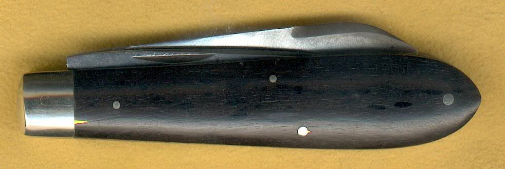

Related somewhat, is Pile-side punches. Here are two that I have;
You couldn't use these punches on a traditional cattle or stock pattern, so they were likely purpose built for the jacks. The fact that the knives are pretty old might tell us something about how attitudes changed around cutting corners/ and saving production costs.

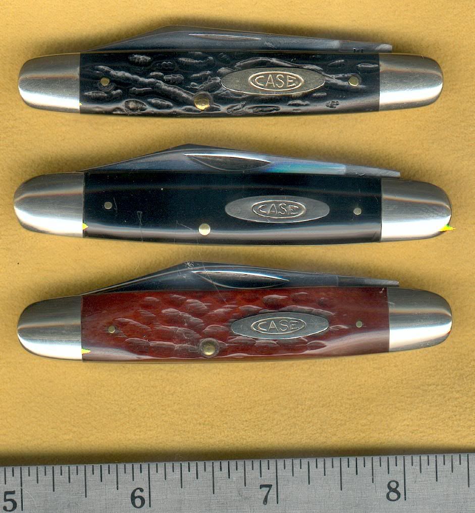

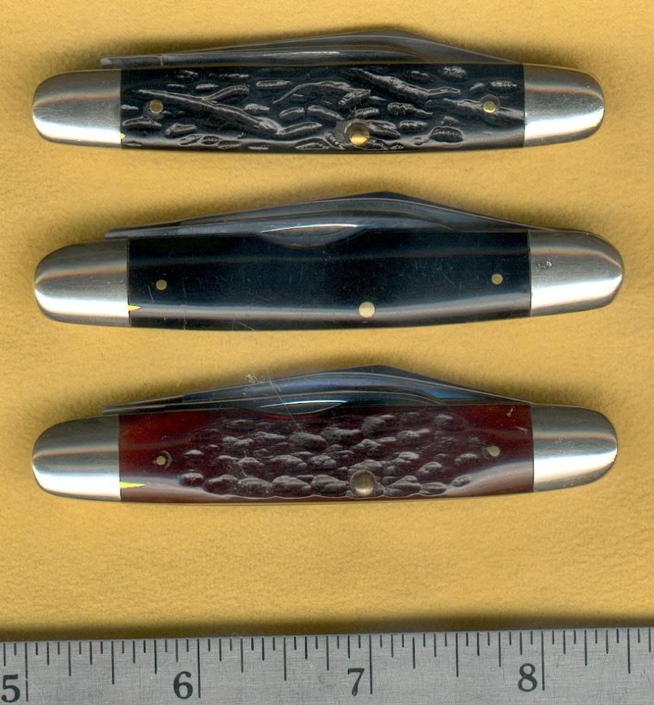

It is always enlightening to compare different eras of knife production. Here are three knives, with pile-side pens, from three different time periods of Case production.
The rough black, seen also on Tested knives (this one is an XX) is likely from early in the XX era, 1940s-50s.
The slick black is a U.S.A. so, ca.1966-67. The bone handled one is a 6-dot, so ~1974.
They are all 62055 numbered patterns.
The XX is slimmer in all proportions, even the nail nicks, and is definitely the nicest knife, best in the pocket. The relief cut for the pen is semi-hidden, a tapered notch through the liner that preserves the clean line of the oval handle.
The pre-molded rough black handles show what an ideally hafted handle would look like, jigged all the way to the bolsters and edges.
The U.S.A. slick black is heftier, bigger clip blade and nick, large cutout for the pen.
The dots knife is somewhat thicker through the handle (front to back), the bone taper-hafted, losing some jigging, and making it blockier.

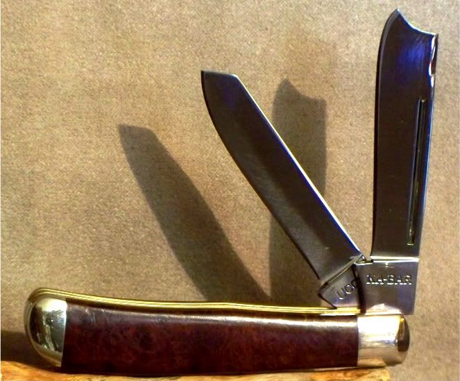

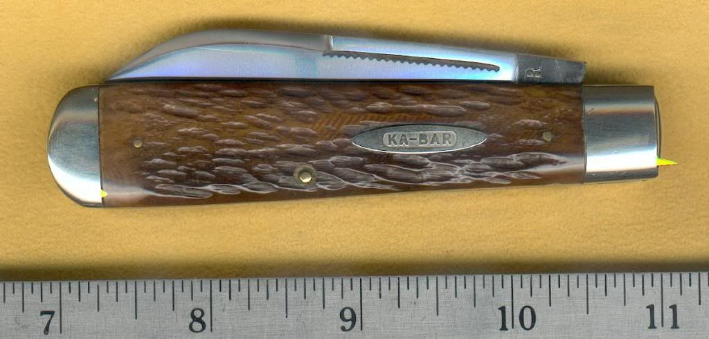

I found one more, speaking of sizes, Ken. I don't know how old this one is, but it's likely a second generation knife, and is pretty nicely made. Unusual, with a long pull on a big "pen" blade which would make a spear blade for a smaller jack!!
Big honkin' Ka-Bar!!
