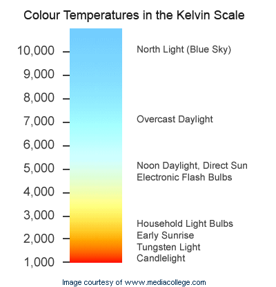

Light is simply the radiant heat operating at a temperature that your eyes can see. The cooler the fire, the darker it is. The hotter, the whiter it is. Temperature of the flame maps out to specific colors:
Smoke represents the degree of combustion. Low combustion results in lots of black, choky smoke. High combustion results in low smoke, high heat fires.
