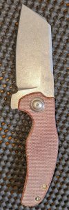

The butt end of this knife bothered me (literally, because I tend to rest my hand over the end of my knife , and it was the discomfort that this one caused that made me aware of it).
So I did this to it

I know it was just a general statement; but I'll respond. The OP asked why or how - in my example, the why seemed more relevant...and the how was pretty straightforward. I recognized that, untouched, I wasn't likely to carry the knife again. I considered selling vs modifying. It wasn't a popular knife; so I was guaranteed to lose money...and there was a lot I liked about it. Still, things can go wrong - would I be upset if I wreck it? Nope - I didn't like it that much. Decision made. That took more time & thought than the mod itself. I didn't plan it out, I didn't draw lines on the knife...I went downstairs, flipped on my belt sander, and pressed the butt of the handle against the abrasive. I did make the effort to keep the scales even; and I ended by touching up the edges I'd affected.
It is an amateur job, and its obvious enough that it was modified, if one looks; but it works for me.
