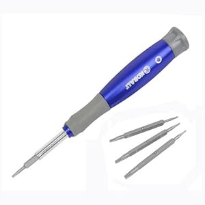

I get mine from Lowes $5 . I love it
T4, T5, T6, T7, T8, T9, T10, T15
I got this one first, rounded off the T6 in a couple of days (maybe half a dozen knives). Returned it and got a very similar Kobalt set that's held up through several dozen knives so far. The handle looks the same, but is ratcheting, the bits are single ended instead of double, and they're chrome finished instead of grey. It has T4-9, I believe (maybe 5-9) as well as a mix of hex, flat, philips, and some weird peace sign lookin' head I'd never seen before. About the same price. If it starts to round off, I'll spring for Wihas.

I don't recommend the Kobalt one from lowes.
Home depot's Husky brand are 10x better, they last a lot longer.

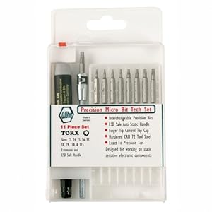

Def agree I tried a few craftsman torx they we're are all horrible and none fit good. Finally did research and bought Wiha 79242. Check that out for anyone looking for a good set of bits and nothing more. They are very nice and after using once you can tell they are good quality and for all you get with that little kit it is worth the price

I too love Wiha. I used to work with some expensive networking gear that would come with one phillips-head Wiha screwdriver in each box, and then bought a Wiha security bit set to work on arcade machines. For my knives, I bought this set and love it:
You can find them online pretty easily, totally worth the money.
I use the Wiha tools as well. #362 series Powerhandle (not the grippy 362)
CRM-72 tool steel hardened to RC60, made in Germany.

I'll look into some of the better offerings that you guys have pointed out if (when) these crap out, but I wanted something right away and these are cheap and easy.
