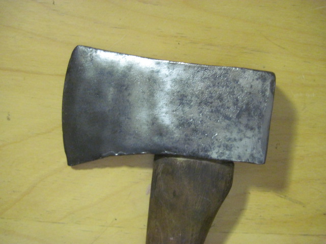

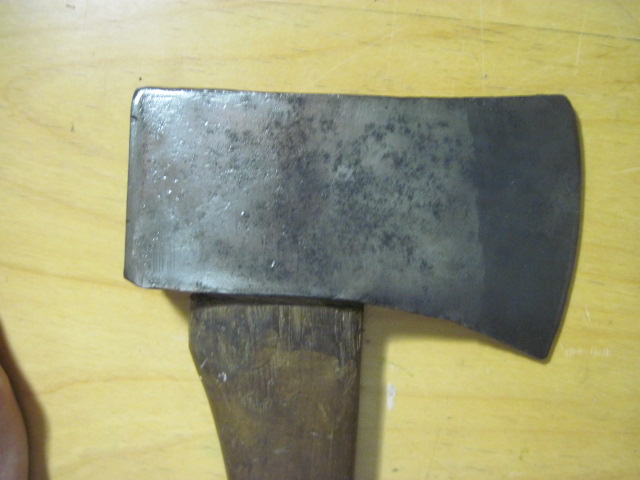

Well, I cleaned the head up today with a wire cup brush on a drill lent by a friend. Much more labour intensive than I had anticipated! Maybe I should have gone for a coarser brush... Anyway, thought I'd share a couple photos of the head afterwards. Definitely a big improvement!
You can really see the difference between the bit metal and the rest of the head! I'm glad to see that there is still so much bit left on it. There was some pitting left after working it, but it seems fine. I kinda like how it looks. Obviously, no stamp hidden under the rust, but I feel like the head has a great rustic quality. Still have to sharpen it up and refresh the handle. I'll put up some final pictures once it's all done.
Thanks to everyone here for all the help! My first restoration, and I am really happy with it so far! :D
