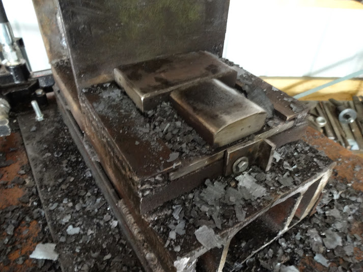

The set of combo dies I made from mild steel, and a view of the quick change die holders-

Here's a set of squaring dies I made- the bottom die will accept several sizes of top die, which I'll make more of as needed. I started with a 1.5 top die, which has already proved useful in starting the reorientation for crushed w's.
