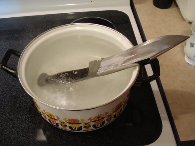

I got an AK bowie on a recent DOTD and decided to rehandle it in osage orange.

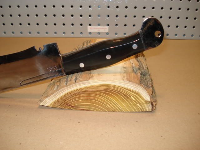

Here is the bowie in original form, with the chosen chunk of wood -
First I needed to remove the original horn handles. I followed Dan Koster's tutorial for most of these steps. Thank you, Dan! To do this you have to boil the handles to soften the laha. This took about an hour of boiling. -
Then pry them off. Easily done with a chisel and a hammer -

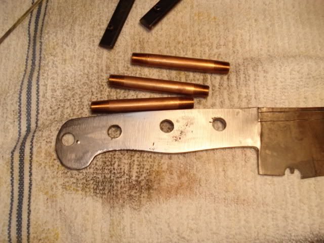

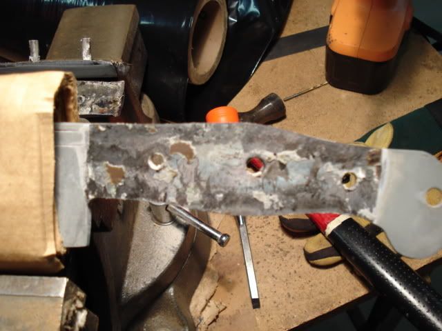

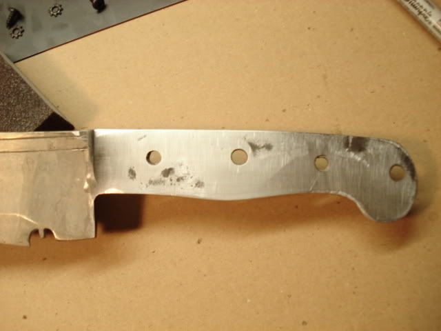

Once off, you have to clean off the laha and polish up the tang. I used a belt sander with 50 grit to get this done -
Once the laha is off and the tang is polished up, you have to even up the tang on both sides. I used the belt sander and a dremel.
Forgot to mention; I used a bench grinder to reprofile the tang. I took the hump off the top line, and made the bump at the end of the handle a little smaller.

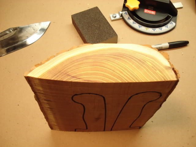

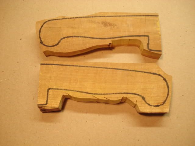

Then I marked and rough cut the scales. I used a table saw, a scroll saw and a belt sander to get this done. -

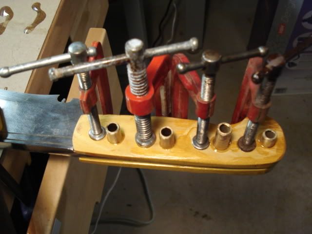

Once the scales were roughed out, it took a lot of time to fit them to the tang so they were satisfactorily flat.

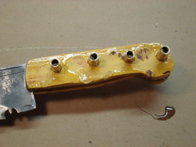

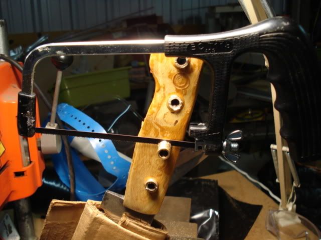

I drilled out the existing holes in the tang with a drill press. I chose the hollow pins from Home Depot. Just ordinary brass pipe fittings. -
I cut the threads off the pipe with a dremel.

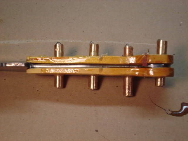

Once the pins, the holes in the tang, and the holes in the scales were drilled, I finally got to epoxy it all together. Messy!
I let that mess dry overnight, then broke it out this morning.
I took a hacksaw to the pins. I would have used a dremel, but I was afraid they would get too hot and soften the epoxy.
After the pins were cut off, I took the whole thing back to the belt grinder where I ground off the pins and most of the excess epoxy.
When I got off all I could with the belt grinder, I used the dremel on medium speed with a rough drum to get down to the tang.

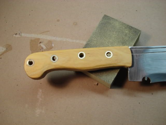

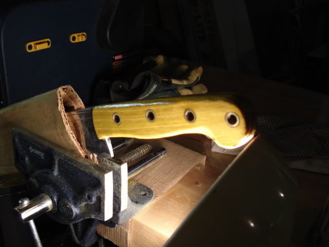

Then I sanded the whole thing by hand using sponge blocks, rough grit. I then coated the whole handle in super glue.
When the super glue was dry, I sanded the handle down again, then put on another coat. It dried, then I sanded it down again, finally using fine steel wool.

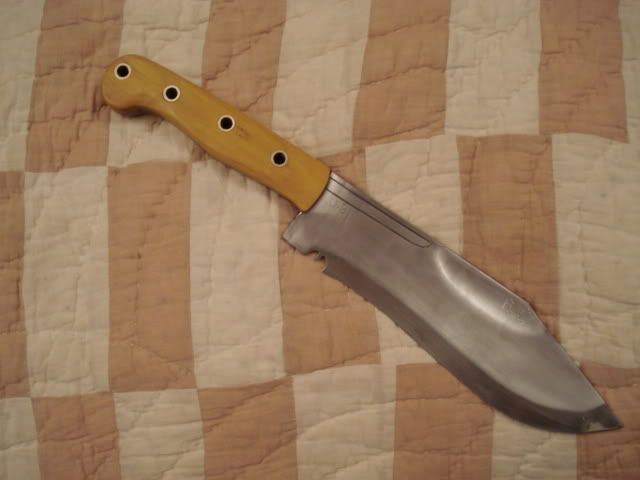

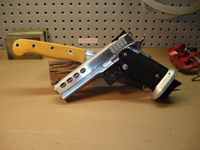

I cleaned the gunk out of the pin holes using a small file. Here is the final product, with my new Brazos Semi-custom .40 2011.
All in all, the whole job took me about 10 hours I guesstimate. I think it turned out pretty good!
Andy
this may sound stupid, but that blade actually looks really great stickin up out of the pot.
Thanks for the "on end" pic...looks great!

VERY nice, Andy. Osage is a great wood, isn't it? Almost as hard as the horn, too.
That's a very original treatment that you did to the bowie, one that I consider a big improvement. I find that the exposed tang at the end hurts when I'm chopping.

Andy the next time you do an Osage Orange handle try to get some wood from a crotch part of the tree. It's hell to cut but worth it because of the grain going different directions but that will give you some nice figure.:thumbup: :cool: :D
nice. If you cut the scales from 12 o'clock to 6 o'clock (from bark to centre) in the picture, you would have had scales that were mirrored from one side of the handle to the other.
If I understand you correctly, that's what I did, except that I didn't think that I could center the scales more in the grain. I thought I would need more wood. It turns out that I didn't need as much wood as I thought I did, but I tried to play it safe.
What does the grain look like if you cut the scales across the grain, rather than with it like I did? Would that have given more figure also?
Thanks for the tip!
Andy

Currently I have removed the scales of mine. I found the tang to be canted at least 5 degrees off from the center line of the blade. I'm trying to figure out how to handle that issue now. Your project is a big help!!!
