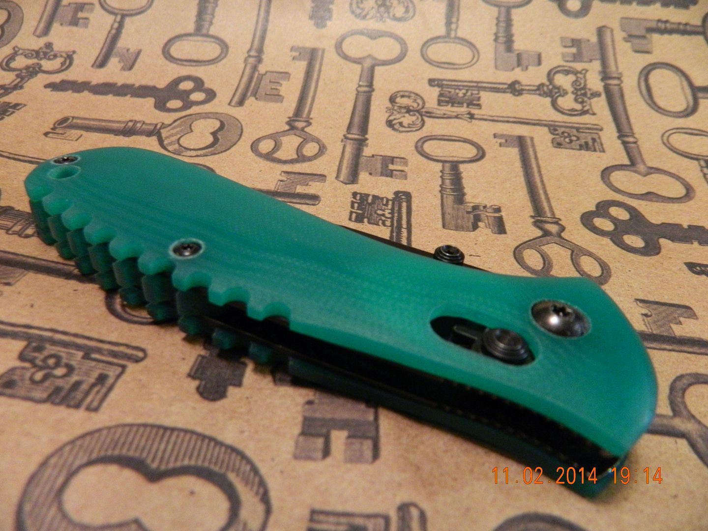

Wave mods:

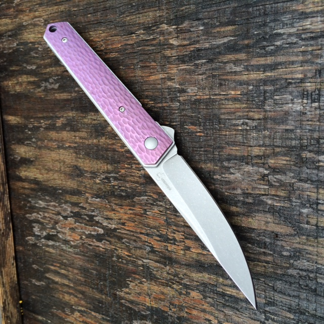

Homemade, one piece titanium shouldered floating barrel - in place of the lanyard w/floating pin, along with modified titanium standoff bushing:
Milled finger tip dimples, both side of titanium scale, to provide an exact fit, for my ambidextrous hand hold. As well as lighten internally and finished with flame on a mirror polish for durability:
Kydex handles. Interesting idea! How did you come up with that? .093 or.125 ?
Hey Shepard,
Sorry I missed your inquiry.
Kydex, as you know, comes in a .093" thickness...which happpens to be pretty darn close to the same thickness as many factory scales (.090").
Both Spyderco and BM uses this thickness on many of their flagship models.
The knife pictured has the .093" kydex on it.
