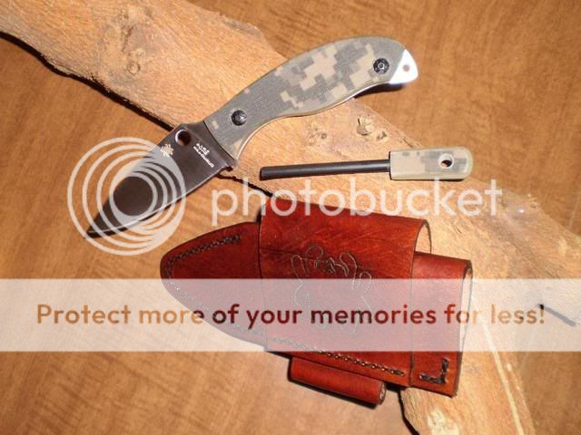

Here are a couple I modded. Nothing spectacular though.
The Busse SS I took the recerve out of the blade and convexed it, and stripped it.
The GW below that one is just convexed with a polished blended convex to the flat grind (the glow dots were added by some one else, but I am thinking getting longer lasting glow power and re doing it.)
The green handled knife I actually made out of 5160 bar stock. It was cut, filed, and shaped, and heat treated all without any power tools. Files, sandpaper, and even a hand crank drill (that I have had for ever). (the steel was from this forum). Not really a "production mod" but it is in the pic, and thought I would explain.
The CS recon 1 folder, I just convexed the edge and rounded the tanto point a bit. Not much of a mod.

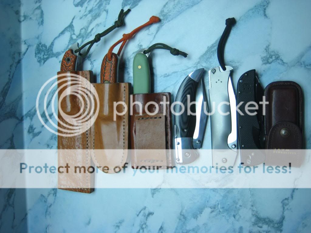

Made up some sheaths for some of them as well.
The green handle has a new sheath with a clip. But my camera is on vacation right now.
here is how the green one began
This is what the SS looked like when it was born.
