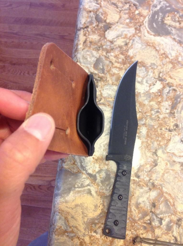

This is another sheath I made recently. Its not a SURVIVE but there is a necker in the photo so I guess its cool to post it here.
I am really loving the hybrid Kydex sheath with a leather belt loop. Its sort of become my trademark style. This is a new design of loop for me. I took the idea from the old kbar leather sheaths
Get yourself a cheap leather punch from a craft store. It makes crafting belt loops much easier.
