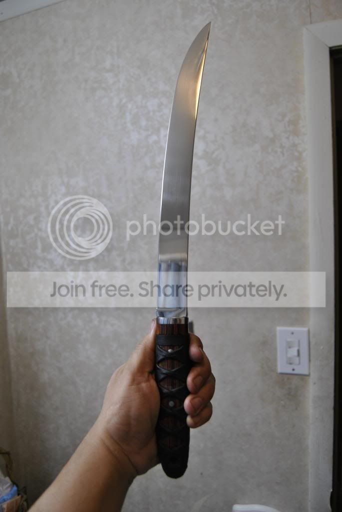

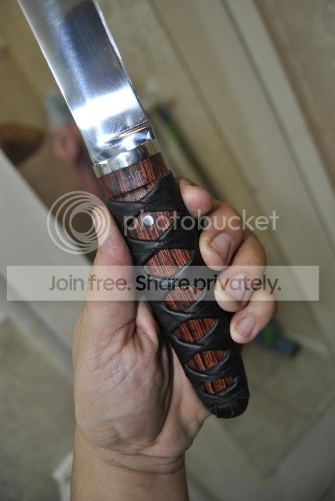

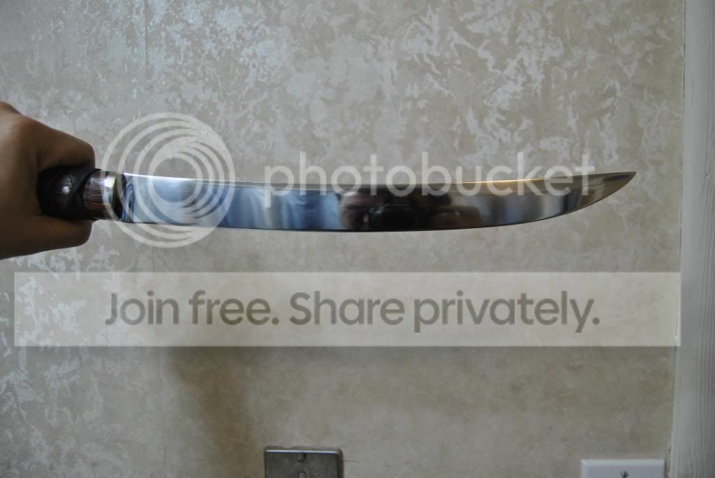

As the title says, this is my first forged blade. Up until now, the other 2 blades I have completely finished have been stock removal. What I need help with is classifying this blade. I wanted to make a wakazashi, and from what I have read, blades over 12" long are considered a wakazashi, and under 12" are considered a tanto. This blade is 12 1/2" long, and the overall length is 18 5/8". So I suppose I should just come to the best source for an answer to this....Bladeforums. Anyways, about the blade.... Its 5160, and the handle is cocobolo and I used leather rather then the traditional silk to wrap the handle with. As always, critique is welcome and appreciated.

My only thought would be that you could spend a bit more time on the hand sanding.... especially around the plunge. Its, for me at least, the toughest area to get rid of all those little faint scratches before moving on to the next grit.

I like your simple and well executed blade.
The blade is at the max end of tanto size. The blade is hira-tsukuri, meaning full bevel with no center ridge. The handle and fittings are Aikuchi, which means "Long knife with no guard". I would classify this knife as O-aikuchi, which means "Long aikuchi".
If the blade had habaki and small tsuba it would be shoto-wakizashi, which means short wakizashi.
Japanese blades traditionally don't have a plunge line, but instead have a habaki, which acts as the same thing in some respects. your fusion style blade is nicely done.

Thanks Stacy. Other then seeing pictures and working the steel to make it "look" similar to what I have seen, I don't really know much about them. I just wanted to make something that was truly functional, but will probably never get used.

BTW Big Blue. as far as the hand sanding goes I agree. I wasn't exactly looking for a mirror finish, and wanted a faint, uniform grain direction. But As you can see in the close-up of the handle, there are some slight grit lines that shouldn't be there. This is my motivation to do more and get it right!
