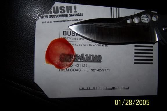

I think I could have done even better with the tomato - but I grabbed it from my wife while she was making a sandwich so I rushed the cut. This is the BM Skirmish, and the corners of the paper were sliced off with it too...

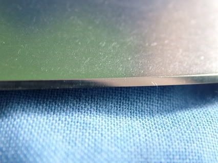

I like a very thin polished edge. Sorry my photography skills aren't up to par.
