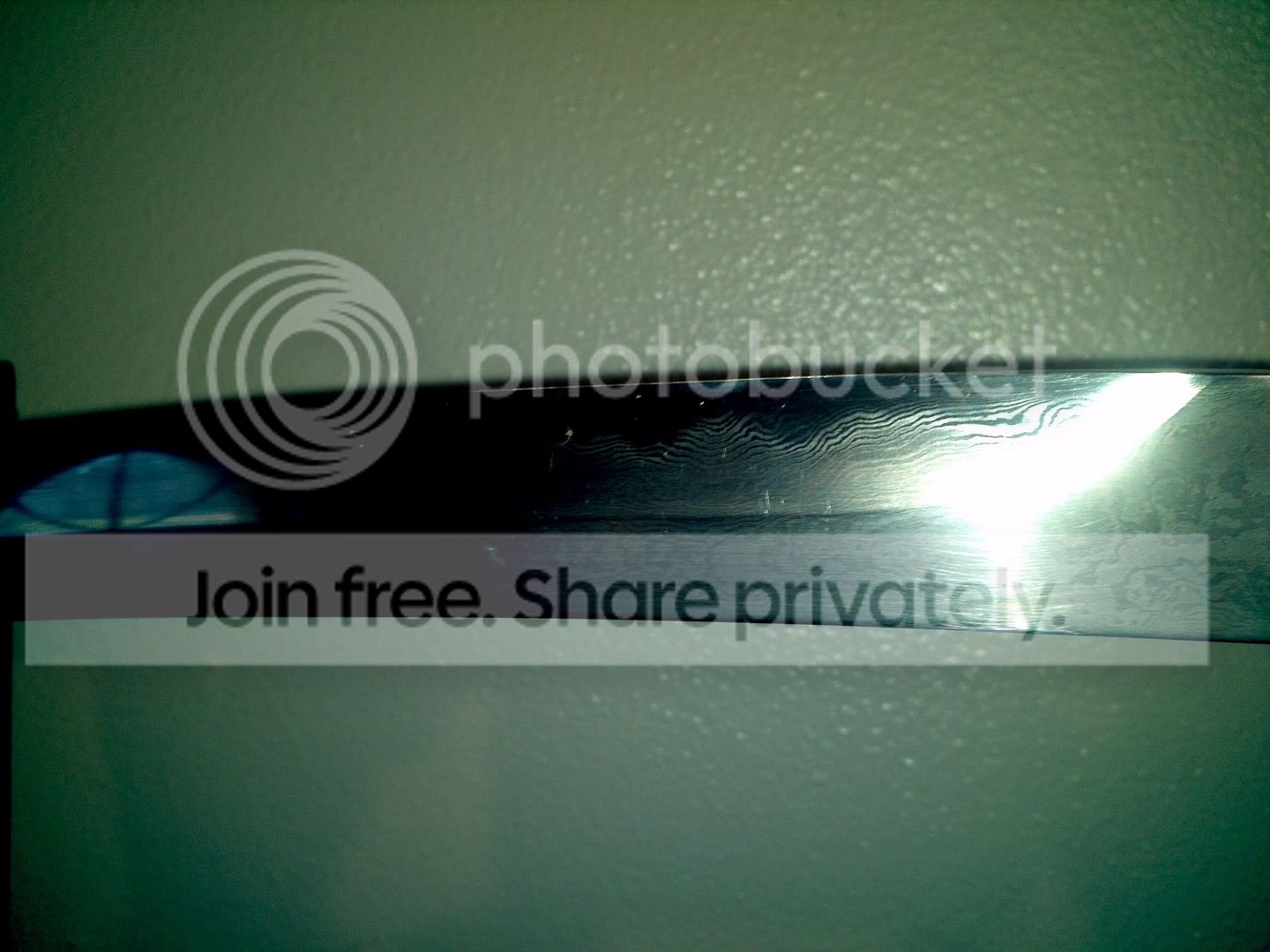

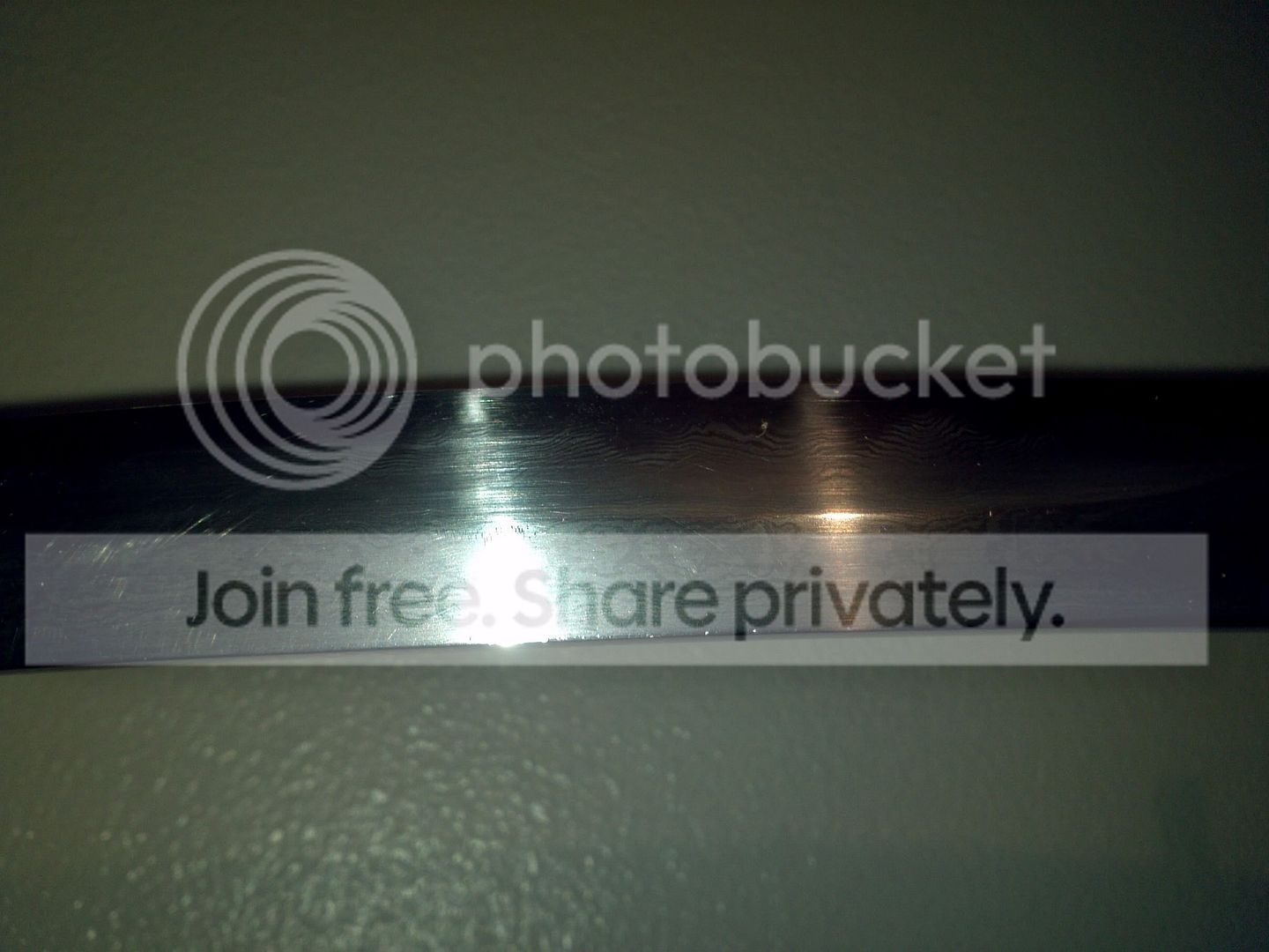

The Tanto itself:
The tanto is done in a traditional shobu zukuri style. Overall proportions were okay, and I would consider the geometry traditional. The mounting however was meant for a tactical hunter. A bear fighting knife as Virtuoso would likely call it.
The folding grain is tight, and is done is masame style.
Masame style jihada (steel folding grain pattern) is done by taking a billet of steel and folding it over repeatedly on the same side, like a sandwich. This creates an effect of layers of steel.
The clay tempering produced a hamon in the gunome style, producing a "even" waves pattern.
Ricky did not know this until much later but the forge he uses in China does not fold the steel themselves, they buy the billets prefolded from a company that makes them using metallurgists and machinery. This they say assures no air pockets, no welding issues, etc.
100_0546 by crazysur123, on Flickr
No tsuka, or fittings just a leather sheath, some samegawa (sharp skin) strips and a japanese style tsukamaki wrap done in Hineri maki without alternating ito. The ito itself as a low quality cotton ito, and the samegawa strips were of low quality. They were shortly replaced with high quality samegawa, shark skin, (Namikawa grade 1) and wrapped in semi low to medium quality cotton ito.
Overall the tanto's steel was superb, the person who polished the tanto out however was not as the shinogi (flat spine) was uneven. Problems in chinese quality control.
