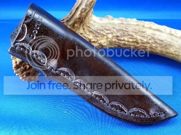

Hi guys,
Been trying hard lately to improve upon my severe lack of picture taking skill.
Improving was actually quite easy because I suck so bad at it:o, but unfortunately taking nice photos has been a little bit more of a chore.....
I am going to include a few pics I took yesterday with my new lightbox setup, and hopefully someone here with more picture savvy than I (that's everyone) can offer a little insight.
Please keep in mind that these are the best of the photos of many that I took, and after all the photoshop editing....
The knife pics are something I can live with, but the sheath pics are still terrible. I've tried to do what I can with the camera settings, but I'm really ignorant as far as my camera knowledge goes. Infact at one time I actually overheard the box laughing at me:D
Any help would be appreciated.
Thank you

mdoyle, what are you using for a camera, and what iso setting is it set at?
the white speckles could be specular reflections from a high gloss finish in the pores of the leather, you may be able to kill some of that through polarization or more diffusion, but the fact that they seem to be ubiquitous indicates possible dark noise/amplifier noise which the photoshop is going to accentuate
Please show us the unmodified, I will be able to deconstruct better

the iso setting was @ 200 not even sure what that means but I do know that is where it was. There is a high gloss finish on the leather as you stated.
I went down and snapped another pic without any mods for you to see.
Here ya go.

Okay here it is with the aforementioned changes. I'm sure it wouldn't get the thumbup from Coop, but it is still easily the best I've taken. The knife inside of the sheath is not finished, it is only @ a 220 finish so the color and everything is probably about right for it as well. Thanks a ton! I really appreciate your help!:D

glad I could help, I used to shoot for a living, and have taught before the combination of the economy in upstate NY going to hell and changes in technology put most of us out of business. Photography used to be my life, and metalsmithing used to be a sideline that I would do professionally when the photo work was slow, now I am a metalsmith with a day gig farming a cubicle trying to figure out how to re-establish my photo business as a sideline in a new town that is slowly getting destroyed by the walmart disease. Try experimenting with your ev settings, also you may want to do some with a less brightly colored background unless you are using the blue for doing a chromakey knock out. The strong cbackground colors may in some cases adversely effect your color balances

ISO is your shutter speed 200 is for outdoor good natual lighting. also a good all around film speed. you may try upping it to 400 or so also.
and the new photo is way better with less glare. However what color is the Sheath it looked a little brown in the first photo.
also How many lights are you using? one from each side showing through the material or more?

The sheath is black. Dyed with feibings Black. I am using one light for ea side and one for the top. 3 total. 100w daylight flourescent 6500k

ISO is NOT your shutter speed, it is your sensor light sensitivity.
Shutter speed and Aperature can be used reciprocally to adjust the amount of light entering a photographic device to best suit the ISO of the sensor.
ISO stands for International Standards Organization which is the committee that standardized film speeds internationally, ISO rating supplanted ASA (American Standards Association)
Technically 100 is better for general outdoor, especially if you follow the sunny 16 rule, (in bright sunlight in the northern half of the US with an aperature of 16 your shutter speed will be your ISO, in the southern half of the US that actually works better at F22) at an ISO of 200 you will start to run out of settings on the typical camera.
