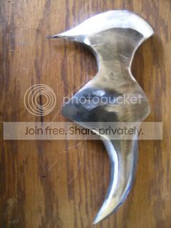

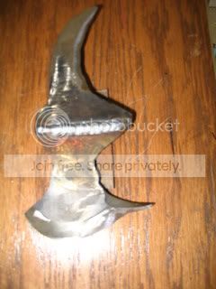

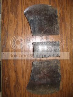

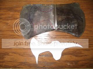

This is a hatchet that a friend of mine designed and wanted me to make. It is definitely different from anything that I have ever made, but I have enjoyed making it. I will have it finished tomorrow. Thanks for looking at the pictures.
Cut double head ax
Traced design
Welded
Grind

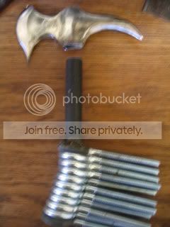

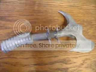

Work on handle
Sand blast
Heat treat

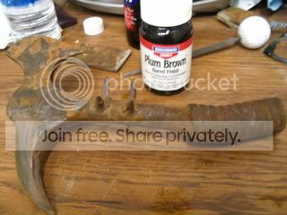

Applied antiquing barrel stuff at 275 degrees

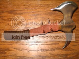

Wrap with leather

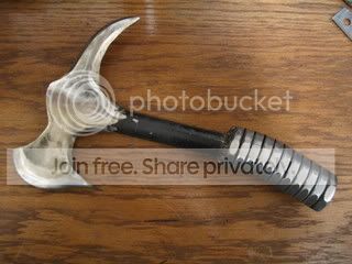

Looks like something the bad guys carried in the sci fi movie Serenity :) I like it!
That a very cool lookin hatchet! nice lookin weld too! I dont see much splatter so was it stick or maybe tig welded? good job anyway!

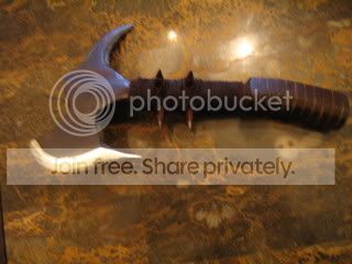

Thanks guys, it is a Mig welder. When I asked the guy I made it for why do you want spikes on the handle he said so no one will take it out of his hand. Ill make sure I dont piss him off after I give it to him. LOL
Adam
This is the picture after I got it done, Im thinking I shouldnt have gone for the antique look.
