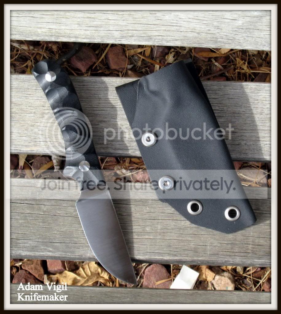

Anyone have photos of blades finished with a Scotch-brite belt? I'm curious how well the finish looks.
Took these yesterday, fine Scotch-Brite after 320 grit

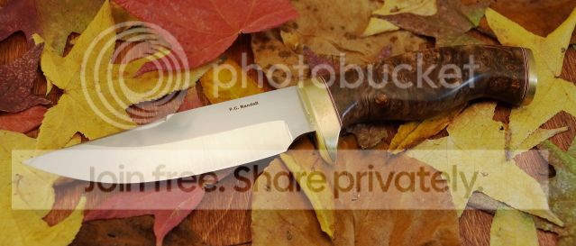

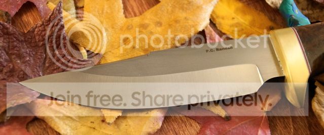

Just posted one of these on a different thread, so it's handy ...
This is an example of a couple different techniques.
It involves SB belt on the primary bevel. The flats/ricasso "scratch" pattern runs perpendicular to that of the bevels. That's skated by hand.

Very nice examples, thank you. Are all 3 of you guys using the fine belt for your finish? Are there any tips for using the belts to get the best results?
Wow. All three of those knives look fantastic!

Grizzly,
I use cork first with green compound, which makes a somewhat polished finish, then knock it back with SB. That way you know you don't have deeper scratches in the background that will peek through in the right light. Also you don't have to lean on the SB so much which lessens blurred edges and helps keep things looking flat and crisp. If you over-SB the surface, it tends to not look so good, IMO. It's like it stops cutting and gives a sorry sort-of polish.

Thanks. I usually take it to a 400 grit gator belt which in itself leaves a nice finish, then a light SB action to really smooth things out.
I use a fine SB with black compound, you really have to have near a 400 grit with no deep scratches to get a good finish, but after that it works pretty easy. If after a couple of passes I see scratches I look to see how far back In the belts I need to go and redo the SB.
