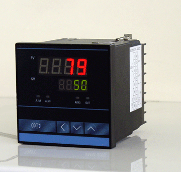

I'm about to order my Pid and Thermocouple for my temperature controled forge setup and this is what i have considered buying. First off the pid, I dont need any ramping or fancy stuff so i am just going to get a standard model but i dont realy want a small one as i want it to be big and easy to see and program. so i was thinking of getting a 1/4 DIN PID instead of a 1/16 DIN. but every refrence to a pid i have found online for a heat treat oven or forge uses the 1/16 DIN. is there a reasion why they use that insted of the biger one. here is the one i want. this is the link to it http://auberins.com/index.php?main_page=product_info&cPath=1&products_id=102
and it's picture
Will this work ok, i would imagine it would but i thought i would ask.

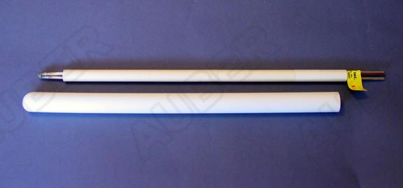

now next up is the thermocouple, as i'm going to be using it in my forge i wanted somthing robust and strong. i had looked at the ones from Auber, this one http://auberins.com/index.php?main_page=product_info&cPath=3&products_id=39.
but that one needs a proctive thermo well around it and that is another 18.00 http://auberins.com/index.php?main_page=product_info&products_id=40.

Looks like you did your homework.
I don't like those itty bitty 1/16 DIN controllers, either.
All your choices look good. You won't get fast responses with the massive thermocouple, which is a plus if you use it in a forge, as it averages out the fluctuations.
+1 on the SSR suggestion by sunshadow.
Hello JT,
The 1/4 vs 1/16 is only $10 difference. I have the 1/16 and like it very much. I also have a 1/32 and that is fine as well. Any size will work as long as they cover the options you need like AC power through 240V, 60Hz and PID for a SSR rather than a relay. Both my PIDs are from Auber and they were great to deal with.
I use the Omega Super OMEGACLAD® XL Heavy Duty Transition Junction Thermocouple Probe for my salt pot (called to order a custom 18" to allow a good bend to the side) but use the Auber kiln thermocouple that you have pictured above along with its protective thermo well for the gas forge. There is a lot of oxidization that will take place in a gas forge and you need that ceramic insulator protection.
I also use grounded thermocouples in both instances in order to have a quicker response time to tempurature change. I'm looking for fine control.
Be sure to order a heat sink --> http://auberins.com/index.php?main_page=product_info&products_id=77 for your SSR. If you don't you may get runaway temps and possibly damage your SSR (ask me how I know this...). I also mount a small computer fan to blow across the heat sink as well. No problems with runaway temps after this adjustment.

So should i not get the omega thermocupple then. I was reading about it that it has aluminum oxide on the out side of the sheath to protect it from oxadation.

I can say from experience that the whole "you need a ceramic sleeve in a forge or you're toast" is a bunch of bull. I have a 1/8" OmegaClad thermocouple and it's just fine and has been for quite some time. Only some minor discoloration on the part that goes into the forge. I specifically asked the folks at Omega about this on the phone and was told that the OmegaClad was find for oxidizing environments (it even says on the website). I went un-grounded for longer life in a really hot environment. I went 1/8" as it will respond much more quickly to temperature changes than the 3/8" one and is plenty durable. Also, the quick disconnect end on a 12" probe is just fine. If your probe hangs out of the side of your forge a bit it won't hurt anything and it NEVER gets hot enough to hurt the quick disconnect plug.
So, that works out to part#: KQXL-18U-12 and the cost is only $30.

In my conversation with Omega, they recommended a ceramic sleeve for their OmegaClad thermocouples when running at continious tempuratures of 2200F in a gas forge. It's cheap protection to prolog your thermocouple. Check out this link from Omega --> http://www.omega.com/pptst/ORX_INSULATORS.html
Non insulated will work but insulated will last longer. Got this right from the Omega reps mouth. Just my .02 cents from what I was told. :)
