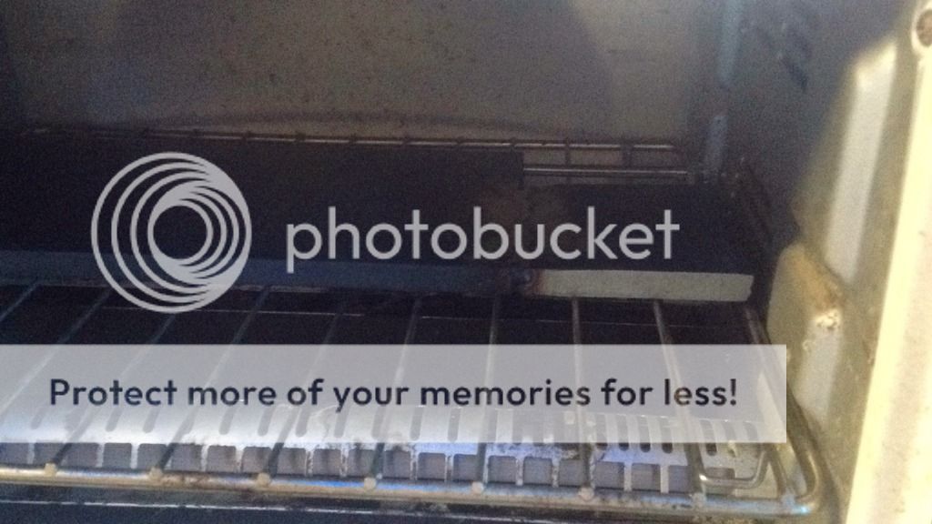

You can see the thermocouple going into the 3/8" steel plate used for thermal mass. This sure does help it maintain temp.
