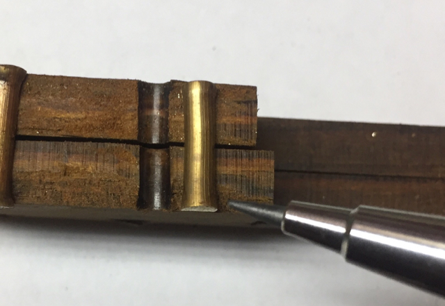

a little follow up on this
I just peened two pins to test and then sawed in half to see the cross section
The one on the left is peened by rounding the top
The one on the left is more pounded to create a swell. This would mostly be used in a bolster where you wanted to fill the hole and create a seamless bolster pin match
wood is cocobolo I think
pin is 1/8" brass
welcome any comments or suggestions
