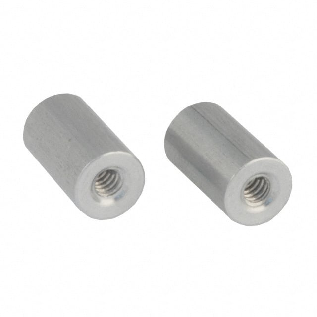

I need to find a stainless steel rod/pin at diameter 0.197" and length of 0.290".
It needs to be threaded for 2-56 screws (I have no lathe or lathe access:().
A longer length is fine, as I can cut it shorter.
Does anyone know of a supplier, or have something like that themself? I've tried Knifekits and Texas Knife supply so far with no luck.
Thanks.

What i'm picturing from your description is a pin with a female threaded hole in it?
This
I'd call that a threaded bushing, or threaded standoff or something like that.
This

That is what I'm picturing.:)
You're right about the hole though...I meant 2-56 (durp!)
Going to edit the original post to correct my mistake.
Yep, looking for it as a folder part, a stop-pin replacement to be precise.

those standoffs in 2-56 are pretty rare, 4-40 is the most common smallest size
then they would be standard diameters, .1875 and .250
then they would be standard lengths .250 and .375
and so on

Get some 5mm stock and just drill and tap it, if you have a drill press or a mill it is doable
I found some rod material at Knifekits.com which is 0.196" diameter (close enough:)), but unforunately I have neither a lathe nor a drill press nor a mill.:(
All I have is a Dremel and a 2-56 tap.
