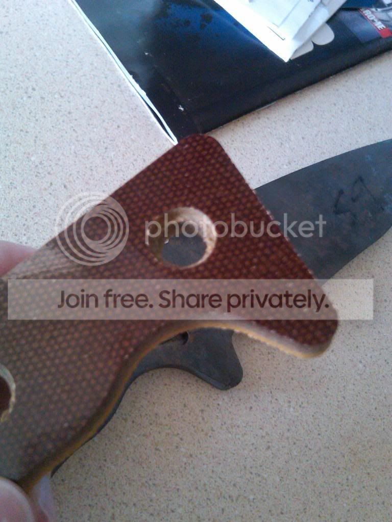

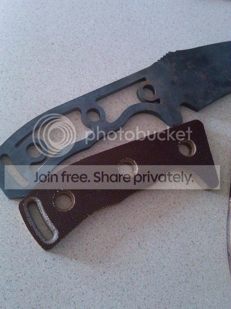

As you can see from the pics that the outer hole is a larger diameter than the inner. The inner hole matches the hole in the steel. It is a right at 3/8". The outer hole is a hair under 1/2" but right at 12mm as measure with my handy dandy calipers. That was my plan to grind it and send it off. I don't have access to an oven like that and like I said I'm new so I want to see how this works before I drop too much coin. thanks for the quick replies.
I see now that they are recessed for a corby style rivet, although you may play hob trying to get some that size. Buy some 3/8 hex bolts in stainless or brass and round them to fit if you can't find anything else. You can also check jantz supply for rivets.

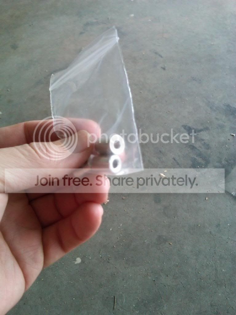

Took some pics today of my progress. Picked up some spacers that fit perfectly,

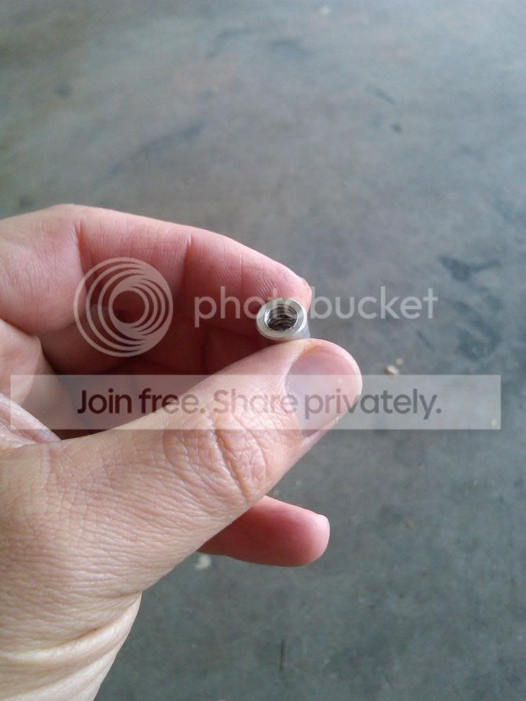

then drilled and threaded them,

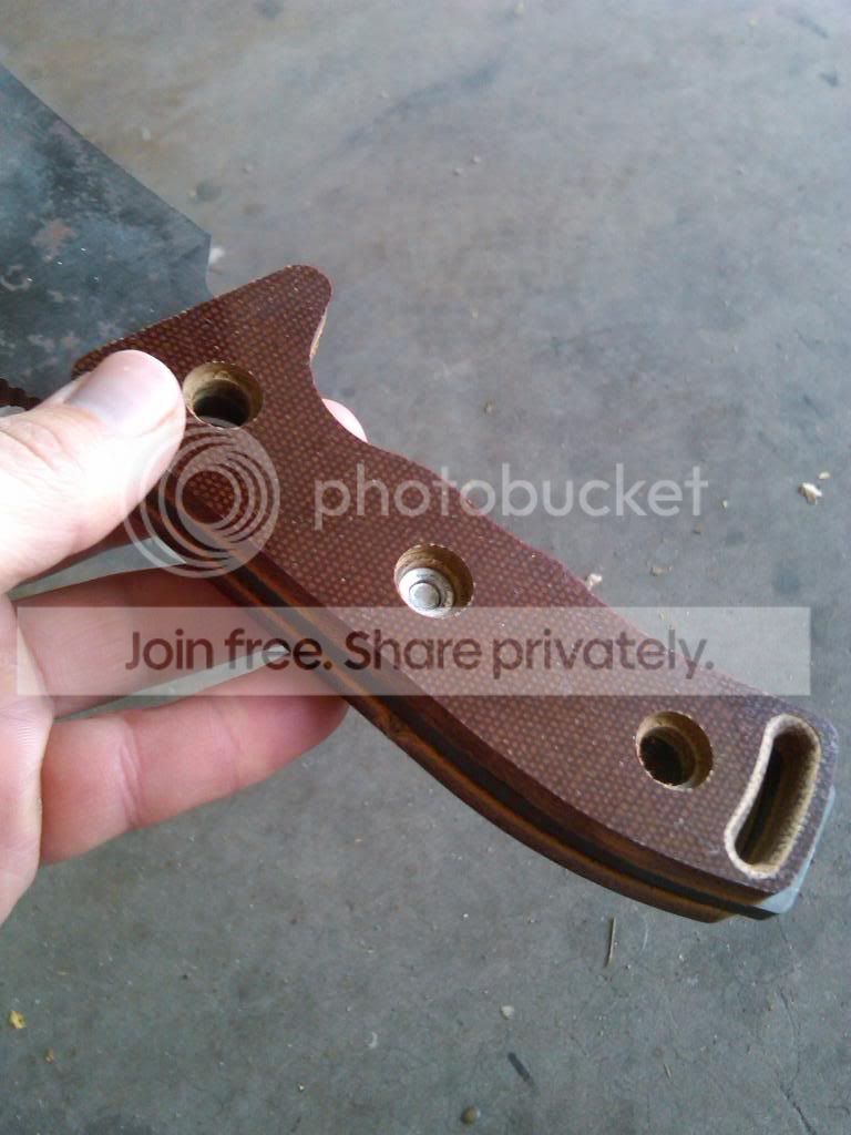

I had to open the hole on the handle scales just a tad, but the spacers fit the blade holes perfectly. These spacers are just a hair shorter than the total distance across. I have to cut the screws down a bit as you can see here,
The snake eye screws are kinda cool i guess,
and finally you can see that I'll have to grind the head down a little.
shouldn't be a problem, just need to mark them. The holes for the snake eye tool go down pretty far so hopefully won't be an issue. Plus I won't need to after its all in place anyway. Sounds ok but again, this is my first time so I guess we'll see.
