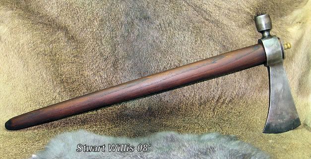

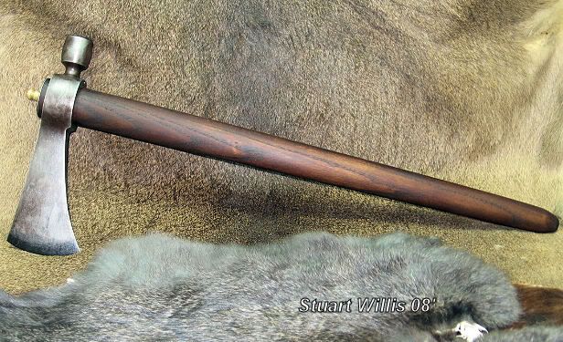

Here is one I just finished up for a customer. Forged from 1x1 1/4 mild steel. Piece of plow steel forge welded in for the cutting edge. Hand carved white ash for the handle. Mild steel end cap and deer antler for the clean out plug. Lightly aged. Sealed and ready for smoking.
That is quite pleasin' to the eye brother...superb work. :thumbup:
