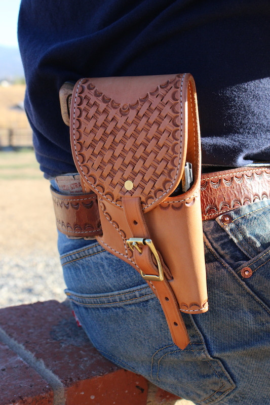

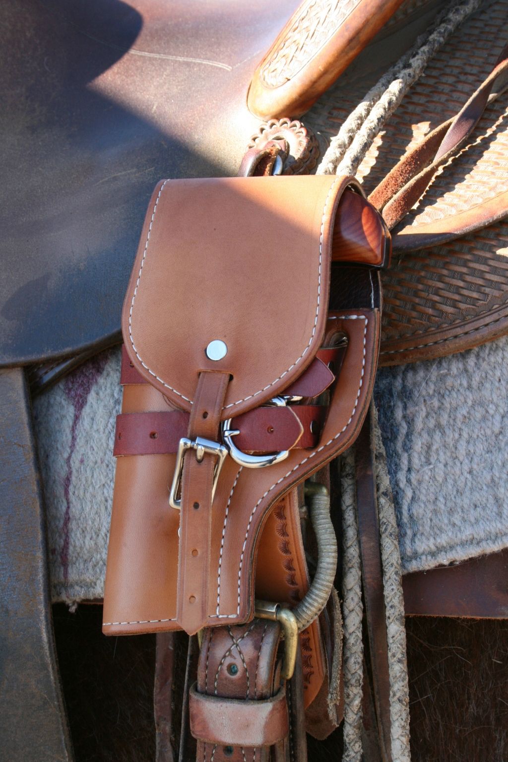

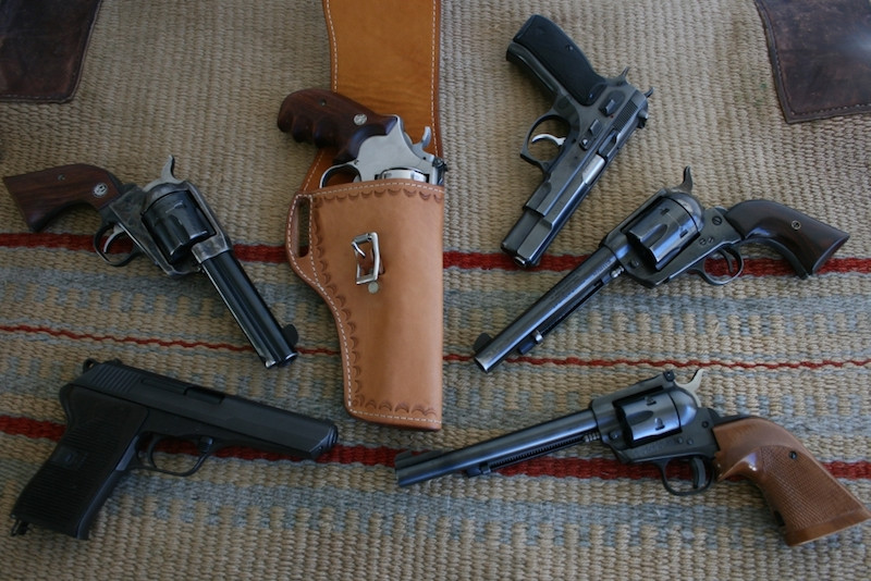

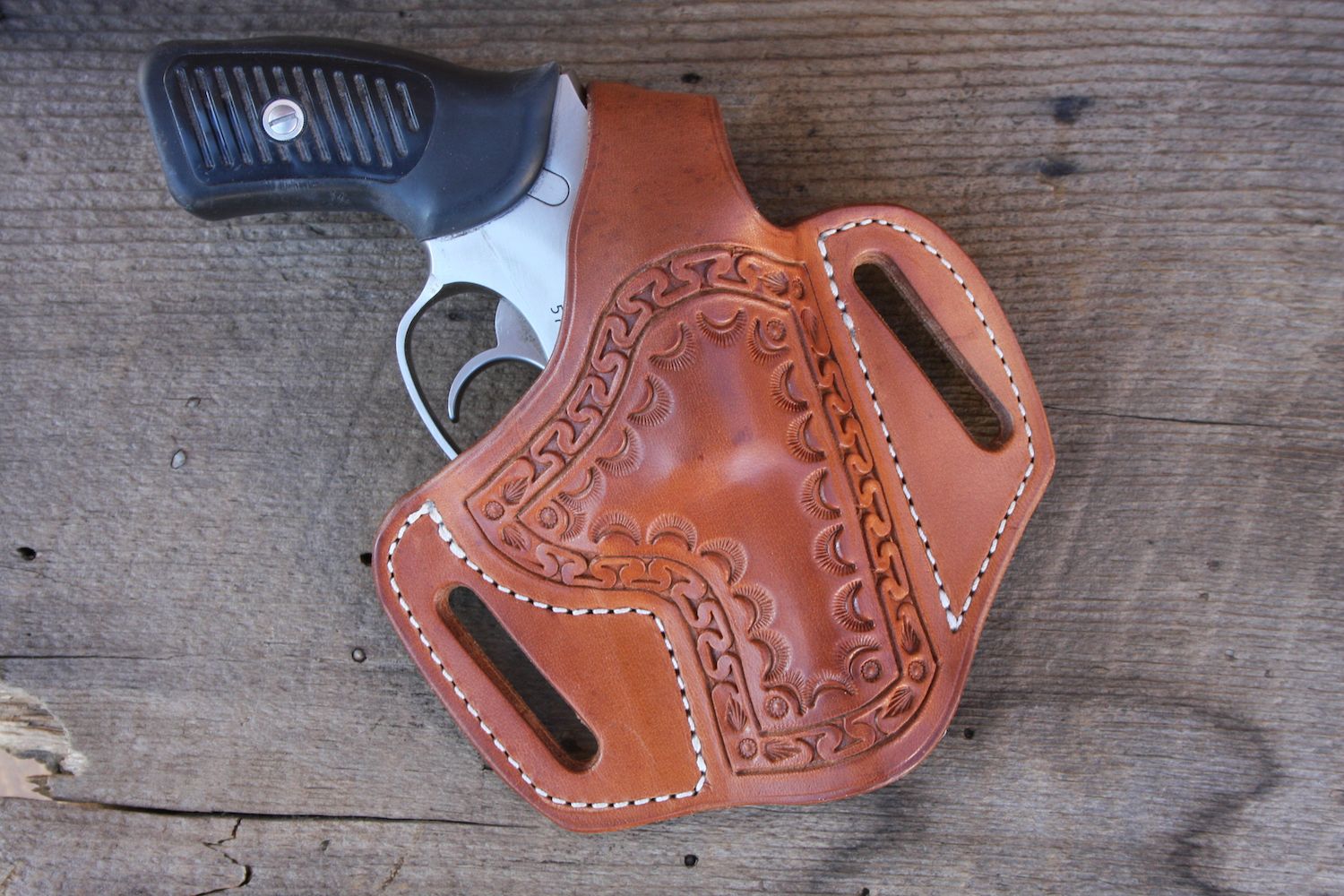

My Rangeflap holster. Here for a 2" Smith revolver. Very popular around here as snake guns. Cool thing about the Rangeflap holster is it is not gun specific. It works off of frame size.
Another Rangeflap, roughout this time. This holster is fully lined and the belt arrangement on back is the same as my Slot and Loop sheath. The holster can be worn strongside or weakside crossdraw.
All these fit the same holster including bottom right a Single Six with aftermarket target grips.

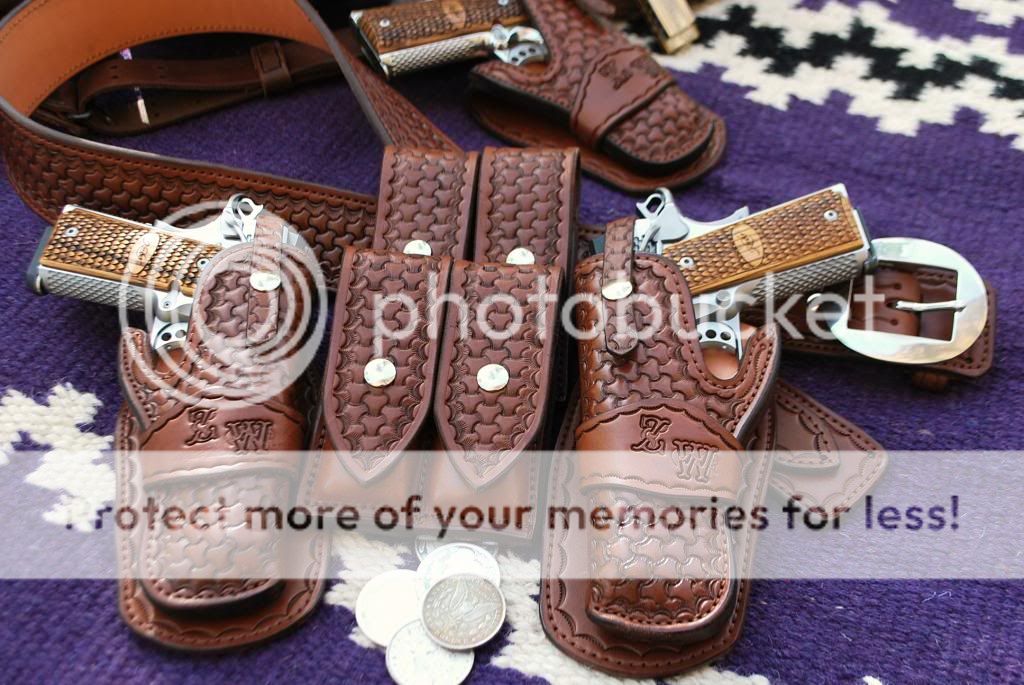

1911 Open Top can really be made for any gun. I just call it a 1911 holster.
An earlier 1911 holster with the retention strap. If ya compare the two 1911 pics ya see I've extended the rear tab for the belt slot about an inch. This allows the holster to lie flatter against the body. Both of these holsters are owned by the same guy. He says he much prefers the open top without the retention strap.

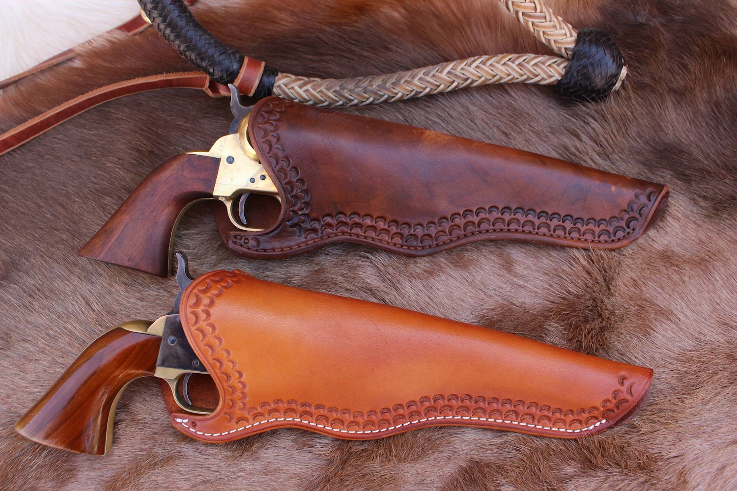

These two had their own thread a while back. California Slim Jim holsters, can be worn strongside or crossdraw too.

Those Rangeflap holsters look great, but that leather strap seems cumbersome and slows down your draw speed.
Wouldn't a simple snap closure be much more speedy when it comes time to draw?
You could even space the buttons apart just like the holes in your strap for different sized firearms.

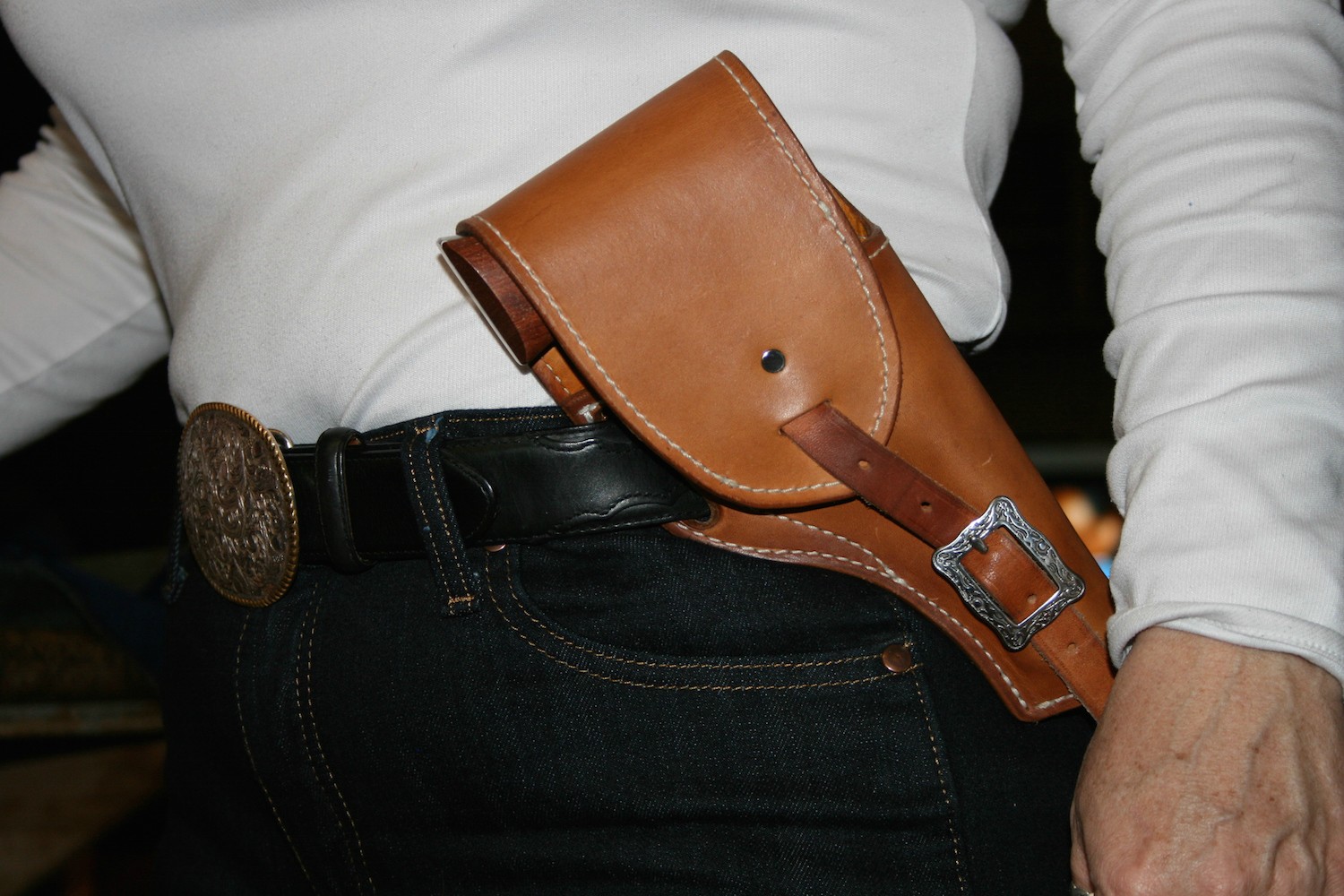

What are your thought on angle - cant of the holster .
If it's worn on or just behind your hip is it best to tilt the whole holster slightly forward rather than have vertical ?
It looks like those 1911 holsters are canted forward , but the flap ones seem vertical , is that the case or an illusion of the photos ?
At the moment I'm leaning towards a flap holster , the more protection the better and quick draw isn't required .

Vilepossum That is the normal way of carrying a 1911, cocked and locked. If you look at the cellphone, toothpick, sheath combo thread you'll see that uber cool Wilson 1911 in the same condition. So besides the grip safety you also have the thumb safety which must be disengaged to fire as well. I kinda think of a 1911 as a "handgunners" handgun not the gun for everday Joe. Not because they are dangerous to carry this way as they are not. But because it takes practiced training to use one well, to articulate the safeties. My friend in the pics has put in the time and effort, he is trained up. I have shot with him many times out at our little range at the ranch. Besides if we had a current pic those holsters would be hanging from that flower carved belt that Nichole just did a short time back. Got two more belts for him (basket stamped, one black and one oiled) that just need the edges finished up. They'll be finished today.
HeefageLA the buckle doesn't slow down the draw. If a faster draw is needed only thread the top of the buckle with the strap. Pull up on the strap with your fingers, hook the thumb under the flap and raise up grasping the butt as you do so and the gun is in your hand. Faster than typing it out for sure. Like this pic. This is an early prototype and was made just for saddle carry.

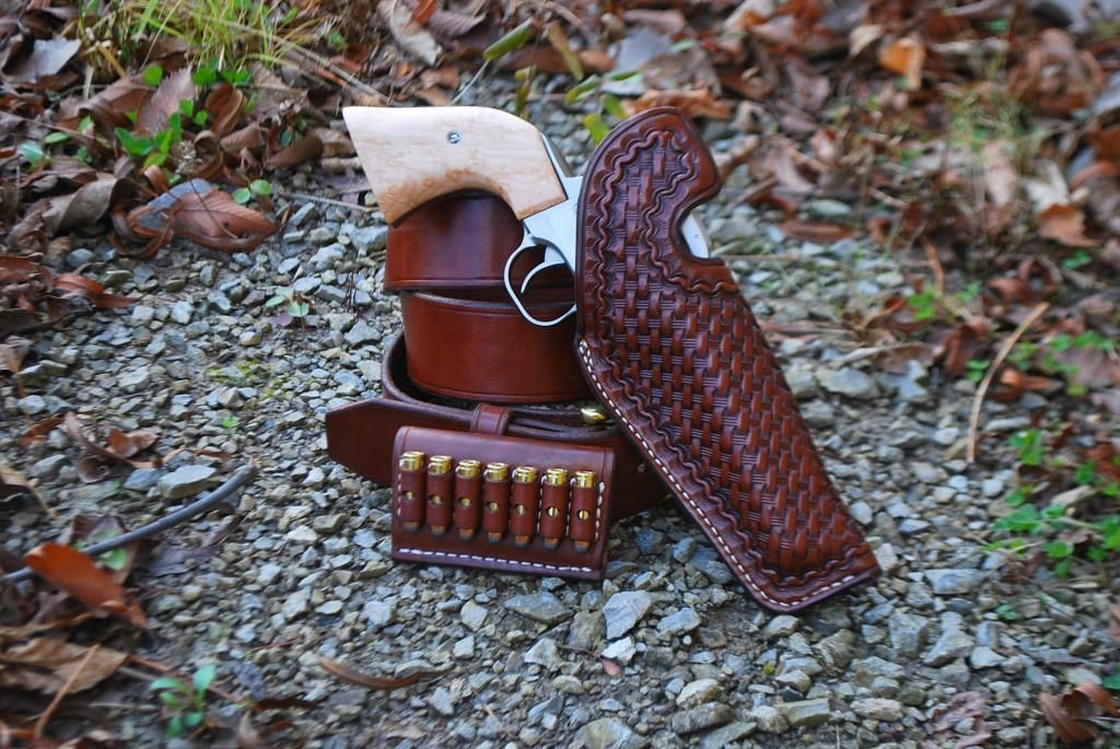

I have made many with Sam Browne studs but the problem here is that it limits the holster to the amount of guns it will securely carry. For instance this one pictured below will only fit this Tokarov. From a makers standpoint it also has its problems. What if the customer has different grips than your model? The last few I did for customers I sent them the strap with the hole precut and the rivet and instructions on how to install the rivet so that th ae strap was right. I no longer offer the stud as an option. Buckle only. I really don't like snaps. And for the perceived use of this holster (riding in very rough country) I don't trust them. Ken I made this one to have the butt cant towards the rear. I've had others canted forward where the holster would rub on the cantle (back of the seat) of my saddle. This works better for this app.
On my flap holsters the cant can be adjusted through the loop placement on the backside of the holster. For more adjustment you can make the slot 2.75" instead of 2" and I use a 5" strap for the loop. Then the end user can adjust the cant for what is comfortable for them. Here is a pic of a friend with her Rangeflap for her Ruger Bearcat carried crossdraw. Same holster carried on the strongside can be carried straight up or down or slightly forward or to the rear as desired.
This shot shows the belt arrangement that allows that.
That loop can be riveted on up or down for different applications. Most of the time I will have the top of the loop even with the top of the slot.
So I believe that cant of the holster becomes a personal thing, its what is comfortable for the end user. This arrangement on the flap holster does provide some adjustability.
Those 1911 holsters do cant forward some. But they are for a different purpose, not horseback so much. I have made many Rangeflap holsters for 1911s too for those that do want to carry that gun horseback.

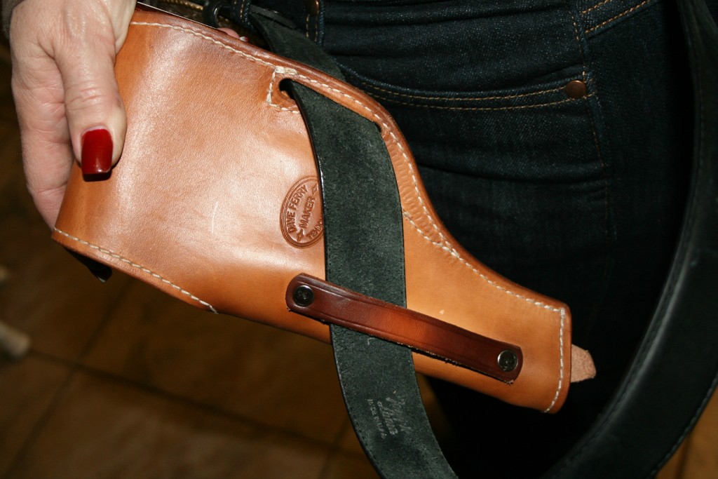

Ken the early 1911 holster with the strap, thats called a "breaktop' holster. Yes it does work off a snap. The snap is opened by pushing straight down with the thumb when grasping the butt for the draw. Here is the front and backside of one I made for a Ruger GP101 in .327 mag.
The thumb tab for the snap is two layers of leather skived to zero at the bottom. This is necessary to provide the stiffness required to draw the gun as described. On the strap that comes over the hammer there is a light piece of chap leather sewn on to cover the back of the snap and protect the guns finish

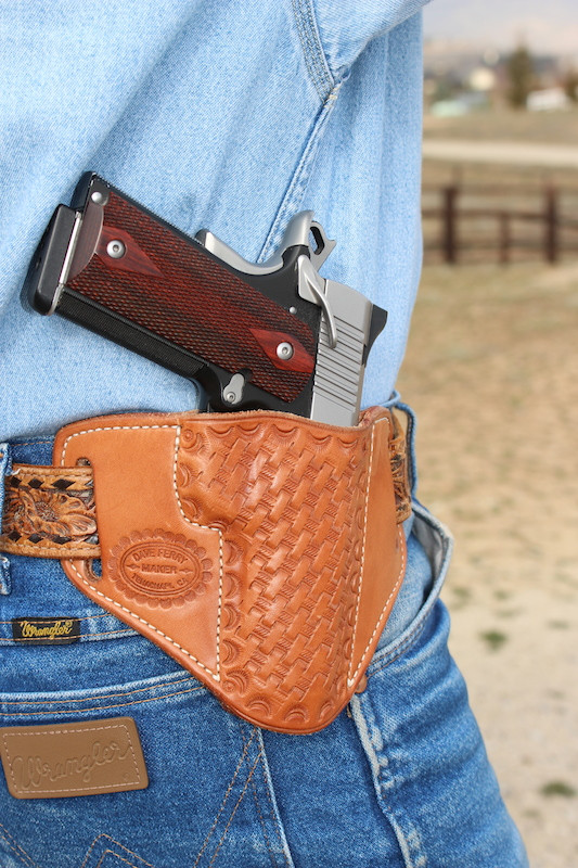

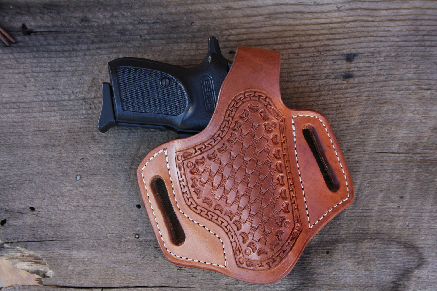

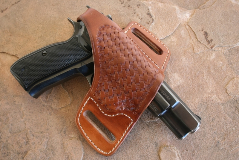

On my gear I make most of it for concealment so fit is important, both gun in holster and holster to belt. Retention of the holster itself usually negates any need for an additional retention device. This simple pancake design features a forward "FBI Can't" which equates to anywhere between 15-25* forward depending who you ask. I have a custom die made for belt slots but a punch and chisel/knife can achieve the same results.
Holster style is most easily accessed by what the customer wants, what his intended use is, and how much he wants to pay you for it. This is an example of a modified Bruce Nelson Professional pattern for a 5" 1911. The customer needs a holster that puts the belt behind the slide. Due to body type a pancake sucks the gun in too tight for him to draw from the holster.
If your feeling really brave a little elephant makes a really nice wearing rig. This is an example of a modified pancake pattern, the smooth front keeps your cover garment from snagging/binding and increasing printing.
My preferred method of construction also uses two laminated layers of veg tan. Smooth interior gives a good draw, better fit than an equivalent single, and it's easier to maintain without gathering trash like some materials. Stay away from non veg tan leathers as the salts can react with your customers gun and leave you with mud on your face. Some customers get overly aggressive on special linings to negate wear. The #1 thing to decrease wear is a proper fit. Movement in the 'pocket' will wear on a guns finish.

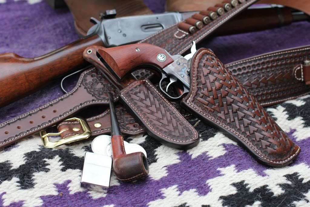

If it is a single six there are a lot of options - one of the most popular I offer is the basic Tom Threespersons' design. This one is riding on a belt with web loops so you can leave them loaded without corrosion.

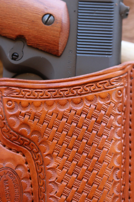

Detail shot on the tooling on a 1911 holster.

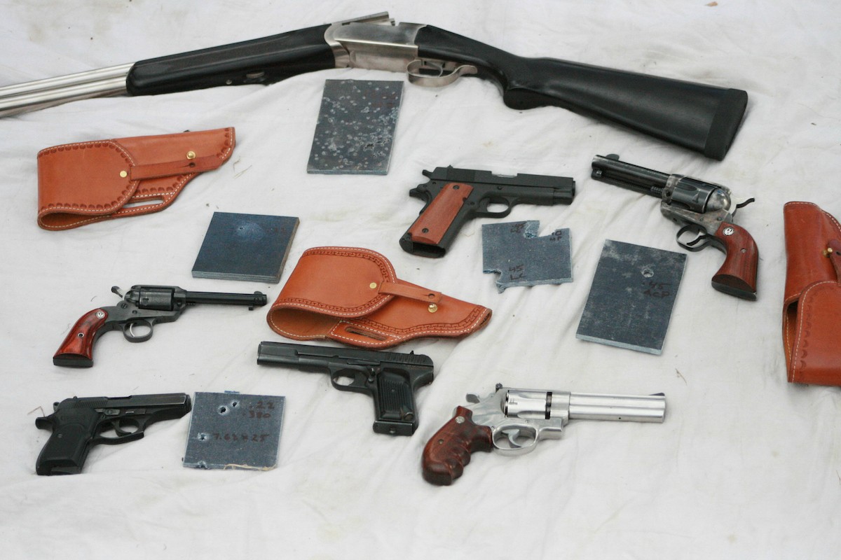

My brother and I were bored one Thanksgiving morning. Dinner wasn't till later. I'd already sharpened all the kitchen knives the cooks were gonna need. So we went out to the ranch to see how bulletproof micarta really is.
All shooting was at 10 yards. It did stop the 12 ga with bird shot and a 3/8" piece would stop a .22 (1/4" piece didn't). All other rounds would penetrate easily but took multiple hits to blow out chunks of the micarta such as in the piece under the 1911. Valuable scientific info here.

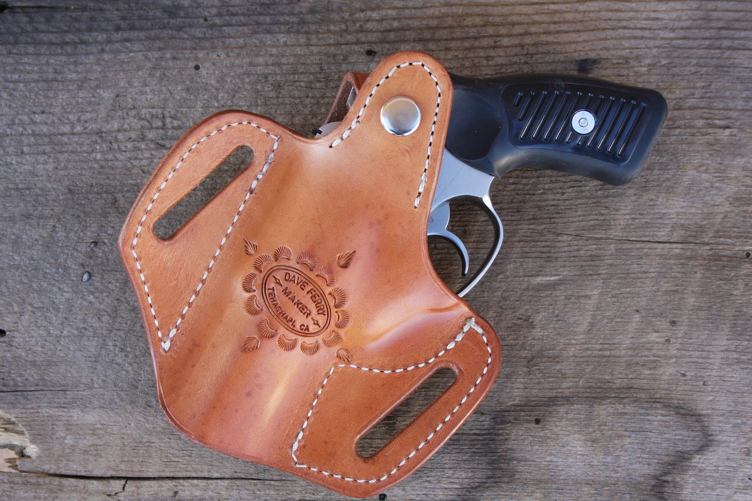

Here's one I grab more often than most. Wears well over a jacket during hunting season.
This is still my most popular for the wheel guns. I'm a fan of it myself too.
First off Id like to say " Wow " about everything you showed in your post .
But if I can sidetrack this thread for a brief moment , I'd like to ask about your pipe .
Is it leather covered ?
If so I've never seen that done before .
I'm a pipe smoker myself and that pipe in combination with that fantastic leather work has made my day .

Ken, thanks for the kind words. I can't say any more about the pipe other than yes it is leather covered, your not the first to comment on it specifically, and I have no details of it other than that. It belonged to my wife's late grandfather and lives with his grandson. Try and borrow different things for props when the event calls for such a thing.
