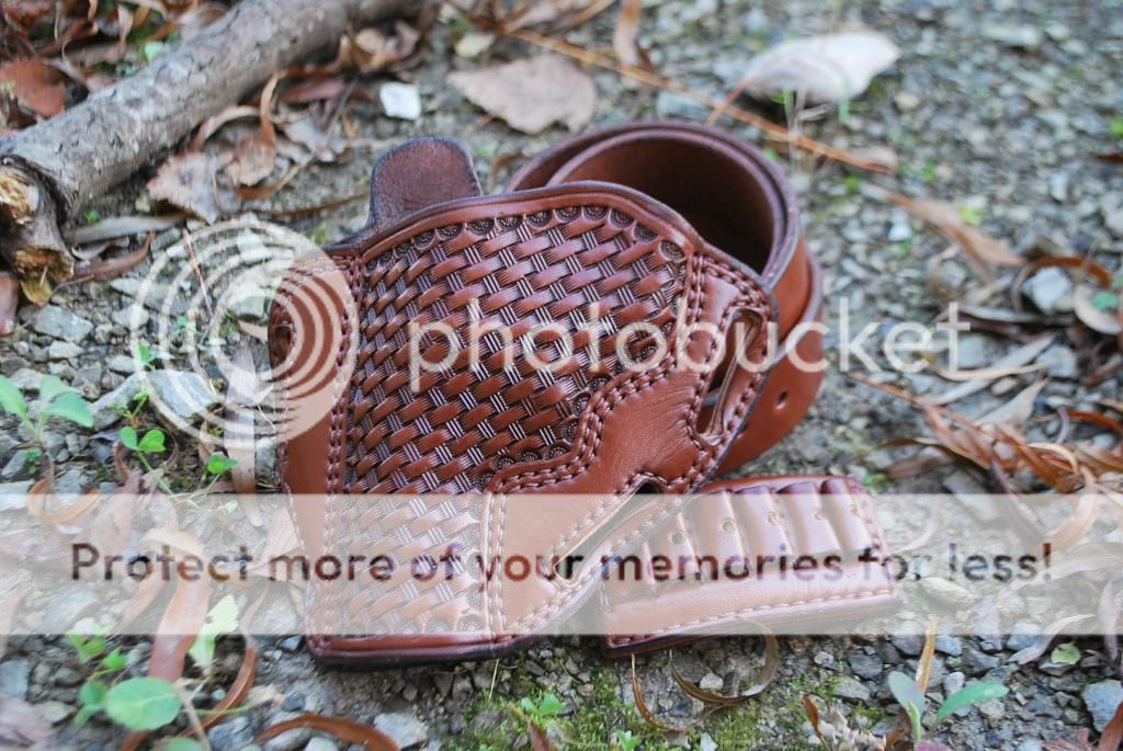

Eagle, wow my friend beautiful stuff there! Just beatiful. I have avoided, with great intensity, (and have turned down numerous requests) making cartirdge belts and or slides. Someday I shall try one. Whats the light wood on the grips birch or maple? I am also digging the saddle blanket.

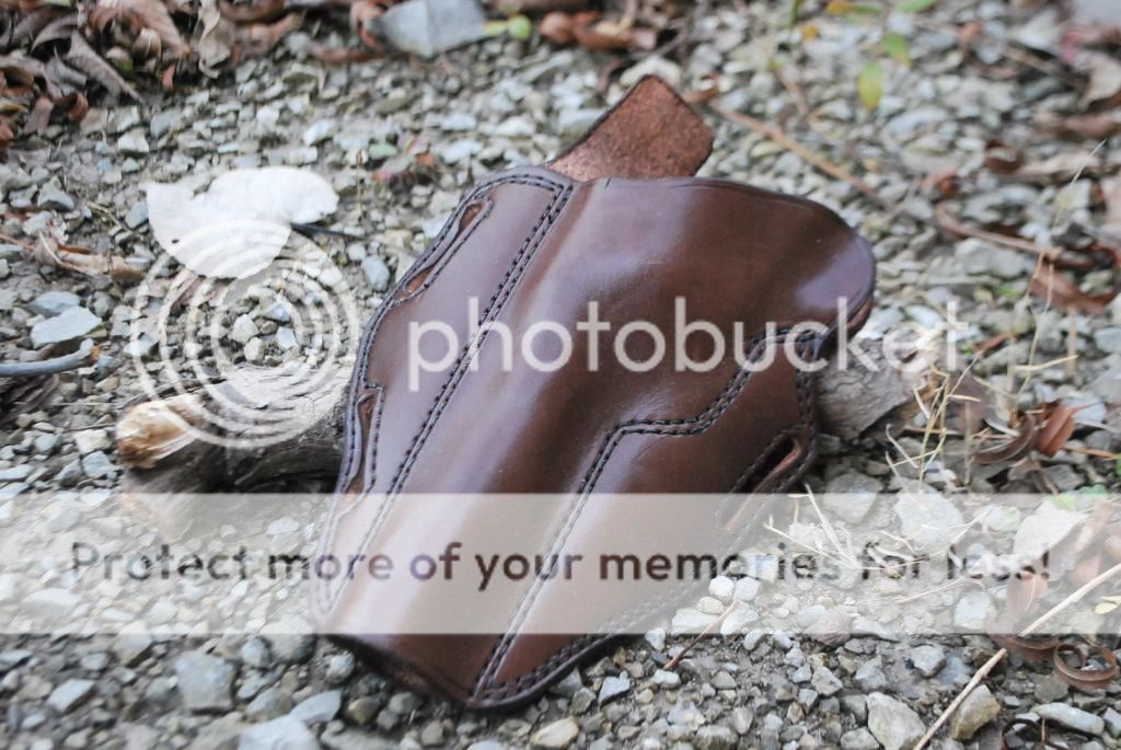

Three tips I've learned doing that Carlos border stamp over the years, I might pass on if someone is interested:
1) Your pattern needs to start and stop somewhere. Plan that out. Also, it doesn't go around acute corners very well, sweeping curves great, sharp curves not so much.
2) On the swivel knife cuts, cut away from both sides of a corner if that makees sense. It opens the corner up equally and keeps it looking right.
3)After you are done (and after wet molding on a sheath or holster), run your stylus point along the swivel knife cuts and re open them up. This is relatively new trick for me and I see both of those examples (1911 holster detail shot and mt holster for my Bersa) would have benefitted from this.
