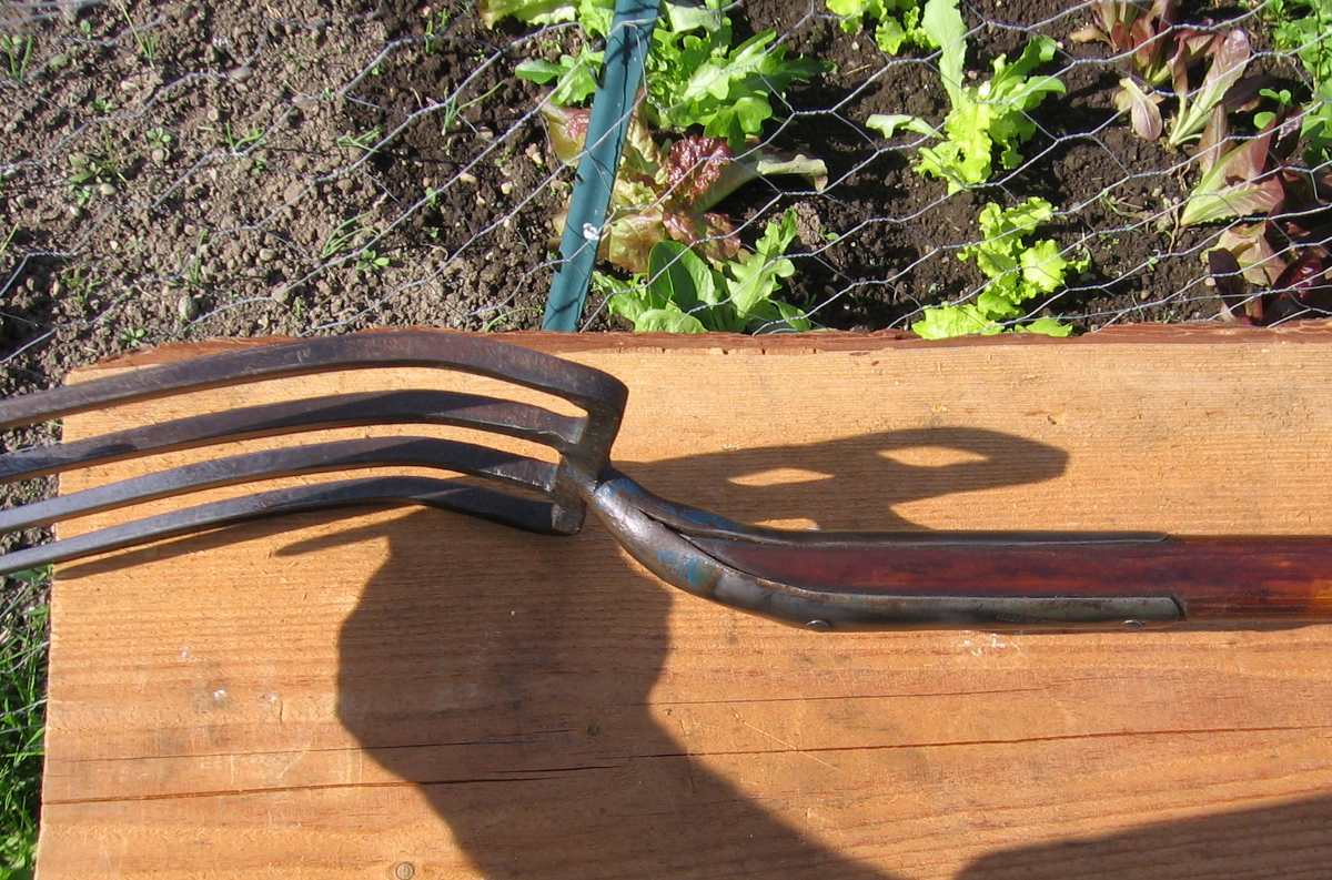

I mostly use my hay fork for mulch. For a mulch fork your want 4-6 tines with 5 times being the sweet spot. A long handle is better. This one is a smidge over 6' tall.
A fork forged from a single piece of steel will have a telltale sign, the base of the forks will be thicker in the center and get smaller as the tines branch off. This is the normal result of forging a fork.
Digging forks should also be forged out of a single piece of steel.
There are also cultivating forks.
