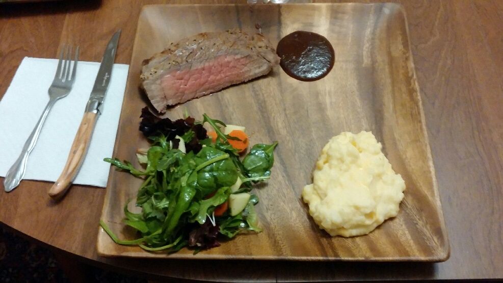

I was tired of using serrated knives to cut my food. So I simply got more knife friendly dinner plates.
:thumbup: Nice wooden plate & yum looking steak! These wood plates would work for meal-prep vegies and fruits too, except they are not dish washer friendly.

Colog, man I laughed hard when I saw your dinner plates. I whole heartedly approve of your dinnerware. What kind of knife is that though? A Laguiole?

Yes, my girlfriend gave me a set of Laguiole knives from Williams-Sonoma. They're ok. Came dull, but I fixed that. My kids laughed too the first time I broke out the plates. But they've been a huge hit since. They all love using the razor sharp blades.
