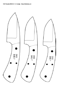

Allright. Well, yer' not getting sketches to start with, so much as an already made template, courtesy of D Comeau Custom Knives, since they're open for people to use. Because I know full well that I -don't- know enough to design a great knife to begin with, especially since almost all the knives I've had experience with are realllly crappy cheapo knives.
Still, after working at it, I've narrowed down to three designs that interest me most.
DH13
DS3
DH52
Each of 'em have have some curve to the handle, and a design that I feel will help keep my fingers where they belong and -off- the knife blade in case of my grip slipping. Because knife fumbling happens. I'm not sure which of the three will be the easiest to make the blade on though, particularly in beveling it correctly and then sharpening. I expect the DH13 would liikely be the easiest one, as well as easiest in handle design, but not sure.
As for my plan, assuming 'how do I plan to make it'.. Plan is to print out a piece to the right size to give me a 3" blade (to keep me solidly under any variant of the fun knife laws in various parts of michigan for an openly carried knife), grab some scrap wood and glue it down. Saw cut that out, then file down to size, then drill it.
Get the steel bar, measure it to the size of my knife +1/2", hacksaw that length off. Then go over it with the file a bit to take the scale off, then onto the granite with the sandpaper over it in a rough grit, and get it leveled out. Then the template goes onto that, gets clamped, because I'm not going to trust myself not to nudge things out of position, and marked onto the steel. Then on to clamping the steel and hacksawing the heck out of it to get a basic rough shape, playing it safe and expecting to do a lot more filing, rather than chancing an 'oops' that cuts into the planned knife shape. _Might_ change up the order and cut out the knife shape first, then level it down, but then I'd have to redraw things and hope I line things up a second time, which seems.. not great a plan for my first time!
Clamp and settle in for quite a bit of filing, to get things down to the basic outline and finished blank. Probably have to pick up the half round bastard to work in some of the handle shape, and a fresh needle file to replace some of the set I've used this past year in my chainmaille work.
I've got more video watching to do on filing technique for the bevels, though I -think- I've got the gist of it. But more videos and careful watching sure isn't going to do me any harm! May end up picking up a scriber, or may end up just marking with ultra-fine sharpy to get my mid-point line. Not entirely sure on that still.
