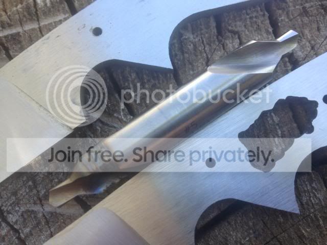

I could not believe that I can't drill holes in annealed S35VN. Completely destroyed a new center bit in 3 holes, and I was using a mister. Broke a carbide bit just as easily.

SteelSlaver, I tried drilling the end of the full tang, so no work hardening, and absolutely no thermal input. I should post a picture of the bit. I've never seen a more completely destroyed bit out of many hundreds I've gone through.
I figured it wouldn't be easy, so I set up the mister with good coolant/lube added before I drilled a single hole.
The S35VN completely ATE the bit! As I drilled the first hole, I was tuning the speed of the press, and about 700 RPMs with a 1/2" center bit looked ok... at least for the first hole.

A center drill doesn't cut very well. 700 RPM is too fast for a 1/2" drill in this material.
A better suited drill turning an appropriate speed and fed properly can cut it.
Try a USA made 1/4" split point drill turning 500-600 RPM and fed hard enough to keep a curl coming out of the hole and reduce feed pressure as the point exits the back of the work.
Be warned, under feeding a drill in material like this leads to rapid wear and work hardening.

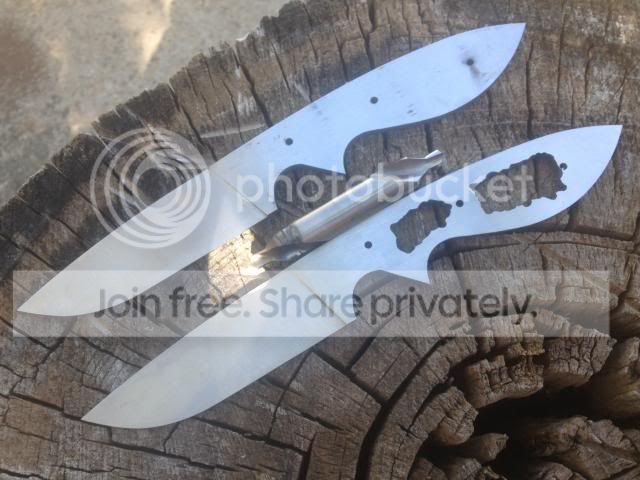

I didn't hear anyone against it, so I went ahead and skeletonized the tangs with the plas.
I must say I was very pleasantly surprised. It probably took 15 seconds to move from blade to blade. I skeletonized the whole tang in less time than it took to drill one hole. Warpage was very minimal, and the blades never got warm enough to handle without gloves.
It made a big difference in the balance and feel of the blade. Moved the balance point about 5/16" forward.
I hope to remember to take a couple pictures so you can see the difference. Truing the tang on the belt grinder went almost as well. I didn't spend a minute per blade.
IMHO, it worked very well.

I didn't think the skeletonizing needed to be pretty, so I get no points for that. It was fast and IMHO, very effective. They all came out similarly.
I don't know if you can make out the center bit, but I've never seen one so thoroughly destroyed. It was a high quality bit too.
Nathan, I hope you don't mind if I ask you before I need to do drill an inordinary hole again. I can see that you were exactly right. I have a couple of good machinist friends, but they've never heard of S35VN. :thumbup:
That bit was chewed up because it is HSS that you heated to the point where it was softened. If you are seeing chips any darker than straw with HSS tooling, you are getting too hot. With carbide mills even fairly dark blue is ok, but you are trying to cut soft tool steel with tool steel that you have softened.
One other thing to keep in mind is that a center drill is only intended to start and chamfer a hole. Using the the full diameter for a drilling operation goes well beyond that.
