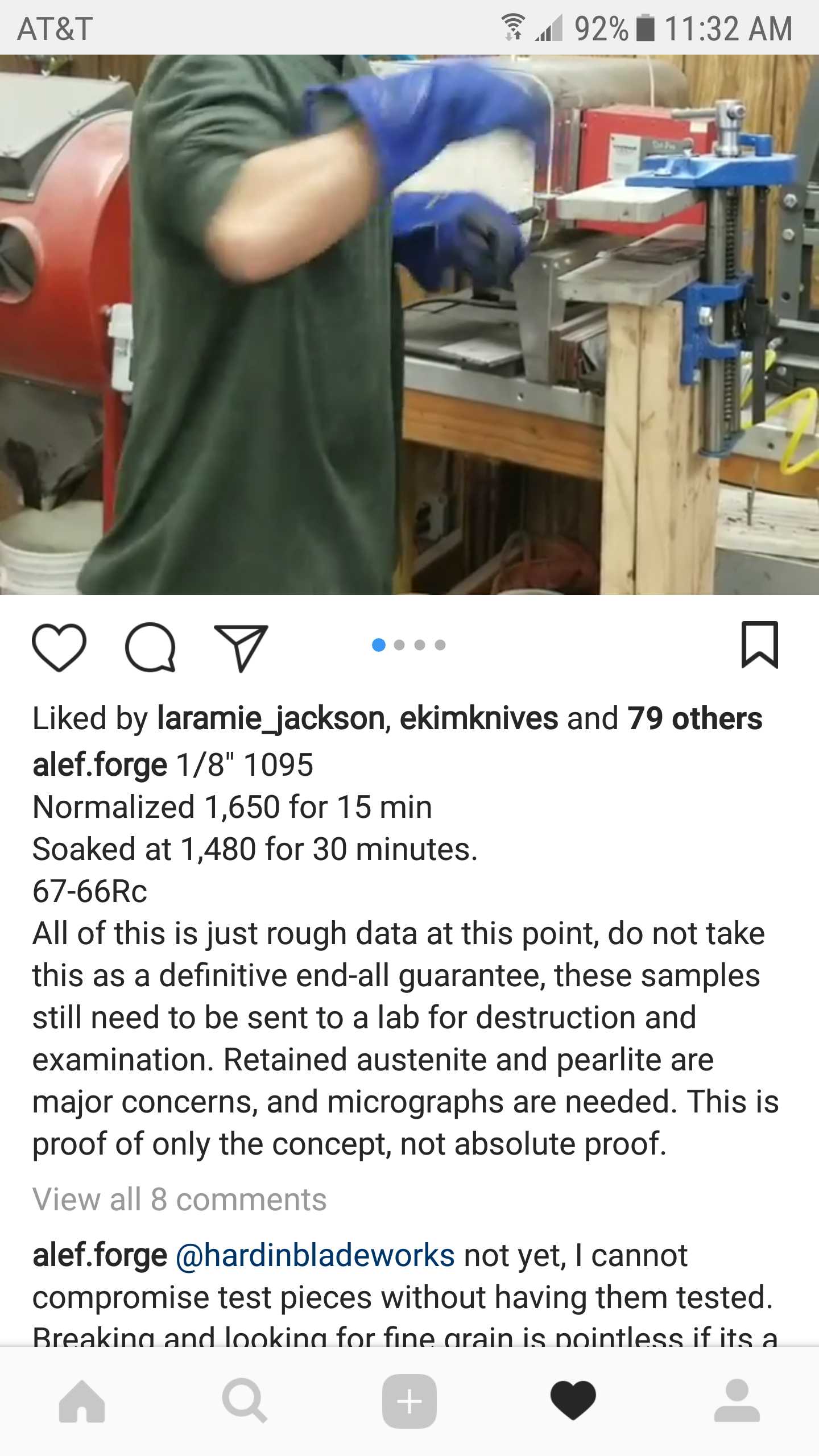

So I follow a gentleman named Edward Braun aka ALEF forge. He's been testing plate quench as an oil alternative. I thought it was just for hypereuctoid steels but he said it's for everything. Anyway he's been getting some crazy high hardness. 67 from 1095 and about the same out of 52100.
These needed to get tested in a lab obviously and this is just preliminary stuff but I thought it was VERY interesting. What do you think?
plate quench is usually for air hardening steels like A2 or D2 or 440C. I have used it successfully with very thin, 1/32", O1 but have not tried on thicker stock. I guess if you had liquid cooled quench plates it might work, but building and maintaining quench plates like that would be a lot more trouble than maintaining a 5 gallon bucket of canola or commercial quench oil. see if he will tell you his HT procedure to get these results, if he says no, trade secret, run away quickly
Haha I'm not THAT gullible now Scott. This is a screen shot of one of the posts and he also has a video of the plate quench then another of the actual rc test. I believe he's up at NJSB doin these tests but i could be wrong.

I think that's the key. Ed and I have talked, and I have no doubts he's getting that hardness. However I have my doubts its anything but a party trick. The fact that without growing the grain it hardened to the mid 40s doesn't inspire confidence.
In my testing the best performing blades have the finest grain. Grain refining reduces harden-ability. If you have to increase grain size in a steel like 1095 to harden in a plate quench, you might be going in the wrong direction. For me it would be more trouble to plate quench & much easier to just oil quench a blade?
for thin O1 blades, 1/16" or less, I have had good luck quench in oil till black then between quench plates to room temperature. i also agree that enlarging the grain with the long soak at 1650* and very long soak at 1480* combined with much higher levels of retained austenite that these temperatures cause will not give best result for a blade.

And I really don't know how he's going to get good grain structure from 1095. It's nose is something like 1 sec? I don't see how he is avoiding getting pearlite
1095 is a shallow hardening steel, so did the 1095 1/8" thick blade cross section fully hardened? Easy to surface grind and hrc test at 0.04" & 0.06" depths - this test the 'shallow' part. If 0.06" depth read below 63rc(case hardened), then near center/core isn't optimal for edge (maybe ok for single/chisel bevel edge). If 0.06" read 65+rc, slowly bend away from ground surface (stretch core, compress skin) until blade fracture/split. Check for evidence of plastic-flow (stretched/elongated) - if exists, then it has mixed phrase microstructure (pearlite+mart+bainite+etc.), which not optimal(after tempered) for edge tools. If highly intergranular fractured, easy to see fractured-grain size.
