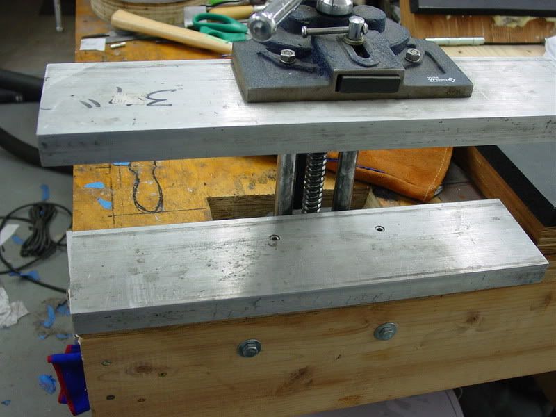

Here's my set up. Plates are 1" thick 6" X 16".
-John
Thanks guys! John your pic gave me a little inspiration! I bought a Wilton vise like that one on closeout at Lowe's and never got around to mounting it on my work bench. With a 6" width have you tried to quench more than one at a time? Or would that be more heat than the aluminum could transfer effectively?
I've done two at a time on my 6-8" plates with no problems. You do have to be careful
to quickly lay the foil packages out so that they don't overlap.
