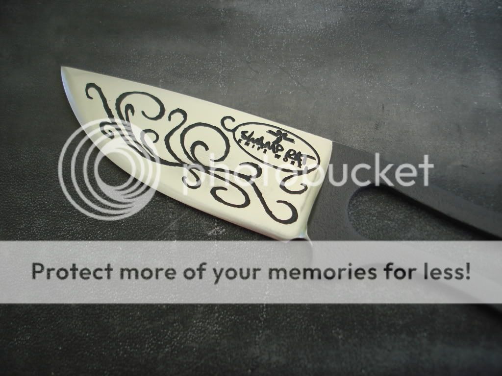

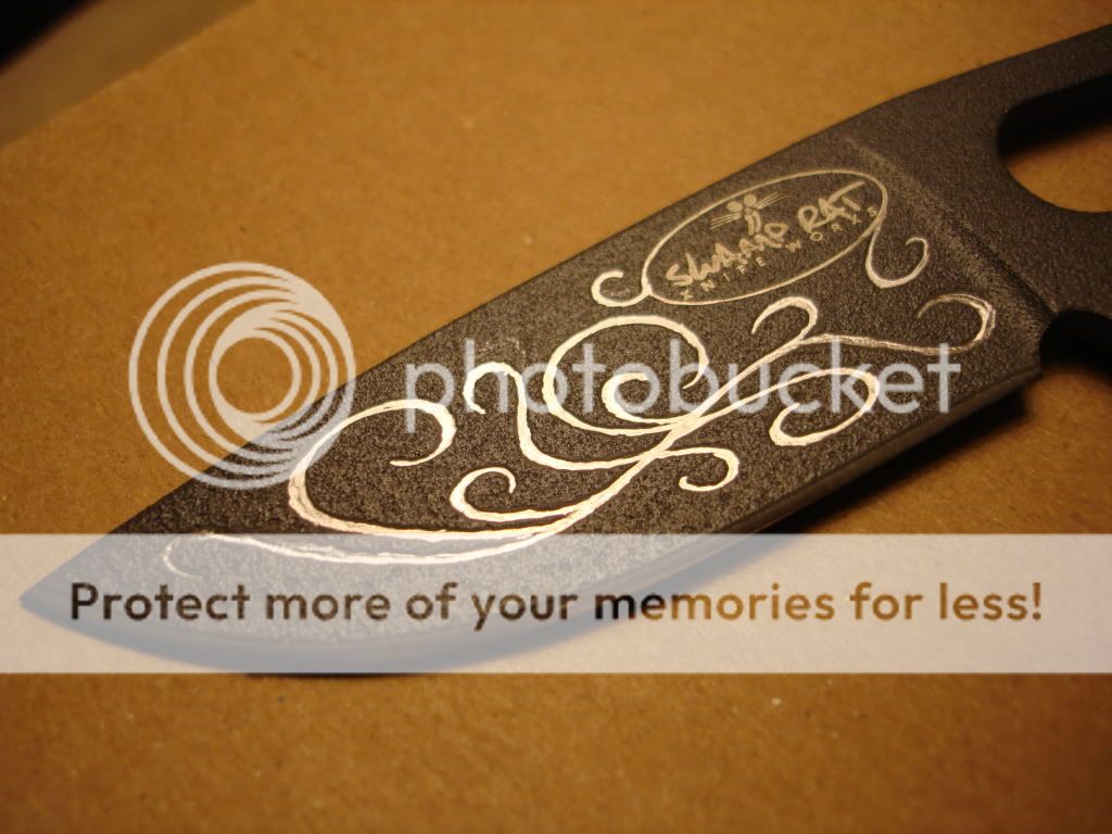

Had an extra Swamprat Swamp Warden laying around and decided I wanted to experiment on it. (I like messing around modding knives) So I got out my dremel and used an etching bit to freehand some scroll desing on the blade:
Then I covered up the edge, soaked it in liquid etchant for about a day, and decided to try out my new beltsander to strip off the factory coating...
I did some jimping and rounded the spine while I was at it...
Not the prettiest, haha... but I'm still learning this proccess! There were some irregularities in the blade that I couldn't completely get out, but using the sander was a fun learning experience! I still have a LOT to learn when it comes to doing this stuff but it's fun trying stuff out!
I want to get ahold of some micarta or something now and try to make some handle scales for it when I get a chance. Then I'll need a new sheeth since it won't fit either of the two I have any more. :)
Thanks for looking!

I like your scrollwork. I think it would be easier if you sanded off the coating first, then cover the blade with a resist and carve your scrollwork into (out of?) that. Lots easier than doing it with a dremel. But, wow, what a steady hand you have!
Thanks, The factory coating already makes a great resist, it dosen't flake off as easy as any resist I could apply myself, so no need to sand it off first.
The dremel is a bit large to use like a pen, but I wasn't sure about what else to use to carve in the designs? Any ideas on that?
Other than an engraver, no. My thought was that a more traditional resist would be easier to work with and you wouldn't need to use the dremel.
