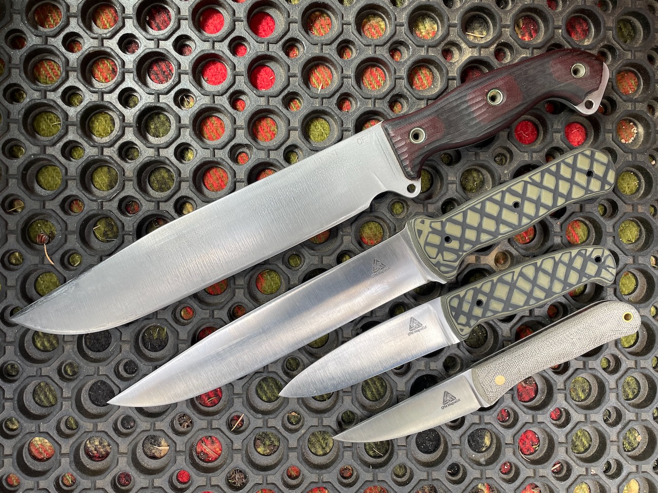

I have four customs in Magnacut, with another two on order. All from David Mary David Mary . Here's three of them with a Bushwacker Mistress:
MagnaCut is awesome. It's like elmax but tougher and more stainless.... and edge holding is comparable. IMO it's Elmax but better. Which doesn't make Elmax bad, it's still awesome. But if you love Elmax, why wouldn't you want elmax but with increased toughness and stain resistance?
My current personal preference for a 'knife combo' is INFI in big / hard use knives, and MagnaCut in small / sharp knives.
My thoughts on why Magnacut is worth considering, even for those whose favorite steel is INFI:
- The obvious reasons are the increased stainlessness and edge-holding. Magnacut is almost stain-proof (it is at the low end of 'saltwater steel,' close to H1 / vanax / LC200N). It's edge-holding is ballpark on par with 4V, elmax, m390, vanax, etc.
- It is the toughest of the high-edge-holding stainless steels, by a fair bit. Give Bussekin are all about toughness, this should get any Hog / Dog / Rat's attention. There are videos of makers testing magnacut - e.g. Shawn (BBB handmade knives) - doing things like cutting through steel bolts with minor damage.
- I like Magnacut in knives that I want to be SHARP. The very fine structure of the steel and high toughness mean you can get very thin edges that are still stable. I don't like to do that to INFI because at that thinness, it loses a lot of the benefits of its legendary toughness. A super thin edge in INFI will warp or roll. I think Jerry has said something in the past about INFI not being the best steel for super thin edges.
It isn't as expensive as exotic steels (e.g. vanax, LC200N) but it isn't cheap either. You can only get it currently through limited Spyderco runs or custom makers, as far as I know. But it's a new steel, so it's becoming more widely available as time goes on and, given the interest in it from large companies, I'd bet it will become pretty common in the future.
If I could only have two steels for knives, it would be INFI and Magnacut.
If Busse developed a custom heat treat and produced some thin-behind-the-edge sharp knives in Magnacut, I'd be over the moon.
Check out the thread https://www.bladeforums.com/threads/cpm-magnacut-–-the-next-breakthrough-in-knife-steel.1782546/ and Larrin's article https://knifesteelnerds.com/2021/03/25/cpm-magnacut/ for more info, including on testing.
