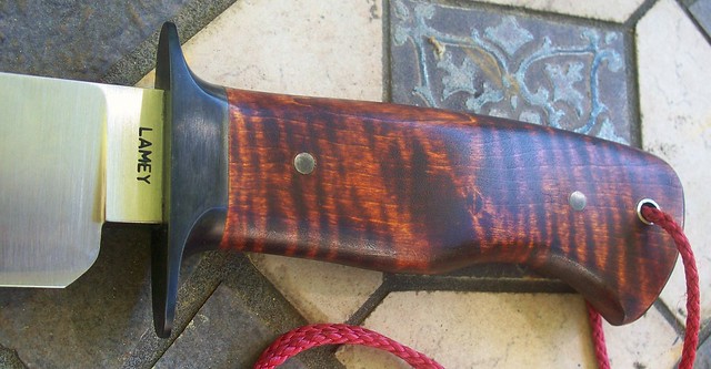

I had built this for myself, but decided to built me one a bit lighter for daily carry.
This one is forged from 3/8" thick 1095FG (1095 with added vanadium). Blade is 10" x 1-7/8" wide, 3/8" thick at spine. Clip is sharp, convex edge. Working "belt" finish, a few forge pits here and there. Guard is blued low carbon, so are the pins, handle is Curly Maple with a "matte" grippy finish.
Differential heat treat by watching "zones", you can see a temperline but I didnt etch/polish to show it. Triple temper wich with this batch of 1095 really works great.
Did a bunch of bamboo cutting yesturday with it, was pleasantly surprised how well it cut even with my modest cutting skills. Consistently cut "clean" through 1-3/4"+ bamboo, also did some "twists" in mid cut to really test the edge, no chips, rolls etc.... still shaved after cutting about 3X what you see in the photo below.
