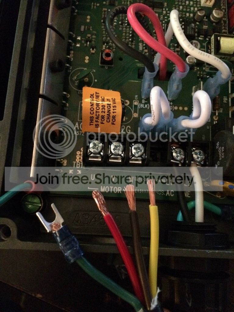

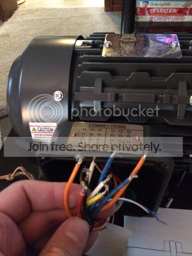

I connected the power cord (the one with prongs on the end) with 3 wires (Green, Black, White) inside the VFD. I connected Black to L1, White to L2, and Green to the green screw. Is this correct?

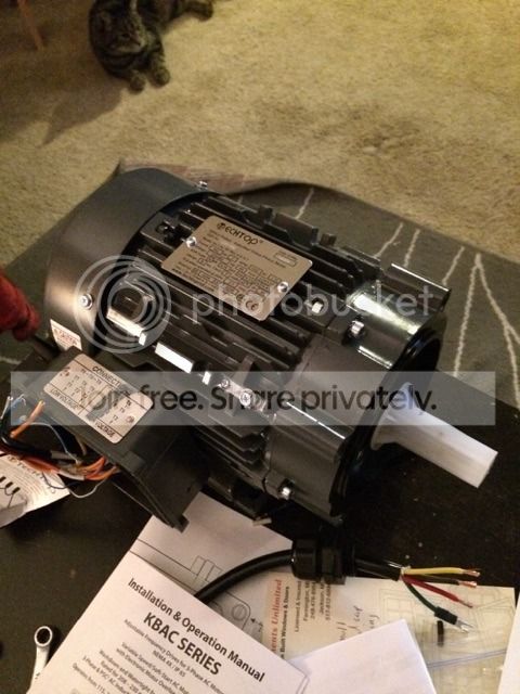

2. I have another cord (2ft long) to connect the VFD to the motor. It has 4 wires on each end. They are Green, Yellow, Brown, and Red. These I'm assuming need to be connected to the 3 screws shown in below picture (Green I know should go to green ground screw). The screws are labeled U V W, which color wire goes to which letter screw??
IMG[]IMG

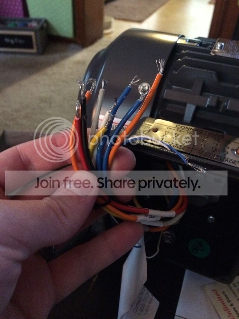

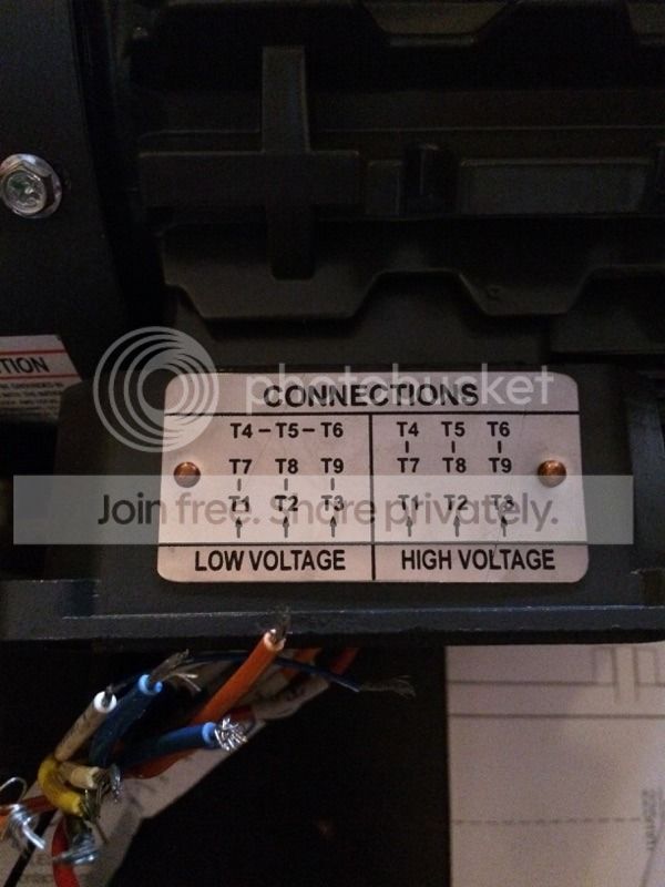

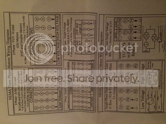

3. The other end of that cord (with the Green, Yellow, Brown, Red wires) needs to go to the motor. There are 9 numbered wires T1-T9, I know they get connected per the diagram on the motor. So for example T1 & T7 get connected along with one of the wires on the connecting cord using a wire nut. But what color wire gets connected to that combination of T#'s? The diagram says T1&T7 T2&T8 T3&T9 and then T4,5,6 go with eachother. But for the combination of two T wires, which color from the cord gets added?

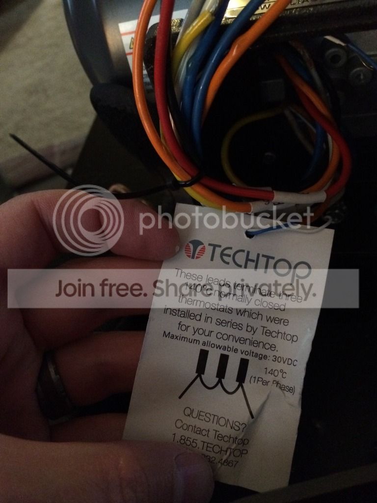

4. In the last pic you'll see a tag attached to two smaller diameter wires. It says these leads terminate three 140C normally closed thermostats. My question is what do I do with those wires? The ends are bare exposed wire, do I just leave them like that?

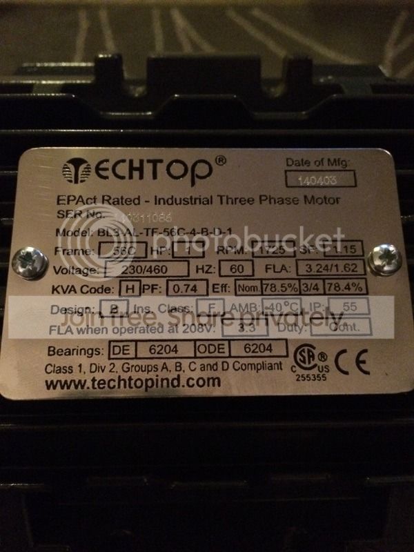

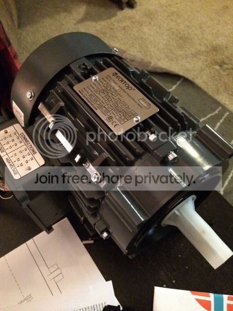

The answer to any how do I wire this motor = Show really good photos of all the motor data plates

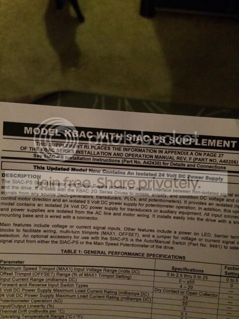

What make and model of the vfd is it and post the link to the manual
1 and 2,
It's ok what you have there, do it the way you show.
3
It doesn't matter which of the three wires from the vfd to the motor are which.
If it's going in the wrong direction, just swap any two wires.
Just hook up the motor correctly, use the right high / low voltage diagram
As for the others, let's see the motor plate photos

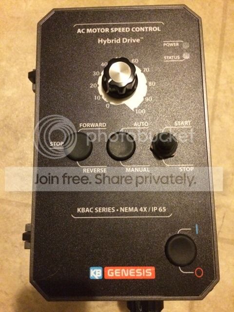

If it's for a disc sander, you need a foward rverse switch, let's see the manual, have you got a foward reverse jumper ?
make sure you set the 110-220 jumper
Thanks very much for the reply Count, I took more pictures and I'll include a link to the manual. The motor is a Techtop model BL3-AL-TF-56C-4-B-D-1 I'll include a pic of the plates also. Do the different color wires on the cord matter which T-number combination they get connected to?
Link to manual
http://www.essexbrownell.com/Catalog/00053689/CatalogDocuments/Datasheets/kbac_manual.pdf

You're going to use the low voltage chart
4-5-6 all connected together by themselves
1-7
2-8
3-9
Each of those gets one of the three wires from the vfd,
As I edited above, no order to which is which
If the motor is running the wrong way, just swap any two of the three wires.

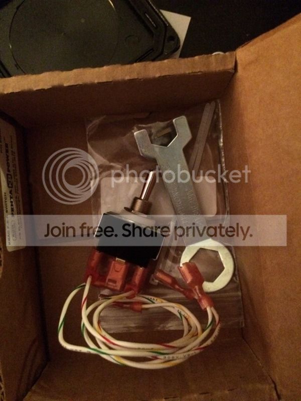

You're going to put that switch in place of the forward reverse jumper
It should all work after that.
But
That will have power running to it all the time.
Either unplug it when you finish, or you can use that 0-1 hole on the bottom for a power switch
Put a switch in line with the power cord before the connections you have now.
Thanks Count, okay so any colors from the VFD can go to the motor wires. I do have the forward reverse switch, I wasn't even going to mess with that until I get up the VFD connected but I'm sure Ill have a few questions. I did move one jumper from 230v to 115V. I'm not sure if there is a forward reverse jumper or not. There is one labeled "relay" with an F and R on the side, is that it?
All three wires of a three phase system are "hot" . The order that they are connected to the motor is unimportant. And as 12345678910 says, if the motor runs in the wrong direction. Swapping any two of those three wires will make the motor run the other direction.
Okay thank you both! I'll connect it and see if it works. One last question, do the two wires with the tag on them that says "These leads terminate three 140C normally closed thermostats" do those just stay bare/exposed inside the housing for the wires? Thanks again
I do have the forward reverse switch, I wasn't even going to mess with that until I get up the VFD connected but I'm not sure if there is a forward reverse jumper or not.
I have the two HP model, it looks like this
http://i1085.photobucket.com/albums/j422/TheCount12345678910/vfdfwdrevfootkbac27d-1.jpg
Look up the manual for that motor to see what you do with them, there's a web address on the motor plate.
I have no experience with that, but you never leave anything bare and exposed
As per the Counts advice, check with the supplier and don't leave the wires bare.
A lot of the industrial motors I come across have thermistors fitted in the windings. These are usually only suitable for low-voltage (the label usually says not to apply more than 5V when testing them). They are connected to a separate thermistor relay that is wired to cut the main power to the motor if the windings overheat.
If the thermistor relay is fitted on the plant, we obviously connect the thermistors. If the thermistor relay is not fitted, we don't connect it. They are most often fitted on biggish motors (20 HP and up), Hazardous-Area motors and motors used in dusty locations or locations with a high fire risk.
I'm in Europe and some things are done differently here, but I'd guess the thermostats are there to do the same job as the thermistors. If they are thermostats, they probably don't have the 5V limit of the thermistors. You should be safe just securing/insulating the ends.
