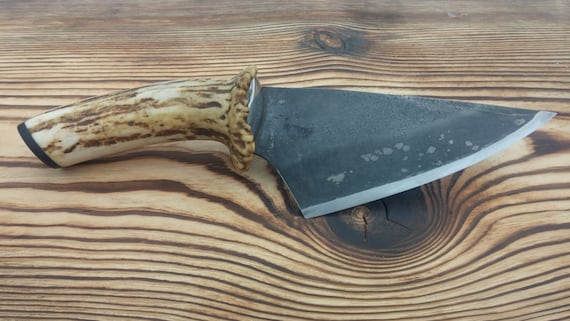

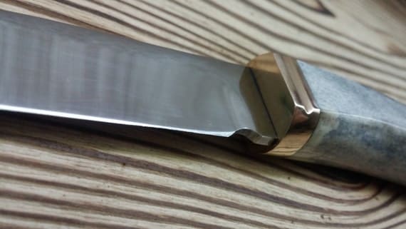

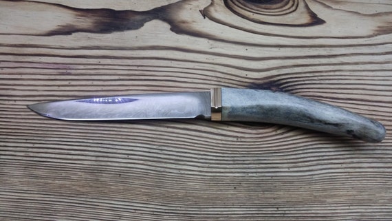

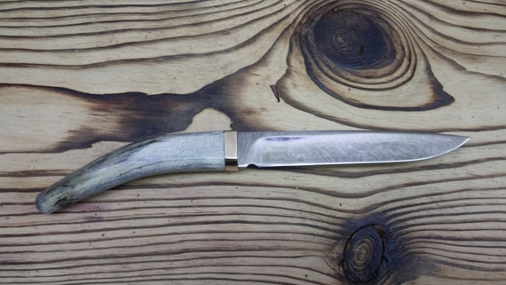

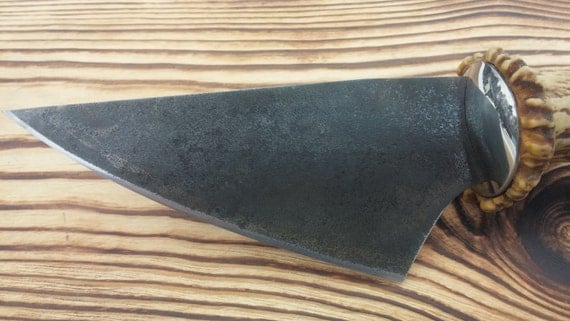

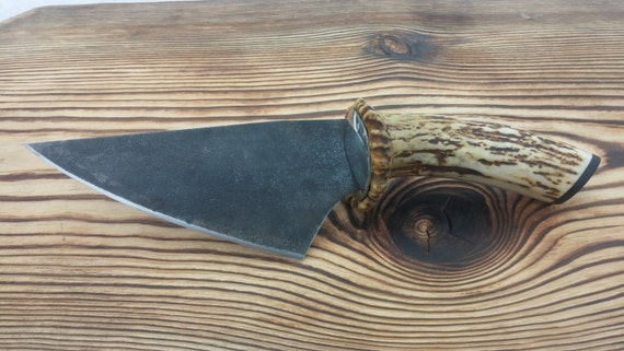

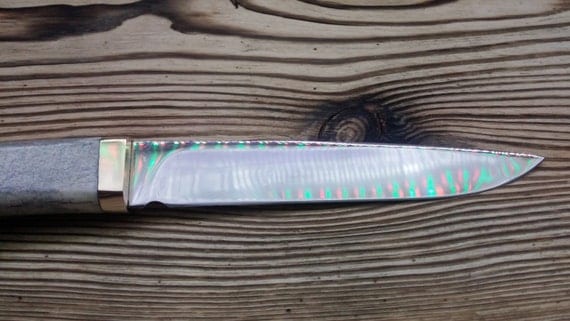

Hello, my brother is a blacksmith from Russia, he made this knive) What can you tell about his work? Foreign experts opinion is very interesting for us
Parametrs:
Overall length: 270 mm
Blade length: 145 mm
Blade width: 2.5 mm
Steel C75 forged + anodizing nitric acid
Handle maked from Deer horn, fully hand forged
Overall length: 222 mm
Blade length: 117mm
Total weight: 91 grams
Blade width: 1,8 mm
O7 Tool Steel UNS T31507 forged

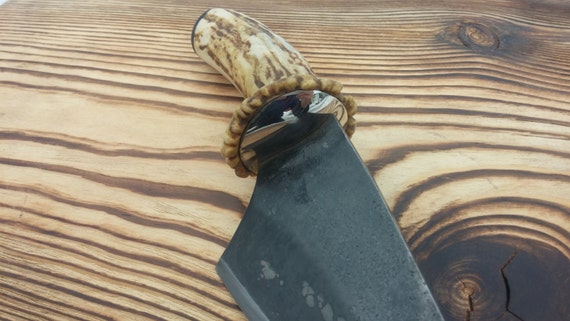

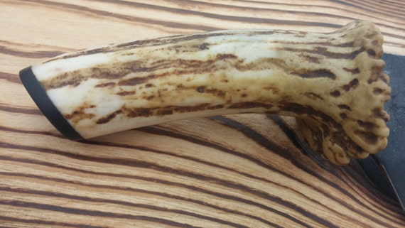

The blades look good. I think the larger knife with stag crown handle would have looked better with the crown at the end instead of at the front.
Note - I think the word you wanted for the dark finish was "etched" or "patinated", not anodized.
Thanks for Your opinion)
About etched or patinated, he made it more for steel protection, not only for decorate, but if You told what "etched","patinated" is more correct words, we will certainly take note of the Your comment

I like the look too. Eye catching, unique creative designs. Even the first one with the crown of the antler at the front of the handle instead of the back. It looks better than I would have expected. The only knife I'm not a fan of is the middle one in the last post. It seems too rustic for me. The rest really look good to me.
Have you thought about a small blade guard? I've sliced my hands a few times with puko styles knives with wet or bloody hands. I tend to be a little clumsy sometimes though
blade limiter("ограничитель" or "гарда" on russian)?
i don't know how it's correctly on English)
да. ограничитель is the closest word I can think of. In English we would call it a blade guard or just the guard.
And in terms of calling the blade "anodized" it has a very specific meaning in English. It means when you run electricity though a metal to build up an oxide coating. Metals like aluminum and titanium can be anodized. What your cousin did is called etching, it involves using an acid to do etch a new layer into the steel, and is not as strong or protective as anodizing.

I read description to "anodizing", i think what "black oxide" or "blackening" is more correctly(i hope wikipedia shouldn't lie:D)
Technical(specific) terminology in other language not so easy
We are from Ural, between the East European and West Siberian plains)
The flaws that were mentioned on the first cable blade are the cold shuts that run into to blade edge. You can see several of the non welded (cold shut) cable strands but the ones that cause problems go all the way to the edge. Forging perfect cable is difficult. Have him keep at it and it will come together eventually.
