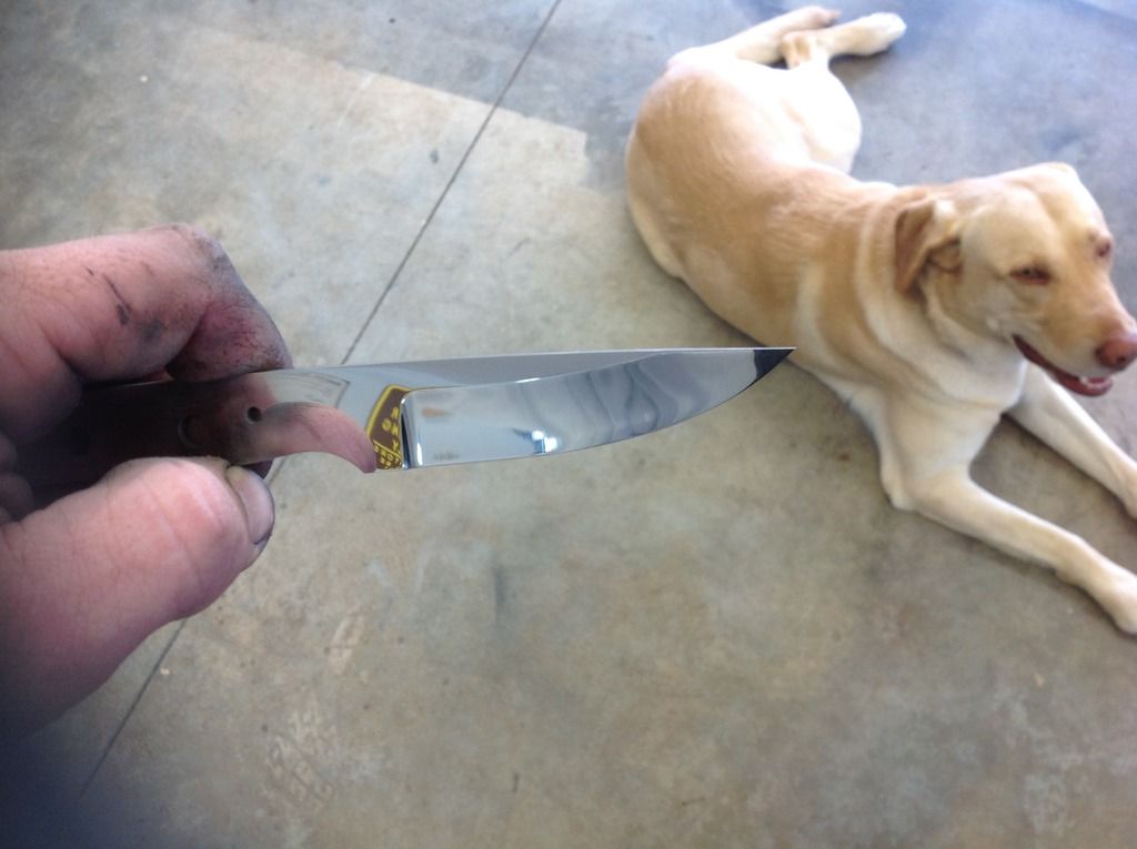

On a narrow single edge such as a folder, I like to use an 8" wheel.
PydHnhio9Igp-O1oBKgO2rSS3cPpUZ9zWaPxWgFXw2jYkcpLxZe5jLMpmxfRLzX  fHmTZ0no_7qcWpg=w1366-h768-rw-no
05I8LTbVzSjvE6xl5k_k4Of9Zjjgt9CE4E-rD4kbgwK0DIKx6TlkqmXpL9C-FZuU18mUY7OgH-aKIw=w1366-h768-rw-no
