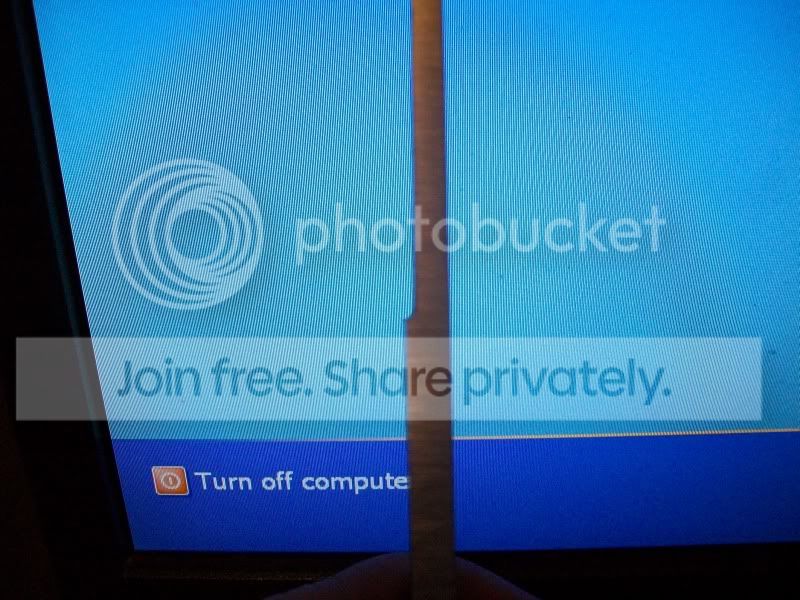

Just got my Coote set up, and this is the first blade that I have ground on it. It's my second attempt at bevel grinding so far. I was going for a Kephart styled thing here.

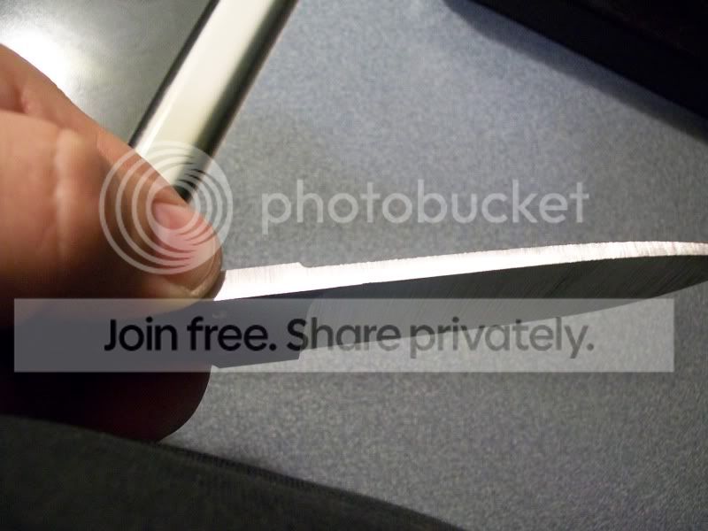

I'm pretty proud of one side of the blade....but the other one is breaking my heart at the moment. I have ground too far up and into the damn spine...
I have yet to work on my flats and I'm hoping that this will help take care of it. Looks pretty bad though.
Anyway....File 13 for this thing? Retire it as a pattern? Or keep going?
here's how high up I went....That 50 grit belt sure can eat some steel.
Epic fail?

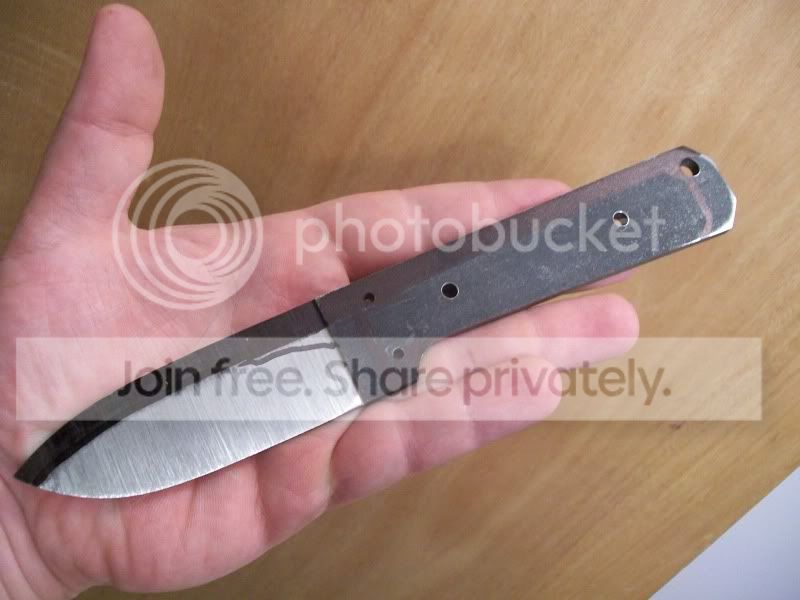

I've done that a few time. :rolleyes: I can see a couple options to salvage it. Not sure how grinding the tang works on a coote but if you can hold the piece vertically, you can thin the tang and regrind the bevel. You will have to have to sacrifice some of the width of the blade to get the grinds even though. It will end up being a wholly different knife but it could make a smaller edc type blade.
Had to do that myself last night. :p
I"m kinda drawing on it at the moment with a pencil to see what other style i could make.
damn. Already accepted it and traced the pattern. Maybe I'll try it again tomorrow. Just hate wasting a big piece of ats-34 like that.
The Coote is a world of difference compared to my old craftsman grinder. The platen is really large and flat. This is the first blade I've ground on it, so hopefully it's dead flat.
That sounds good actually.... be the same knife but not as wide. It would be easier to get the flats to help the bevels out too.
I'd have to re-work the handle a bit and maybe move the corby bolt placement a tad....i'll draw on it with a sharpie and see

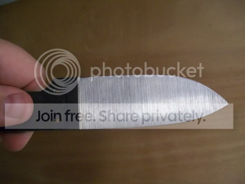

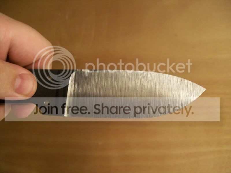

Here we go....essentially the same Kephart style I was going for, but slimmed down a bit. I'm kinda actually thinking this will be more practical and useful
you could do the same thing to the other side ...maybe, but then it might be too thin
It looks to me like it would be a pretty thin knife if you take the sides down far enough to make up for grinding through the spine. If you drop the spine down towards the edge the problem is just going to get worse because the grind is tapered down towards the edge.
