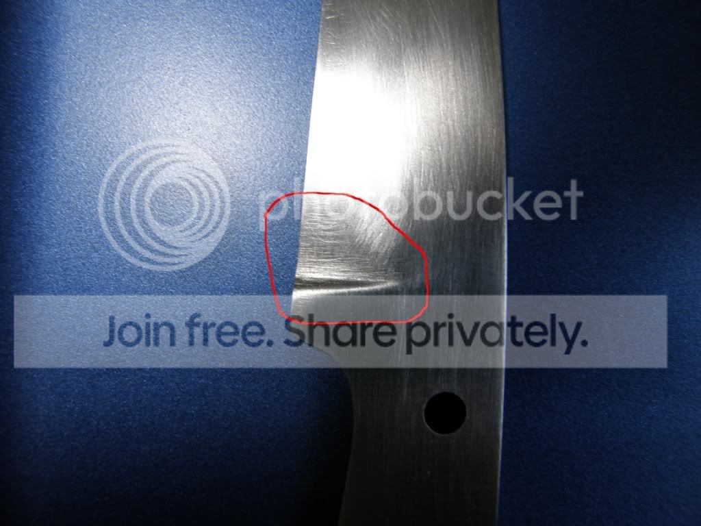

Hello and Happy Easter everyone! So I've been working on a knife for quite a while now due to school and such and I finally got to work on it some more during spring break. I've got pretty much everything I can do done pre-HT but the plunge cuts on my knife still have some scratches from the filing. I cant get in there with sandpaper. How would you get rid of them in this case?
By echo29, shot with SP560UZ at 2010-04-04
Yes, you can get in there. Make something (wood, plastic, metal, whatever) the shape you need to back the sandpaper with. The scratches on the Ricasso also show that you are not done sanding yet. Do it now before heat treat.
Don't be in too big of a hurry to get to the next step. Hand sanding does take time. That's why knifemakers aren't millionaires.
yes, don't worry, you can get them out like MadBug said, it won't even take that long in the grand scheme of things, but don't skimp on the sandpaper ( I remember when I couldn't afford sandpaper...my knives showed it). Go back to a coarser grit if you have to. If the scratches bother you now imagine how they will bother you after HT!

Something I learned in a Jewelry class in college, sand 90 degrees to the scratches with finer grit sand paper than the scratch. You will create more scratches but finer than the scratch, when these smaller scratches cover the bigger scratch, change to the next grit and sand 90 degrees to the scratches that you just made. So every change in grit, change direction 90 degrees. You will sand less with less rounding of edges and have a flatter more uniform finish.
Also use a backer stick to keep flat surfaces flat. Try wrapping your file with sandpaper.
Learn to Draw file.

To add some usefulness to my smartass reply, I like to use a wide-ish piece of backing, shape the edge to match the plunge I am trying to achieve, wrap it over tightly with 100 or 120 grit paper, and use duct tape placed on the paper such that it keeps the abrasive off the main area of the bevel and concentrates your effort on the plunge area. This also helps to avoid digging a groove across the bevel with the other edge of the backing.
Thanks for the heads up guys, I'll definitely try that 90 degrees deal Perfessr. I've been trying to get em out with the corner of my sanding block and that obviously did no good.

A soft backing such as a sanding sponge will wash out your lines and your flat bevel will start to dome. A hard backing is the way to go, with the right abrasive paper you can clean plunge areas up pretty quickly.
most likely start with some 120 grit on a sanding board. I made some sanding sticks with a couple pieces of hard maple. they work awesome. I would go 120, 220, 320, 400, 600, 1000 and buff the snot out of it or use a structured abrasive belts all the way from 220 grit up to 3000. kellyw
My sanding sticks were round and I cut them in half and sanded it more square. The round part works well in the ricaso area and small stubborn scratches that dont want to come out.
