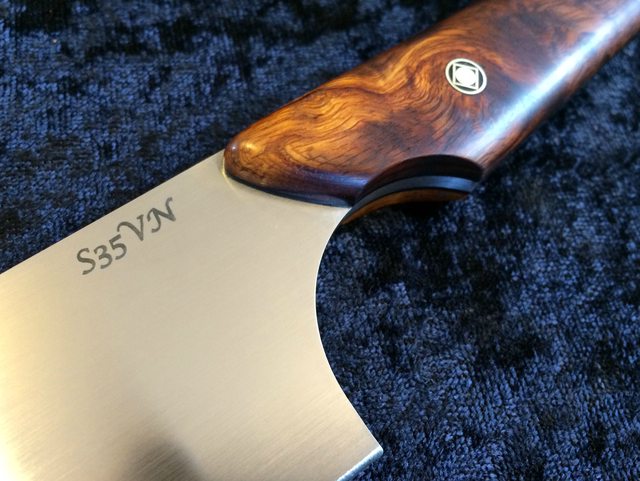

Lots of blending... can confirm. Although, after about fifty of these now, they come off the grinder much closer to final shape than they used to.

What do you mean by blending?
Despite the surface in the picture appearing completely flat, it isn't. There is in fact a plunge, it is just hidden by being shaped to the edge of the scales. There must be some contour to the surface, since for one thing the scales are not just a straight line at their terminus, and secondly if it was dead flat, the edge would get thicker towards the handle. So basically you shape everything accordingly, and then go blend by file or sanding block until it becomes effectively invisible. Keep in mind this is only for this one specific style of grind, which is a full tang, soft-plunge. Not the only way to skin the cat, certainly.
