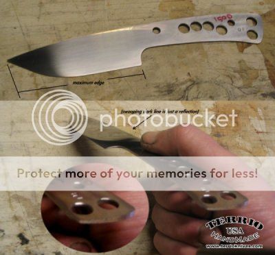

Lately I've started experimenting with no plunge at all, just a fully-axially-tapered blade and tang. It makes for a really sleek look and the maximum possible amount of useful edge.
I've seen this from a few other makers (notably, Martin Olexey) and I agree that it's sleek and very clean looking. I have yet to try it, but I'm looking forward to giving it a go as my skills progress.

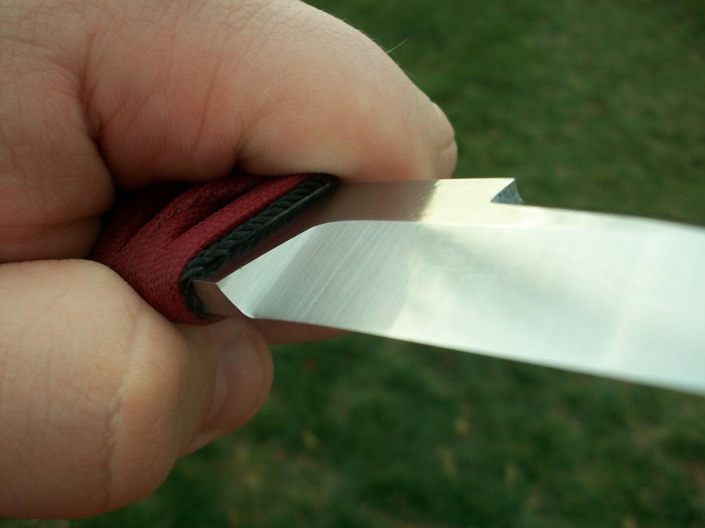

I like mine slanted and swooping just a little bit. That's how they came out when I first started and that's how I like them to look. I also like to put in a small sharpening choil that roughly matches the height of the plunge line.
I've never like hard plunge lines perpendicular to the edge just because it seems like a potential weak spot.

Chris,
Do you do that so it can be sharpened? The other option is to make the plunge higher up the blade so it doesn't interfere with sharpening the edge.
I think knives with plunges that do not take account of this possible interference with sharpening are defective.
It's not difficult. Just drill first and start grindin'. I did this one by leaving the straight edge along the bottom of the blank, so I would have a scribed centerline to follow. Then I finished grinding the profile and blended in the blade's distal taper and the bevels around the belly.
That's an interesting approach to grind the tapers before profiling. Thanks for sharing!
If you ain't cheatin', you ain't tryin' :D I leave distally-tapered tangs slightly oversize and square on the end for the same reason - a reference point. It also prevents rounding over the edges (well, actually, it allows you room to grind off any round-over... you get the idea). Then it only takes a few seconds to clean up the profile once the tapers are set.
In this case, drill a bunch of holes in the "negative" area under the handle that will be ground away, it makes the grinding go a little faster/cooler. Just leave a web with a straight edge you can scribe a line on.
Chris,
I like having a small choil to make sharpening easier. I also just like the way it looks. The placement of the plunge line doesn't affect sharpening any more than it would with a wider ricasso. I've never been a fan of the ugly ricasso/edge transition you get on a well used knife.

I also like the no plunge look, like James' blade above, but I have only done a couple knives like that so I don't have much experience with it yet.
At the end of the day, I just say do what you like and try to do it well. :)
I do mostly no-plunge knives lately. James is right... it's not too difficult on a full-tang blade with nothing but scales (or scales and bolsters)... but gets a bit trickier when you are fitting up a guard on a hidden tang. ;)
