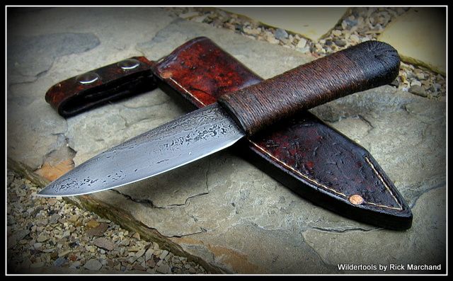

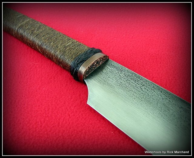

Rick Marchand, could you post a picture of a "plungeless" knife? Thanks.

Rick - what is that surface finishing called on your knives? Especially the third one where it is most pronounced, I've seen a few like that (specifically the one in the camping competition knief). Looks really cool, I'd like to search up on it! EDIT: I now see that you are the one who made that knife as well (I believe). Makes sense now.
