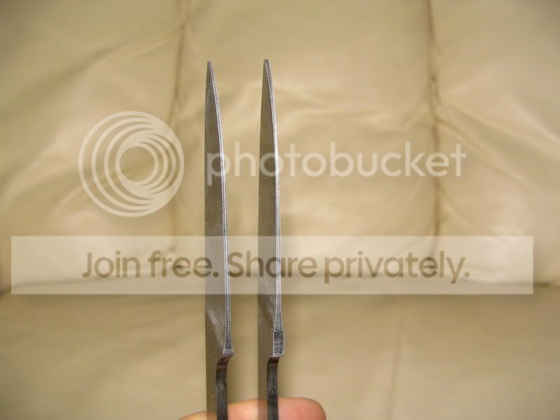

I appreciate the advice in this thread. I tried cleaning up the mistakes with a file guide and round file, but for some reason that just made things worse. I went back to the grinder and a 60 grit belt (I originally tried a 120 grit, and I think that was causing me problems) and here is what I came up with...hardly perfect, but I'm reasonably happy at this very early stage:
This is on a Craftsman 2x42 with standard platen (much wider than the belt), so I can't run the belt off the edge as I've read about doing. Hopefully when I install my ceramic platen liner things will improve.
Any advice and feedback would be appreciated, and I hope this isn't hijacking your thread Big Smitty...

You've still got a lot of room to bring those plunges in and work them out the way you want. One thing that you'll want to focus on is making the plunges deeper and having the even with the rest of the edge thickness. Leaving the thick at the base is a habit that is hard to get out of.
Also, I've never tried to file a plunge after grinding, I can see where it could make things worse.
I noticed you're using a single scribe line, if you have a double line, it may help with bringing the grinds in evenly. I know it helps me, I also know I'm at a good thickness when I meet both lines.
